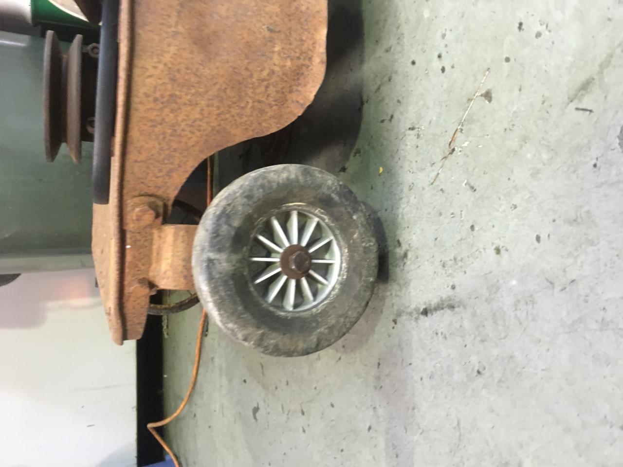

New stub axles to accept the wheels pictured above. big thanks to my work college Darren for machining these for me on his lathe.
Joined: May 2017
Posts: 42
Wheels fitted may go slightly larger diameter wheels but will see how it all sits when engine plate is fitted. Engine adapter plate is next on the list. [Linked Image]

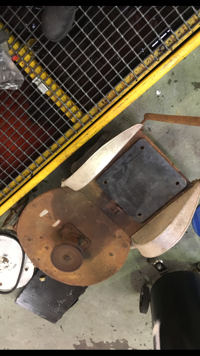

The engine adapter plate has been completed engine fits well. Now I need to find some flat steel bar to make a blade bar.
