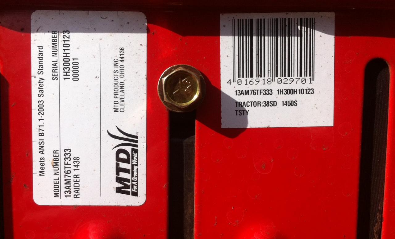

I have a customer's MTD Rover Raider 1438 ride on mower that keeps chewing the deck belts every week.
The customer has gone over to using the standard black dairy vacuum pump A section belts to save costs, but has found they shred in about 15-30 minutes when mowing 3" tall cape weed.
I ordered in a Kevlar belt from GA Spares that replaces the MTD/Kioti Daedong part number for this mower, but the tensioner doesn't apply enough pressure and causes the belt to squeal when engaged without even cutting anything.
The tensioner is basically a cable from the lever to a spring attached to the engagement arm with the idler pulley to apply the tension to the belt. When the lever is moved to the engaged position, it applies some tension but not enough to prevent it slipping.
Does anyone know if there is provision to adjust the cable at the lever and if so, do I have to take out the transmission to get to it? The easiest way would be to take the angle grinder to the battery box, but I don't want to go on that route!
I'll take some photos tomorrow and upload them to help clarify the situation.

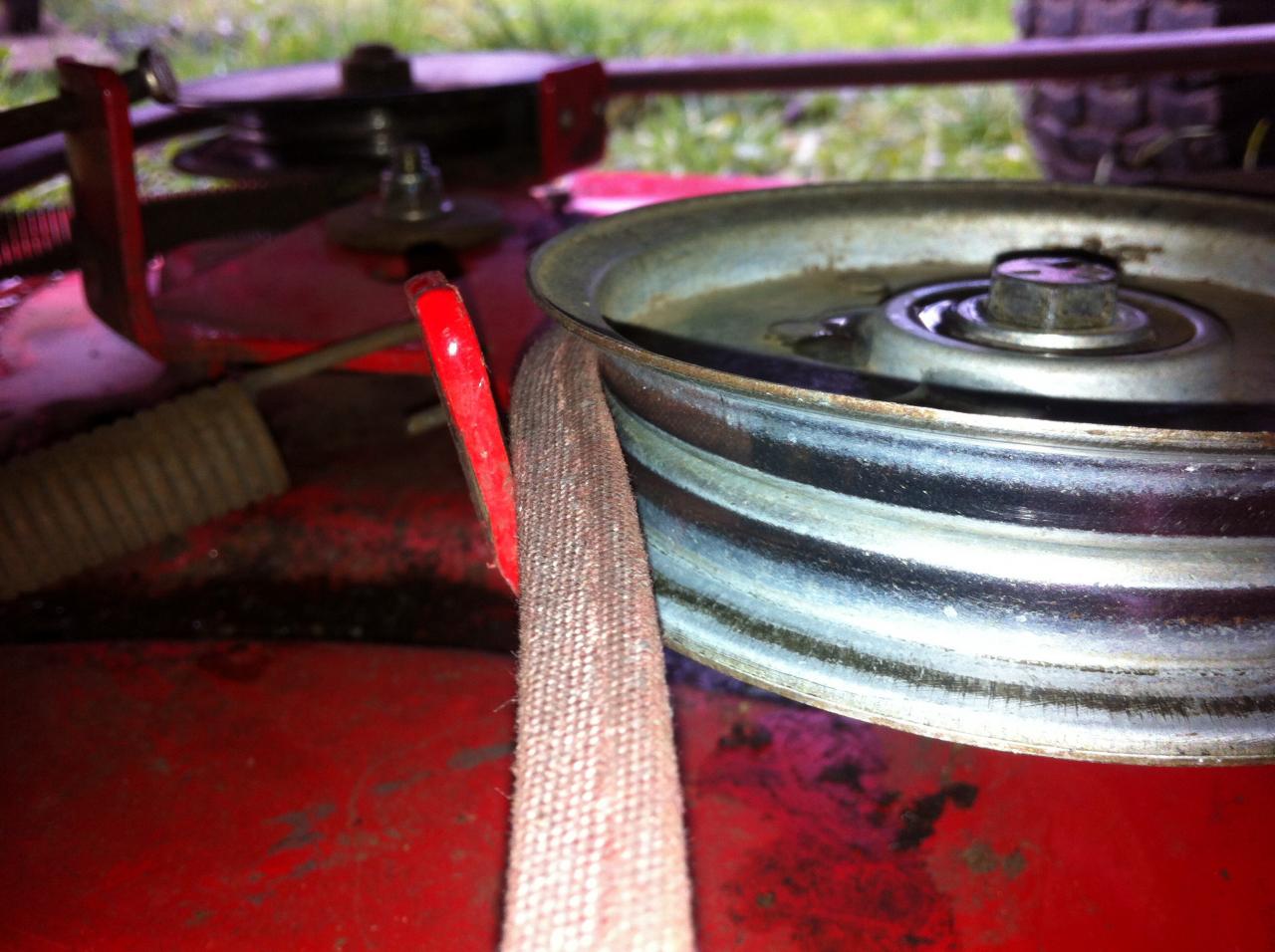

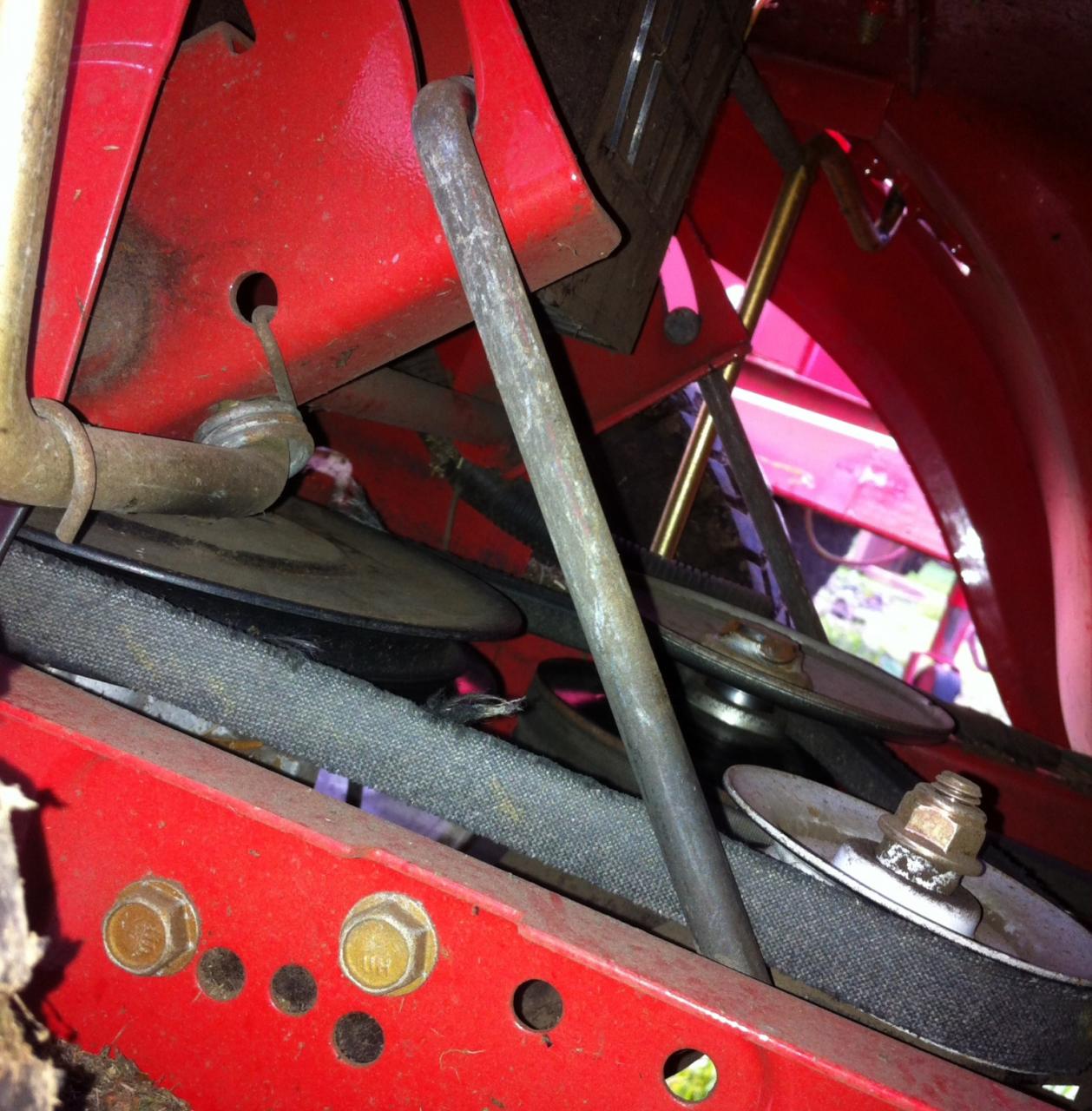

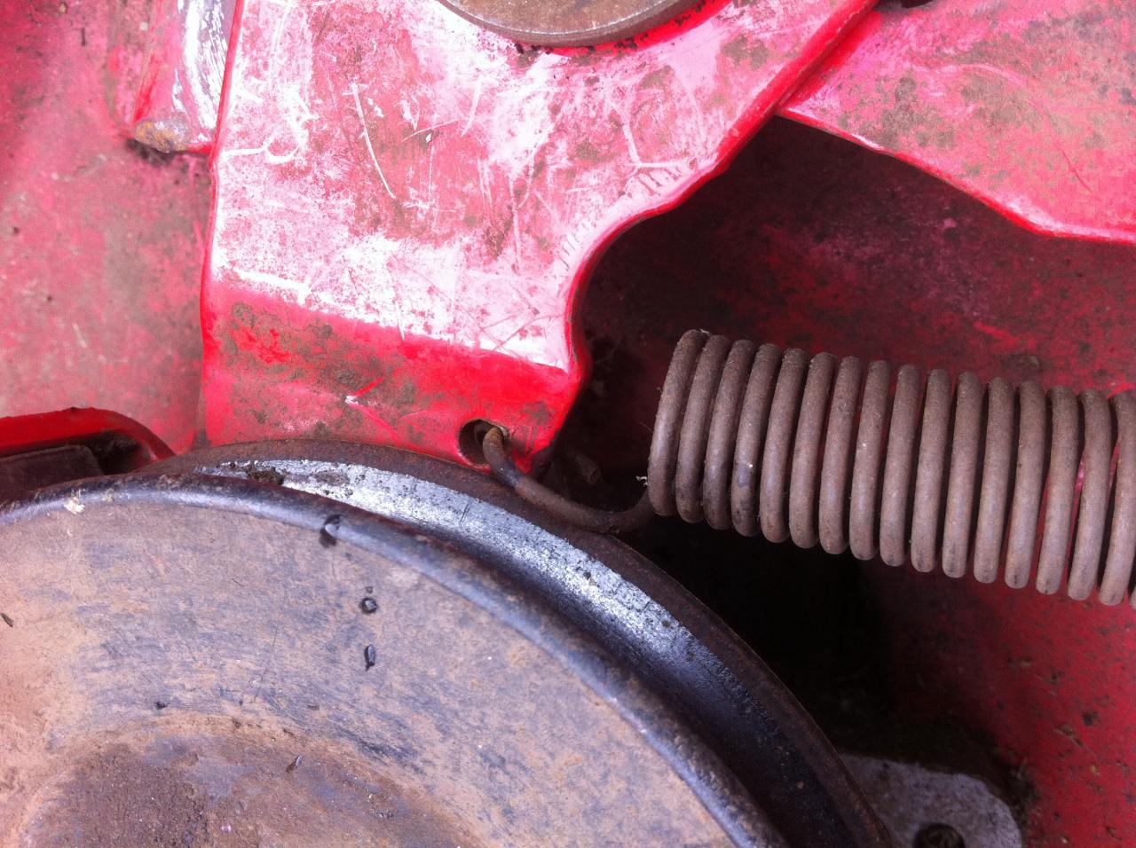

Here are the pictures:
[Linked Image] [Linked Image]
See how loose the belt is when engaged
I love the design!
The lift rod rubs on the transmission belt and the pulley is crooked�
The hole for the brake spring is too close�
The tab on the idler pulley needed bending out to stop the belt dragging�
Posts: 8,215
Yep, that is about the way they are, flimsy design and everything is so tight in there and the belts will always seem to rub on something. As for the spindles, I find it hard to believe that some numnutter designed something that is known to be going to suffer impacts over the years and yet they design the things to fail, but people still go out and buy this rubbish because it looks good in the showroom

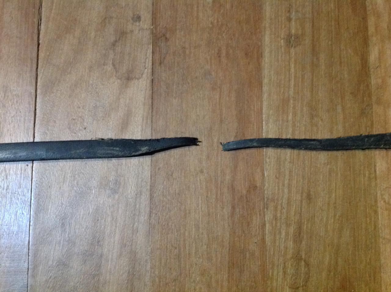

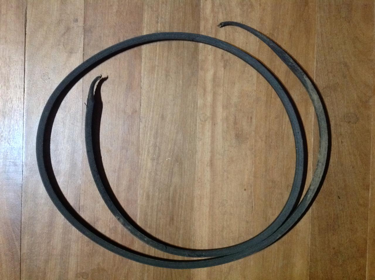

Here are a couple of pictures of the sliced belt that was on the mower when it came to me:
Notice it has been tapered on both sides.

Looks like that belt has been the victim of a seized pulley or or obstructed blade, it is worn away not sliced. The wear is on the inside indicating a vee pulley issue and not an idler pulley or guide issue.
I've found the easiest way to get belt tension improved is to order a belt one or two inches shorter than specified eg A 81 or A 82 instead of an A84 as an example.

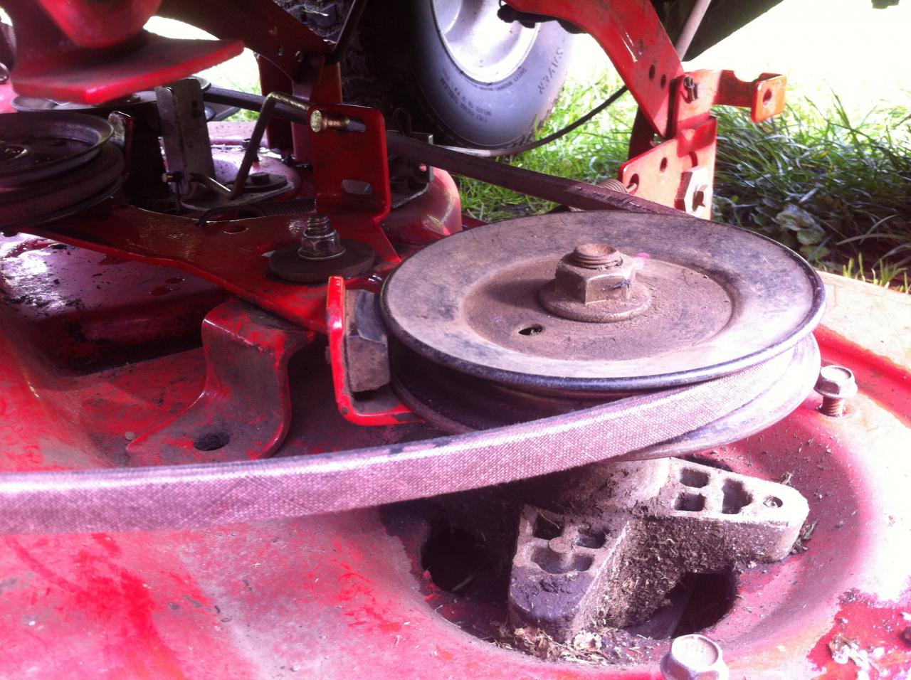

I fitted the new spindle on the mower today. It certainly reduces the vibration but the belt still sounds as though it is slipping slightly and is warm to touch when I ran it at half throttle with no load.
These pictures are taken of the belt whilst under tension. To me it looks too loose judging by the way it bulges out near each pulley.

Okay if that is under tension then you definitely have the wrong belt. Here the MTD "F" decks usually use a 1/2 x77-1/2" belt and I service one that has so wear plus a re-welded deck hanger ( not my work) that it requires a 1/2 x 77". Now I don't know what the Rover Raider as for the deck belt size but MTD tends to be picky about their belt sizes.
Be carefully of resizing the belt especially if the HP is 16.5 or less as when you engine it will shake you to pieces. I assuming the 14 in the model means it is a 14 hp. Just want it tight enough as to not slip engage but loose enough to slip when disengaged.

I have fitted a 1/2" x 77.15" Kevlar belt (K-Force B195404062) that is meant to replace the 954-04062 belt that the MTD Rover Raider owners manual specifies.
But yes, it does look too loose. Maybe I should search around for a genuine MTD belt to try out and measure up.

You might ought to measure the K-Force. Here is the reason why. My main belt supplier sells but the sizes have label differently lately. The B195404062 I currently have on the shelf from 2 years ago is labeled as 77-7/8 so looked up the belt on Sunbelt's ( A and I) belt to belt look-up and it shows them as being 77-1/2 and 77.15 with them currently listed as 77.15. I also recently fought a battle with them over a 3/8 belt that was to be 34.2" which turn out to be 33.75. So tight on the machine I can't even mount it. Even Husqvarna sent the same size belt. I had to modify the brake so the engagement pulley could loosen enough to where I get a standard 34" belt on.
Makes me nervous when a vendor starts changing sizes in mid stream. Makes me question the sizes when I have problems after installation. On top that vendor pulley sizes doing the same thing. A will work item on a MTD just don't get it. Causes me a lot extra work figuring out what went wrong.

Hi AVB,
The belt measures 77" on the outside, so is close to the 77.15" size.
Yes, it is frustrating when manufacturers change things. So far I have spent $1,000 worth of labour troubleshooting this mower that I can't pass on.
The belt tension on your mower is what I expected it should look like. Thanks for the picture.

Hi Bruce,
Thanks for the video link. It was interesting and helpful.
The video indicates that I do have the spring is in the right hole.
Many thanks.
