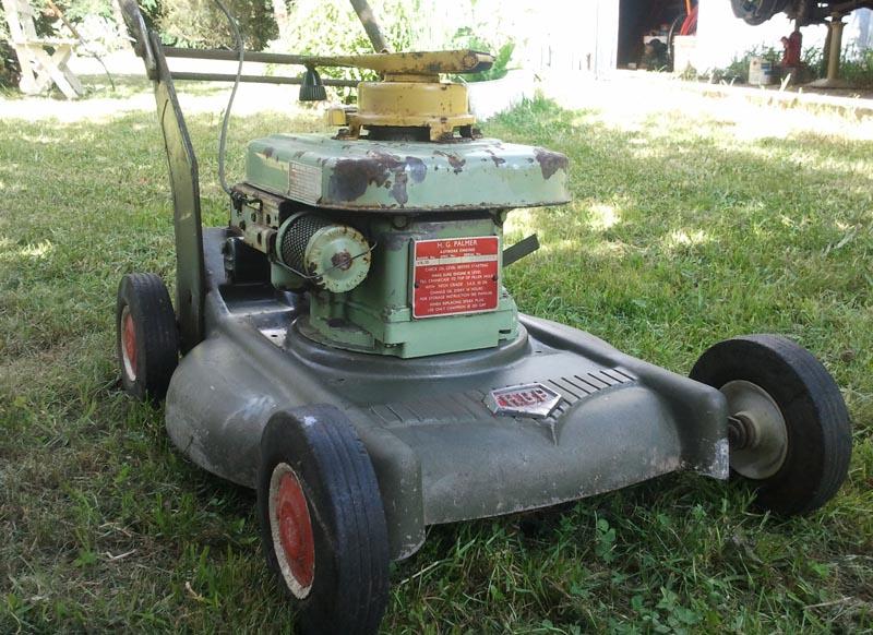

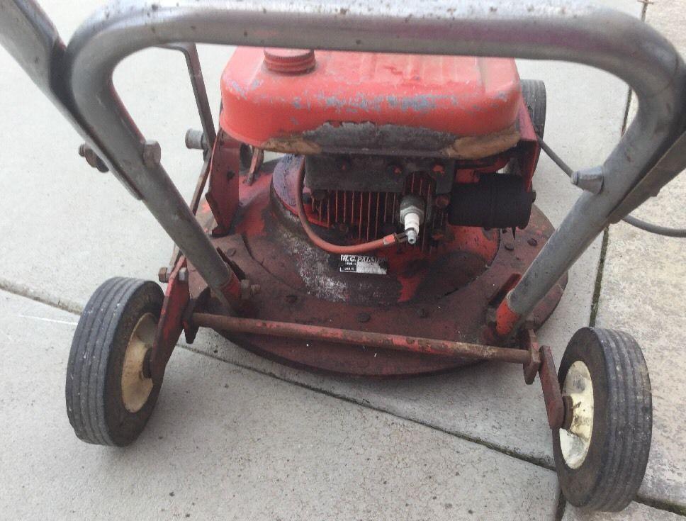

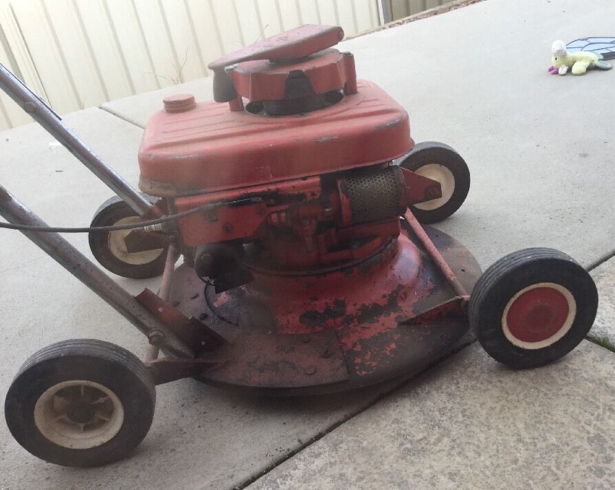

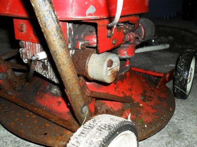

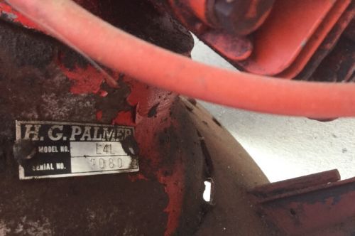

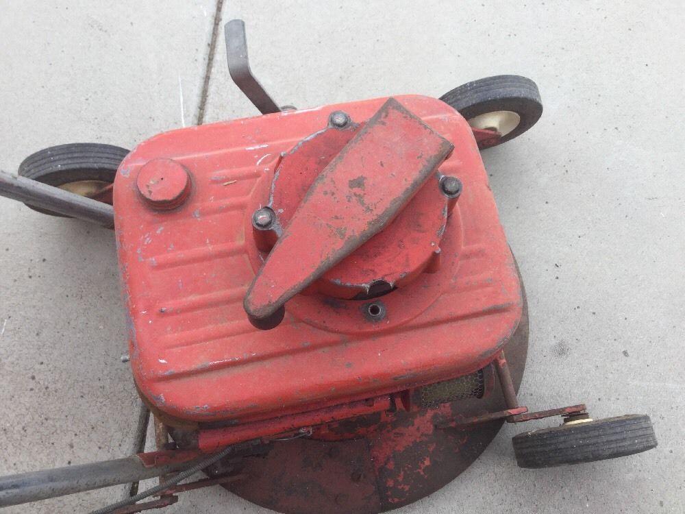

I purchased this little H.G. Palmer 4-stroke recently and wonder if anyone can identify the model for me and provide a possible year of production? (The label says "L4L"). I am guessing the red paint must be original. I'm not sure about the engine type as I haven't actually taken possession of it yet. Looks like a Victa, Villiers, or perhaps Kirby engine?? Wheels look like stock standard Victa wheels from the era. I note that the winder looks original and is identical to the ones on Southern Cross KXD mowers (perhaps made by Kirby?).
A manual would be handy. If anybody can supply one as a PDF or photocopy I would be very grateful.

Hello vint-mow
I feel I can give you a rough year of production.
This utility base was Palmer's first base but they used about
half-a-dozen engines over its life span - from about 1960-64.
The only ads I have that date this model come from 1964.
I'm guessing that 'L4L' stands for Lawnmower-4-stroke-Kirby-Lauson

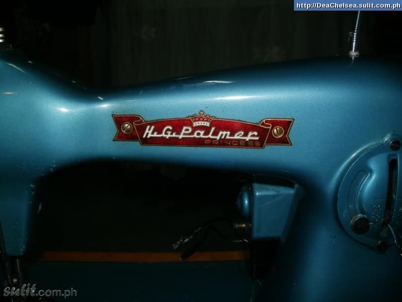

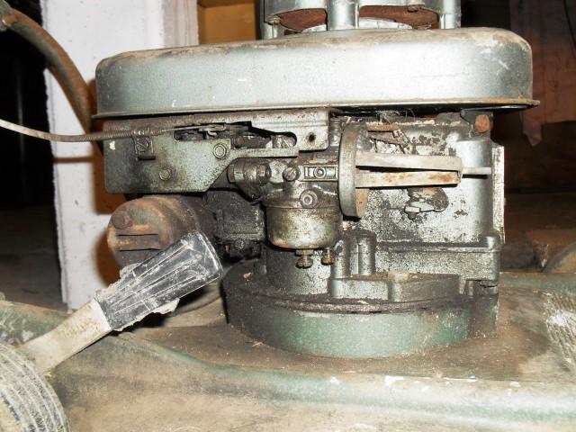

These images from ODK show the decal and badge:-

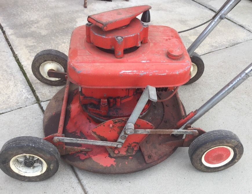

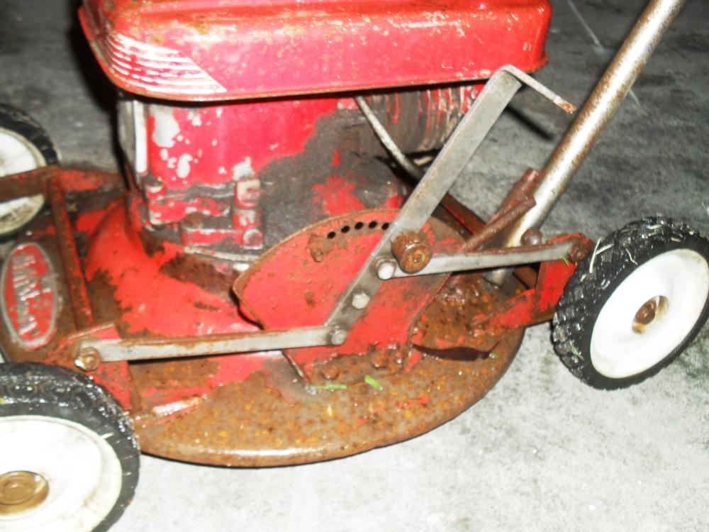

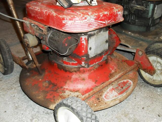

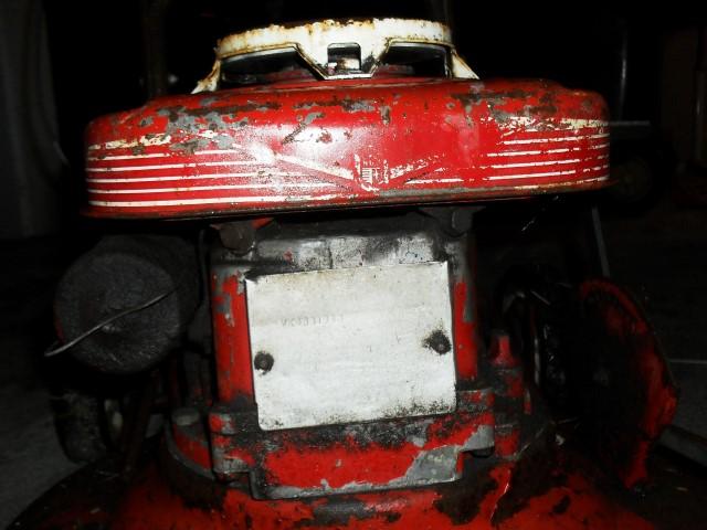

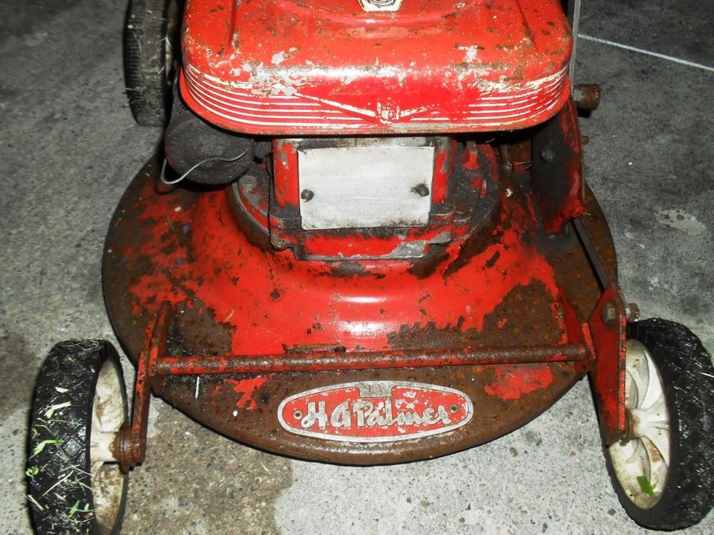

heres a comparison of the victa and hg side by side same engine.
and this shows it when i got it running.

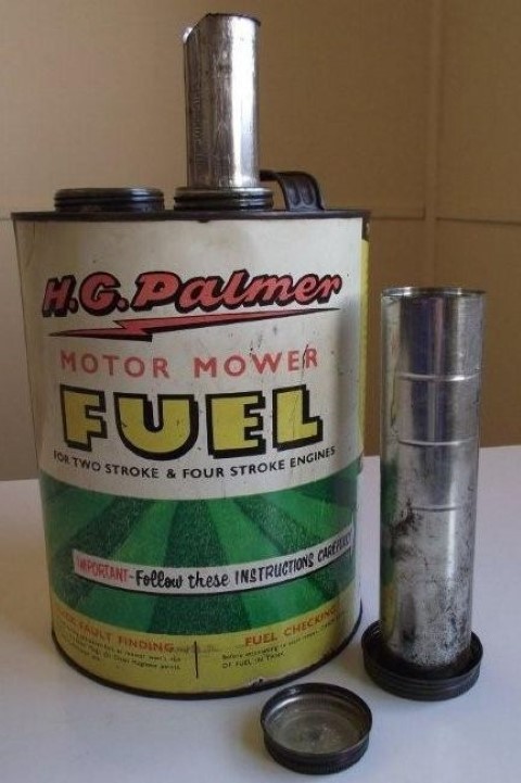

Many thanks for the excellent details Jack and Gizmo. The badge is missing off the front of mine so if anyone can help with an original or repro badge, please let me know.

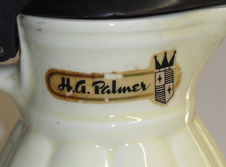

Is that a logo or coat of arms in white paint on the front of the fuel tank?
Incidentally, I have that same fuel tin! smile
Likes: 8
it is the hg palmer logo. lots missing but you can see the crown theme .

I note that Gizmo's mower has the new Tecumseh recoil.
These would be used extensively on Kirby-Tecumseh and Tecumseh engines.
This conforms with the 1964 advertisement.
Impulse (wind-up) starters would remain the main starter in the 1960s.

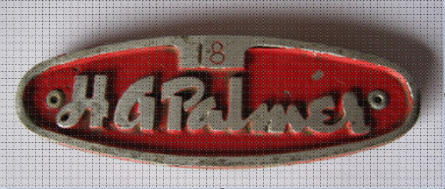

Wondering if someone can please tell me the dimensions of the H. G. Palmer badge that goes on the front of these mowers? The only measurement I know for sure is the length between the mounting holes, 'coz that's all mine has got. lol!
I've been in touch with people who do repros of vintage mower badges, but as far as I can tell nobody is reproducing H. G. Palmer badges or decals. The badges are about as rare as hen's teeth. But if anyone has such a hen and does not mind pulling its teeth for me, I would be very grateful. grin
Likes: 312
Hello vint-mow
These badges do come up for auction from time-to-time.
I have added a grid to a badge image.
I think you should be able to calculate dimensions from it ...
