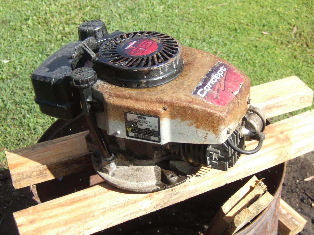

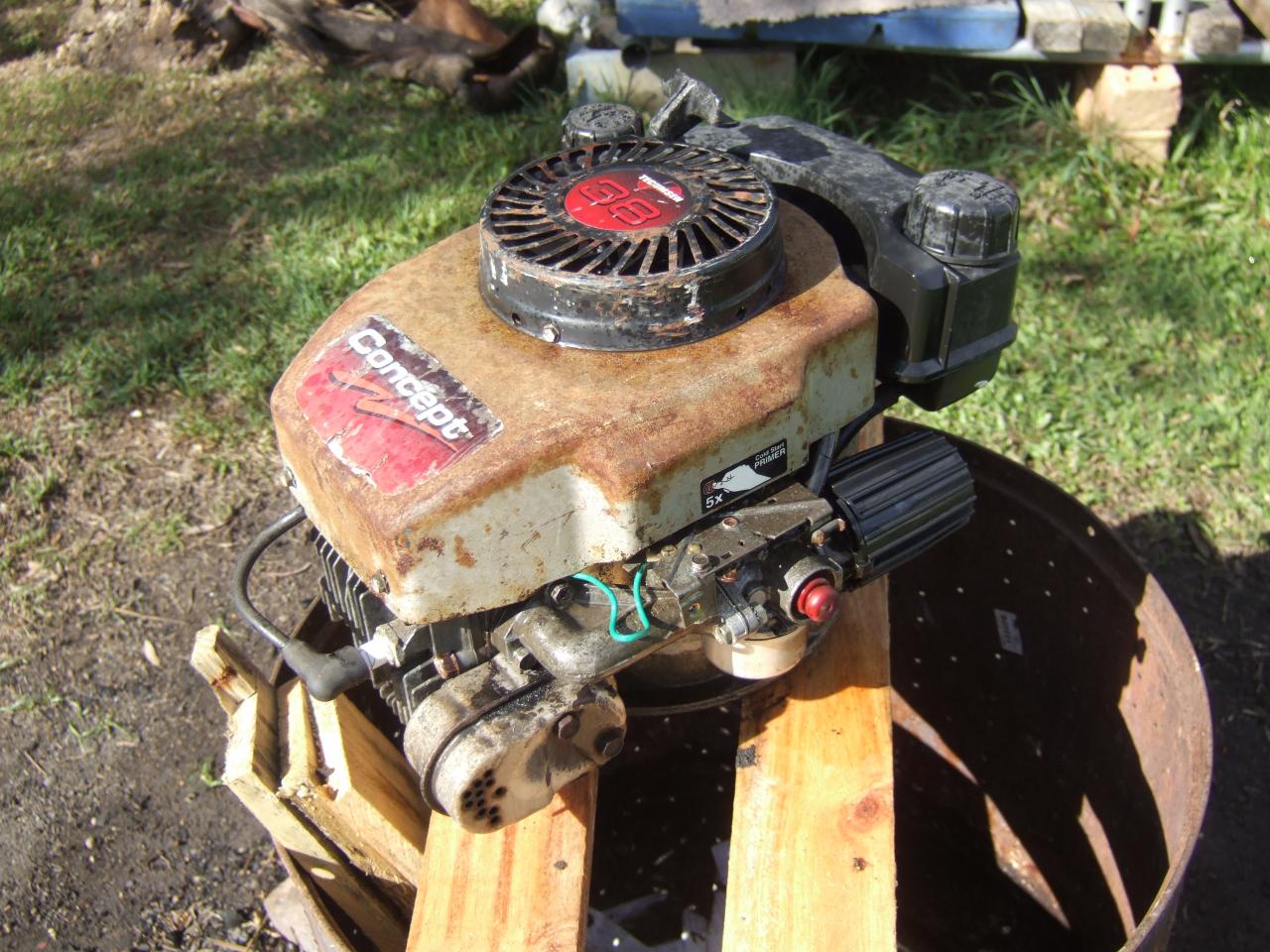

I just got given a Tecumseh motor off a Victa Concept.
Ther guy didn't know if itruns or not. It has low comptession , good spark, and was missing a valve cover bolt, that's why it's dirty i guess.
I wanted to bench test it before I cut up and old Victa 160 high arch to fit it as I don't have another base.
Just wondering if I need a load on the engine, like a blade disk...i would somehow bolt it to some wood.

speedy #86907 09/07/17 05:02 AM
Posts: 1,233
Likes: 32
I put the motor on a massport base. Just to test the motor.
Pulled it many times with raw fuel in plug hole.... no luck
Cleaned out the jelly out of the carb bowl, and started with my bosch electric drill special starter......
It started and ran ok, but only at idle... I need to adjust the screw on bottom of the bowl, so i am hoping i can adjust that to bring revs up, or check points.
But pleased to get rip van winkle started after a long sleep......................
then I'll need another base a s this massport one is meant for a long shaft motor......
all good, things take time and it's all learning on every project.
