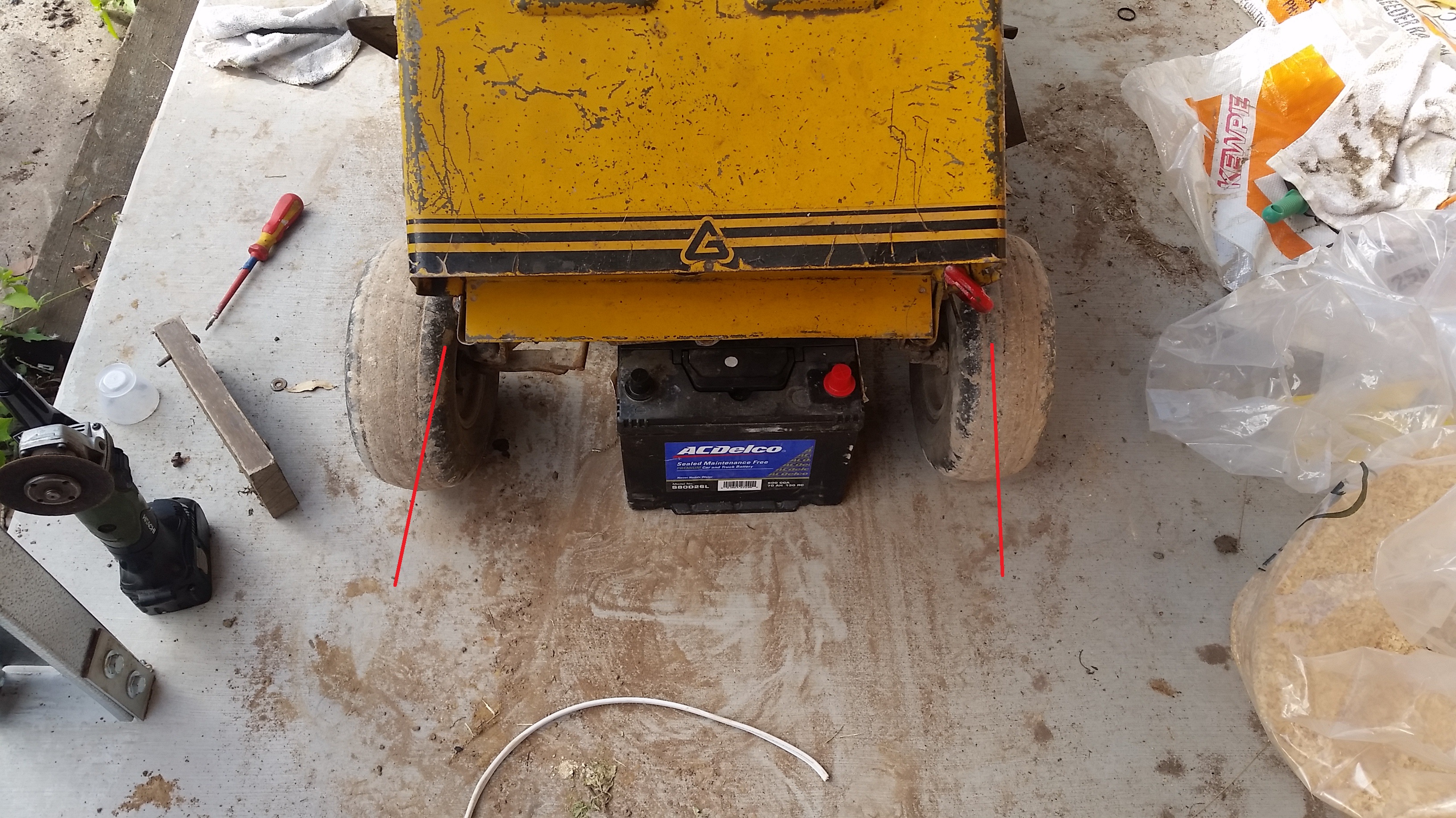

So today's efforts totaled; an engine cleanse (Nulon type) and fresh oil, a quick carby clean (just with spray type cleaner) it was FILTHY, lubricating any pivots and some fresh fuel and I got to doing my first bit of mowing! Started first pull and cut great, even for an old set of blades (I'm not going for bowling green, just improve my chances of spotting snakes).
Few things I found that need some attention, but nothing stopping me getting on and riding. Not sure what the forum convention is, but I thought I'd ask in this thread.
First question, alignment, when the wheel on the right is facing forward, the one on the left is facing out. I couldn't see an obvious way to adjust this alignment?

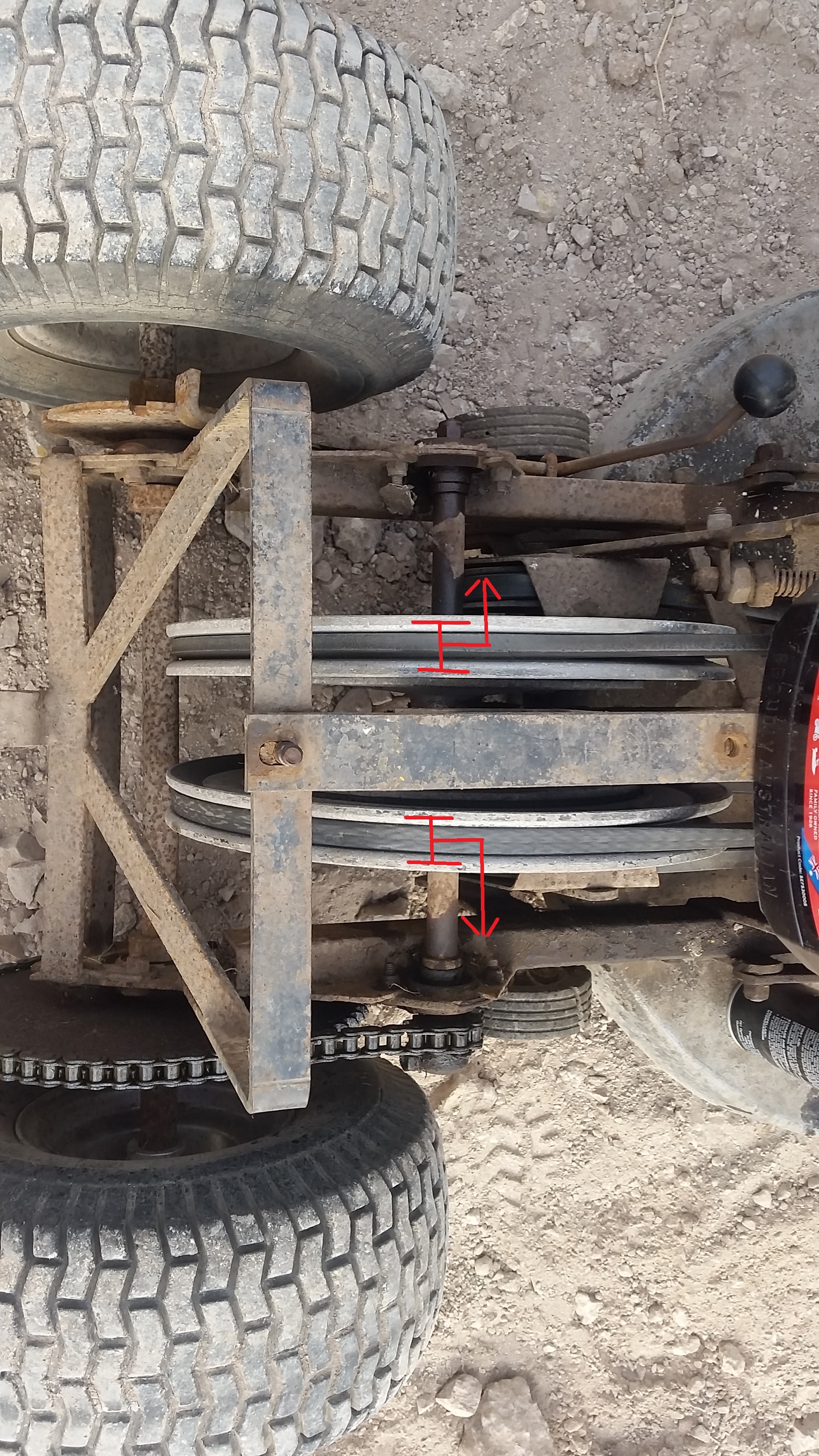

As mentioned above, there is some drive issues. From what I can see when the pedal is pressed and the bit in the middle moves left or right depending on the direction, and the plate is pushed against the pulley, the whole pulley (worse in forwards which i think would be the pulley on the bottom of the picture) slides on the bearing. You can then push the pulley back and forth on the bearing...
I'm guessing that isn't meant to happen. The plates had good amount of material (cork?) on them, maybe 3-4mm?

Play and wear in the steering is a bit of a perennial one. Wear in the steering tie bar and the bushes therein etc. Give the steering wheel a wriggle to and fro and you'll soon see where the play is. When I finally got round to dealing with mine I made a new tie bar and made new bushes and that solved that. I took the opportunity when I made the new bar to create a modification so it has adjustable stops. I'll take photos of it and post them later.
Also, in the photo wheels seem to 'lean' ? Worn and missing king pin bushes or collapsed wheel bearings can be a thing.
Unfortunately the bearings in the drive pulleys do come loose sometimes but first confirm that the bearings are actually sliding in the pulley and that your not just looking at wear in the bearing which can give quite a bit of wobble at the outer diameter of the pulley (which is 'normal' up to a point)
If the bearings are physically sliding in the pulley then something will need to be done, I'm afraid. The 'something' will depend on how badly the pullies are worn in the bearing bore.
Also, looking at the photo above, the belt in the top pulley has rolled over? If this starts to happen it's time for a new belt and it's a good chance it is contributing to your issues. Also need to check that the belt tensioner is doing its job.

I need to further investigate the steering issue, it drives fine, but you can see it is off a fair bit. I'd be interested to see what your solution looks like Cheers.
Definitely not a 'wobble', the whole pulley is evenly sliding back and forth on the bearing (eg. the amount of bearing showing at the top is the same at the bottom), i should have taken a photo, however I'd just emptied the entire contents of the engine onto my workshop floor... that's a story for another time hahah.
The belt is flipped, I thought for a second they were different belts! I've got a 'spare new' one, but it looks rather second hand, I'll see if the profile and length are better. As for the tensioner, I assume that is up under the steering wheel?

Drive pulley bearing thing is a pest. Almost certainly the pulley will be worn beyond redemption where the bearing sits. I have 'saved' a couple in he past that were only slightly worn with good ol' loctite as I didn't have any spares at the time.
This depends on the correct size being available, but there is an item called a 'speedi-sleeve', which is intended for repair of worn areas on shafts - where seal lips ride. http://www.skf.com/au/products/seal...ear-sleeves/skf-speedi-sleeve/index.html
Much used in industry, and even the automotive field.
They can also be used to repair bearing seats, as in that pulley, by gluing them in place with a good quality metal-filled 2-part epoxy resin, e.g. JB Weld or Devcon.
Available through bearing supplies joints. Not particularly cheap, but they do work very well.

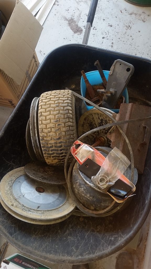

I've got a few pulleys in that wheelbarrow of parts, some look the wrong size, and some have bearings rusted in them, might see if they can be salvaged.
Just make sure you're sitting down, when you go to price that Belzona 1111! Smallest available pack size is 1kg, too.
Only an option if you have a maintenance fitter contact in industry who can scrounge some for you, really.
The Devcon 'plastic steel' range of epoxies are better value for money, and small tube packs are available from Repco branches.
