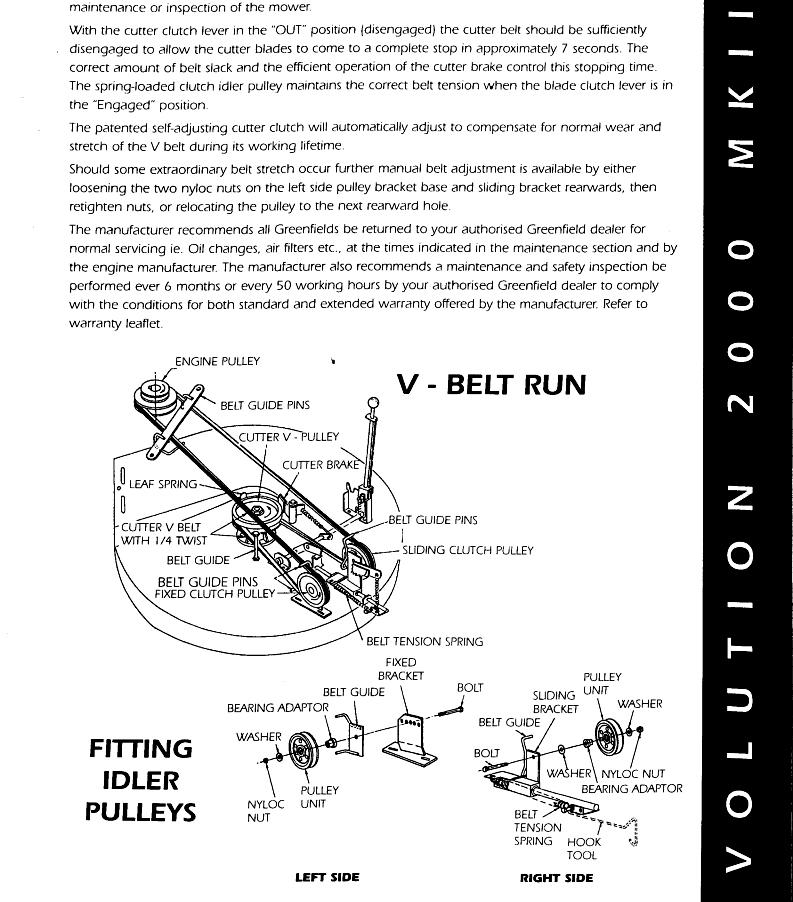

Not sure if you have a manual for the old girl, so I will post the instructions and diagram of the cutter belt run, also according to my manual the belt No: is GT 18005.
Edit: If the cutter belt has been re-tensioned before, you can loosen it by reversing the tensioning instructions in the second picture.

I would not think just fitting a new belt would cause the problem if it was working fine before hand.
Hi Norm
In my experience, not necessarily. blush
Fitting a new belt - and re-tensioning - may isolate a bearing ready to fail.
Over-tensioning of the belt may exacerbate the problem.
Many thanks to Buckets for the great illustrations.
Kahuna, please let us know what you find.
