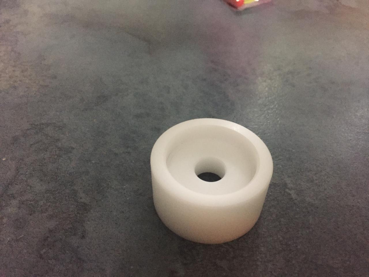

Just had a ring around trying to source some suitable material (extra heavy 32nb pipe or 40mm x 30mm hollow bar) so that I could look at machining some sleeves. I would need to sell many sets just to cover the material cost (offcut, minimum invoice amount) on the cheapest price I was quoted,just not viable for me.
I originally purchased a couple of 6202 bearings with 5/8" bores, they didn't fit(too small a bore to fit on the roller shaft).I would have measured the Anthony bearing with a vernier and considering od and width appeared imperial I wrongly assumed an imperial bore. Measured accurately with micrometers the od is more than 1.5 inches and the id is awful close to 16mm.

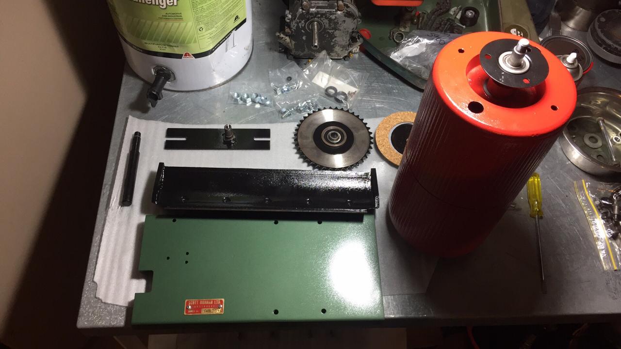

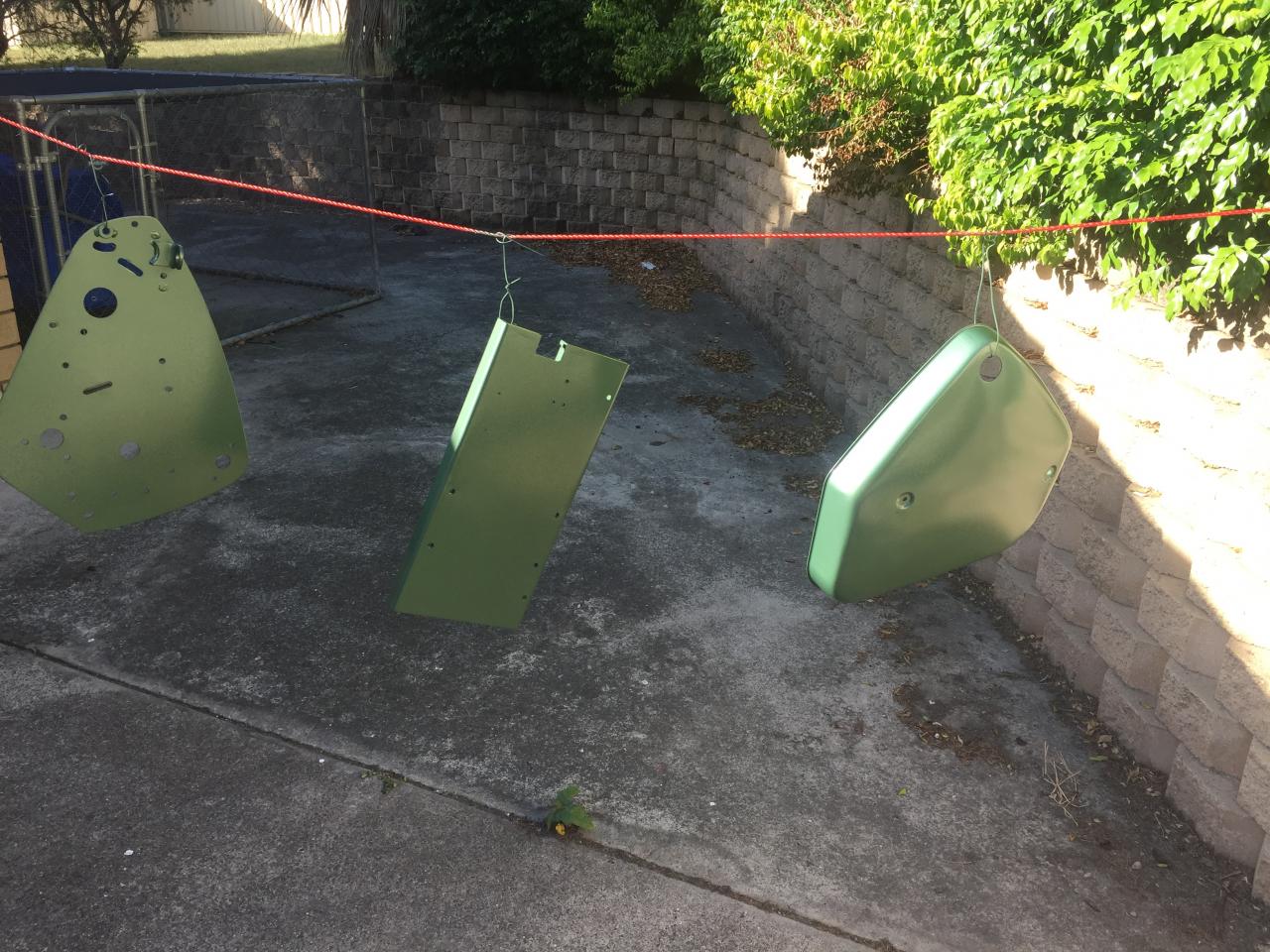

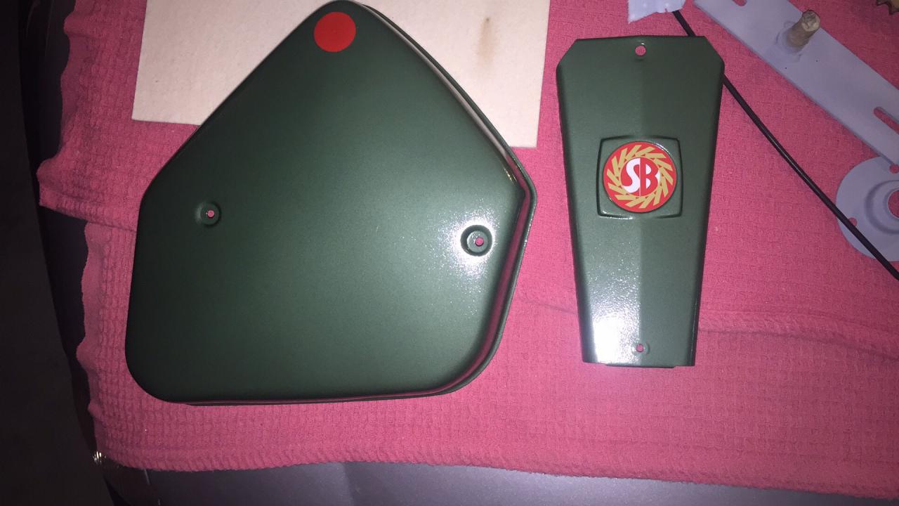

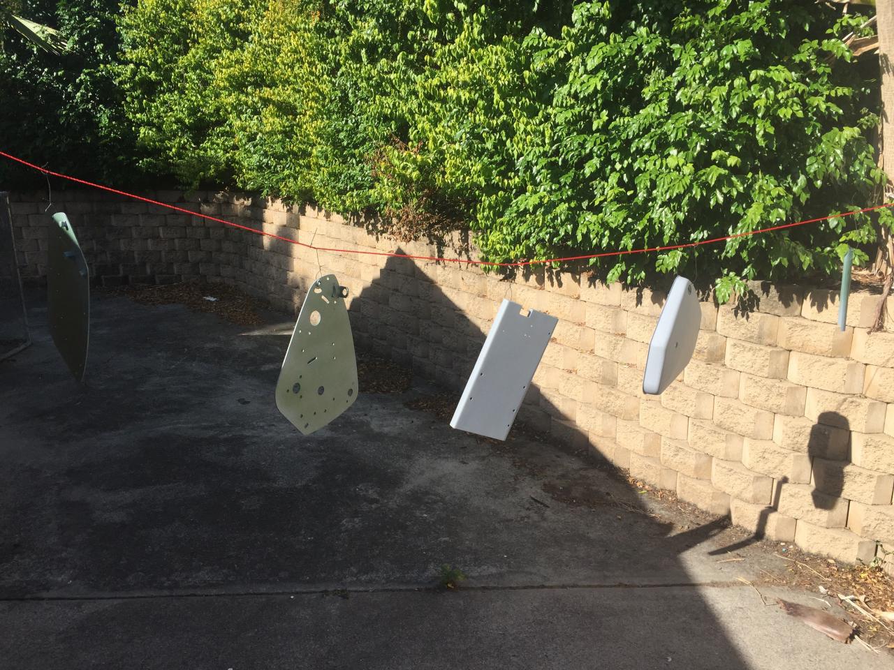

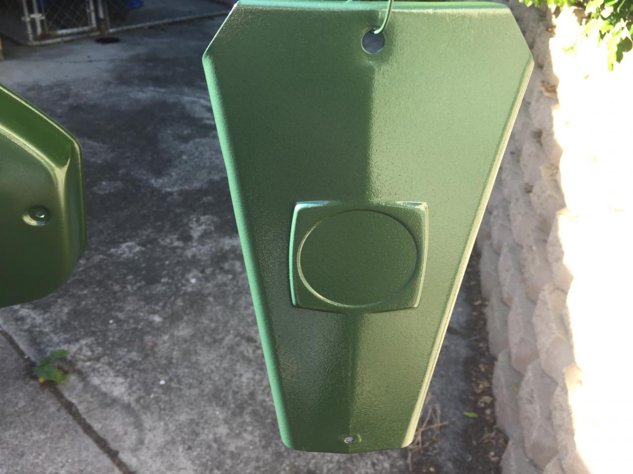

Hi guys how have you been I removed the outer metal cover on the rear roller bearings cleaned and repack with wheel bearing grease, here is a sneak peak of some of the work that has been going on at my house ![[Linked Image]](https://www.outdoorking-forum.com.au/forum/uploads/usergals/2017/02/full-5156-33169-full_11026_33159_img_5721.jpg) ![[Linked Image]](https://www.outdoorking-forum.com.au/forum/uploads/usergals/2017/02/full-11026-33160-img_5722.jpg) ![[Linked Image]](https://www.outdoorking-forum.com.au/forum/uploads/usergals/2017/02/full-11026-33163-img_5724.jpg) Hope you fellas like it ?
Posts: 2,998 Likes: 16
HI CP,
I really like the colour in the last shot, it's amazing how colour temperature can change the colours in photography.
In actual fact if that photo is correct it's so close to original it's not funny. Did you by any chance get the formula for it or is it on a sticker on the can. Also how much paint did you have mixed up ?
Now for the bad bit,
Sadly I don't like being the bearer of bad news but it seems you've put the SB decal on upside down on the handlebar shield.
With heavy heart, BB.

Hi Bb Thanks for the bad news on the decal I have fix it thanks for pointing it out lol. The photo is the actual colour and I am very happy with the way it turned out . Sorry but there is no paint code I can give it was just colour matched from behind the chain case . Queensland paint supplies at Salisbury in qld mixed it up it started out as there green hammer tone of the shelf and one of the guys there tinted it to get it as close as possible 😃😃 ![[Linked Image]](https://www.outdoorking-forum.com.au/forum/uploads/usergals/2017/02/full-11026-33224-img_5727.jpg) Some more parts painted and the cork is just sitting there it is getting ready to be glued on to the right side of the gear so it is going on that one lol what is a good glue to use??? Thanks for your time

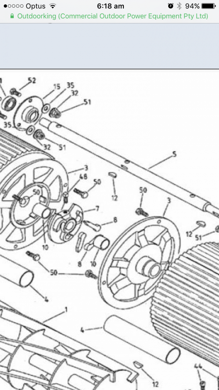

Hi all how are you ![[Linked Image]](https://www.outdoorking-forum.com.au/forum/uploads/usergals/2017/03/full-11026-33252-img_5760.png) Is there a measurement for item #7 on how far it sits on the shaft or as long as it's sits over the woodruff key it's good to go
Hi CP,
Yes iten 7 (pawl carrier assembly) must sit perfectly central over the woodruff key and then you lock it down with the set screw #48
Cheers, BB.

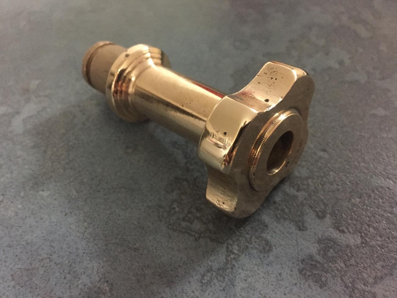

Hi all Been busy here doing bits and pieces while the weather is no good here in Brisbane for painting. Also found a brass height adjustment knob that I have been sanding and polishing to try make it shine ![[Linked Image]](https://www.outdoorking-forum.com.au/forum/uploads/usergals/2017/03/full-11026-33606-img_6046.jpg) ![[Linked Image]](https://www.outdoorking-forum.com.au/forum/uploads/usergals/2017/03/full-11026-33607-img_6047.jpg) And all so knock up another chain tensioner let me know if any one would be interested in purchasing one I will be selling them to fund my hobbies lol
Hi CP,
Those early series 1 Height adjusters look good polished up but they really need to be lacquered so as to stop the oxidisation that will naturally occur.
I noticed that the tensioner that you made for me had a thread tapped into it, did you do this deliberately or are you going to make future ones without so they just slide over the stub and are locked on by the 3/4 nut ?
Cheers, BB.
Joined: Jan 2017
Posts: 52
Hi Bb
Yes I was thinking of clear coating the adjuster
The chain tensioner I made for you I just screw over my thread arm but will be tapping them out to run the same as the O/E tensioner

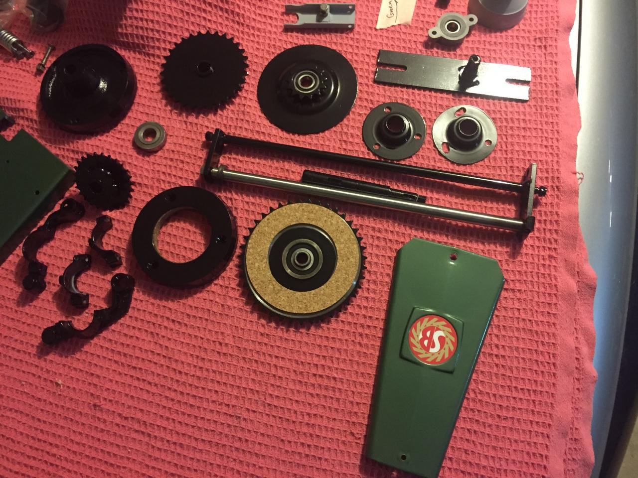

Hi all Here's some pics it's been a while I have been busy with work and don't want to rush hope you like the progress ![[Linked Image]](https://www.outdoorking-forum.com.au/forum/uploads/usergals/2017/04/full-11026-33729-img_6080.jpg) ![[Linked Image]](https://www.outdoorking-forum.com.au/forum/uploads/usergals/2017/04/full-11026-33730-img_6100.jpg) ![[Linked Image]](https://www.outdoorking-forum.com.au/forum/uploads/usergals/2017/04/full-11026-33731-img_6071.jpg)
Hi CP,
Love the progress.
One major point to make here, I note that you've just bought a Bed Knife straight from an online outlet and it is still a blank.
This must be ground along with your reel so as to match. You'd be surprised how out of whack that blade will be just being attached to the Sole Plate alone.
The sole plates are never perfect and as such the blade will follow the sole plate.
BTW I love the roller in Red opposed to being light Grey.
Cheers, BB.

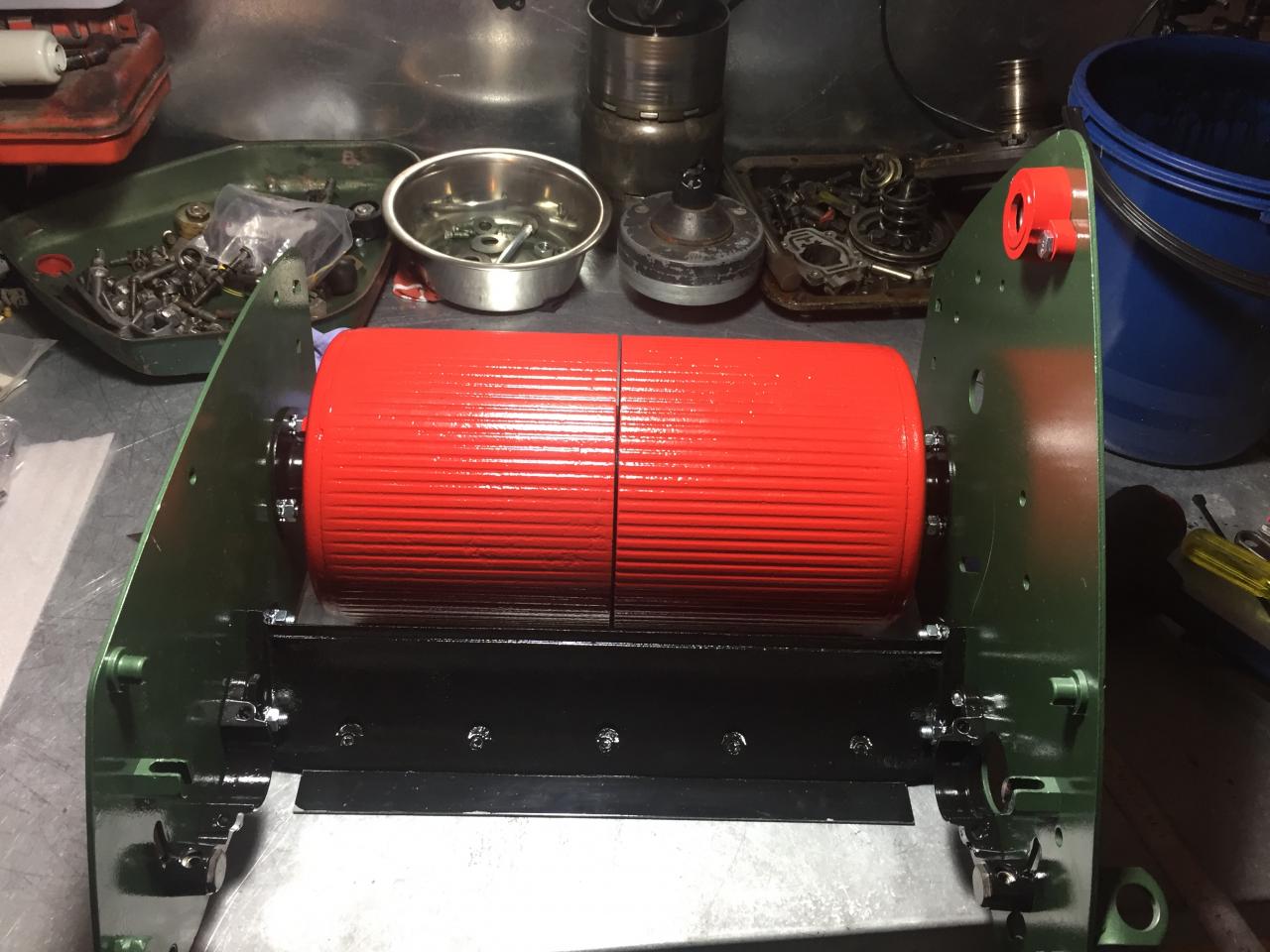

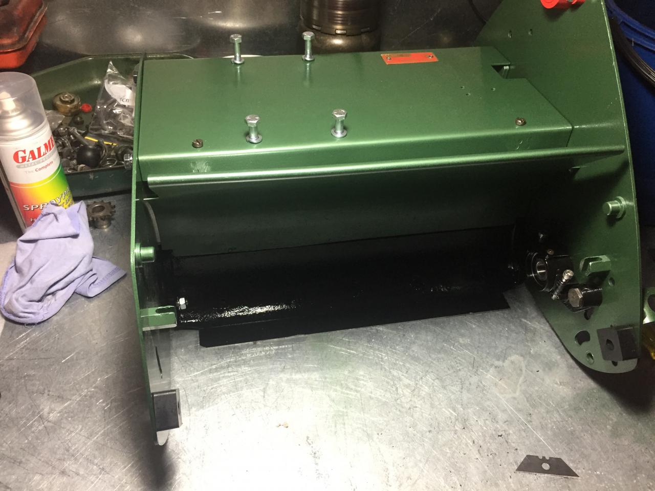

Now where to start bolting it all up need help with the right steps to proceed with the build
Hi CP, Basically you start with the sole plate first and then the rear roller ensuring that the slotted side bearing carrier is fitted on the RHS if looking from the rear, after that fit the land roll clutch drive in its two sections with the outer pressure plate last, this way you can fit the chain to drive the roller. There are specific rear roller fitting and alignment instructions in the following thread. https://www.outdoorking-forum.com.au/forum/u...Rear_Drum_Assy_-_Bearing_.html#Post77975From there you can loosely fit the reel bearing carriers and slide the reel in to place ready for final adjustment. Assemble the transfer shaft and its bearing / carrier and attach it at the top of the side plate and also assemble the primary clutch assembly into its frame on the top engine deck. Loop up all the chains and slowly adjust it all up as it should be. I guess from there onwards its all been covered on here again and again but if you get into any strife don't hesitate to holler ! Cheers, BB.

Hi again all ![[Linked Image]](https://www.outdoorking-forum.com.au/forum/uploads/usergals/2017/04/full-11026-33955-img_6215.jpg) ![[Linked Image]](https://www.outdoorking-forum.com.au/forum/uploads/usergals/2017/04/full-11026-33956-img_6204.jpg) Just an update shot and also made the lock bolt for the clutch housing hope you like it
Posts: 6,938 Likes: 322
Hello Crumpet, BB, and all followers
Amazing documentation there. I particularly love the first image (above). Brilliant!
Clearly, this post will be moved at some point. I feel we have moved beyond introductions here.
Many thanks for this great restoration record.
