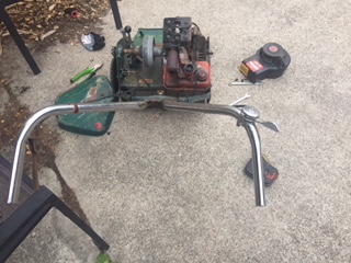

Hi all picked up this old girl can you help me to identify it im having trouble up loading pics

IM trying to also track down decals and what colours should the frame and motor be
Thanks for your time
Joined: Nov 2007
Posts: 93

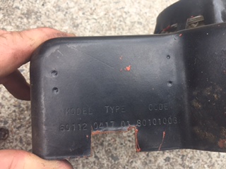

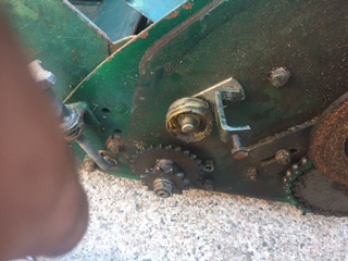

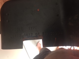

You can get decals from a chap who sells on ebay. Motor is October 1980 manufacture. Mower is a sb 45. There should be a plate on the mower frame , can you get a photo of it. It should say sb 45 and then another series of numbers. Others will correct me if I'm incorrect on my observations. I'm not an expert on sprocket evaluation but one of them appears worn.

Brass tag has 45 31716 on it

What is the right stickers for the year model tho
Hello Crumpet
I understand your desire to get the decals right.
This is a solid deck 14".
The earliest brochure I have for the 45 seems to have been
rushed - in that there is no chain-case decal shown. However,
the second brochure (below) depicts what it should be.
These decals are available from Silensmessor on eBay.

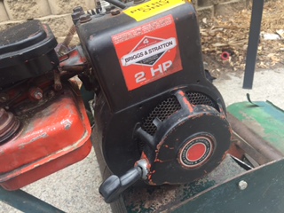

So the engine is not the original to this scotty
Hello Crumpet
It's best you acknowledge responses before re-posting.
Yes, this engine cannot be original.
Solid deck 14" machines were powered by smaller silver-coloured engines...

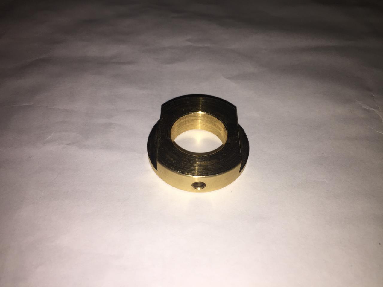

I will fit the cast iron body one up with the brass thrust that I have just fabricated up.

Hi CP,
Love that brass thrust pad, mass produce them and you can start a business up with them. Honestly how much do you think you can make them for ?

Hi BB
Thanks it was not to bad to knock up the thrust I had taken me about 30 min. Not sure how much I could make them for just found some scrap at work and started making it
you think there's a market for it.

here is a pic of the chain tensioner i made up too.
I need to remove a link out of the chain aswell
Hi CP,
That's a great replacement you've made there as the series one tensioner hasn't been available for years. I have to ask the question though, why do you need to remove a link from the chain ?

Did thay roll tho or did they sit stationary and the chain just wear in one spot until next service
I dont really but to allow for chain cover clearance it is a new chain and I might have missed counter the number of links

The originals were just bolted stationary and as you suggested and rotated at service time.
I must admit if I could find some round ones I would fit them onto my series one machines opposed to modifying the series two units to fit.
OK I wasn't aware that you've changed chains, thus that explains it.
