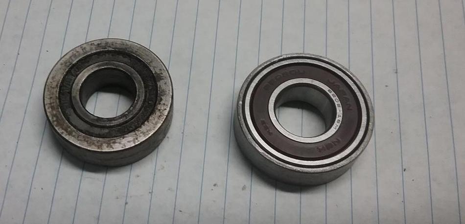

This is what I do in regards the rear roller bearing, I do not believe there is a standard bearing available (metric bore, imperial outside diameter). I buy good quality sealed 6202 bearings with a 16mm bore (6202 are available in 15mm,16mm and 5/8" bores), I machine a steel sleeve with the correct od and lightly press/loctite it on to the bearing.
It then fits straight in to the standard pressed housings, the rear roller spins really nicely.

I contacted Anthony Innovations (Anthony Bearings) a few years ago regarding the rear roller bearings and the clutch thrust bearing. Both bearings were listed on their website (clutch bearing is a "castor/trolley wheel bearing" !), neither are stock items and I was told they were made to order with a minimum run of 500. I would imagine they may do smaller runs for regular clients.
I considered having some sleeves cnc machined and offering my modified bearing as a alternative but I don't believe it would be viable, I don't think the demand is that high !

The bearing OD is 1.503", the ID is 16mm, the width is 7/16". Good luck finding one of those . 6202 is slightly narrower(thickness of one piece of paper)at 11mm wide.

Many thanks for helping members out on this, and the great image of
the different approaches - original and work-around.

When I am in the mood I rebuild model 45s to sell. The only way I could make a few bucks and still do a good rebuild is by doing things like modifying bearings for the rear roller, I make my own catchers from scratch as pictured,front roller shaft I cut in half and weld it up with unworn sections on the outside. Good condition 5/8" grubscrew style clutch housings with a worn bore I machine to 3/4", if the big sprocket on the cutter sprocket is knackered I cut it off and replace it, I machine/grind the cylinders, repair worn clutch output shafts and clutch cones.After all this my hourly rate goes up to $7.50 !. I bought ten new B&S engines a few years ago for a good price, I have three left and after reading this I think I will retire when they're gone !

Now looking at those two bearings laying there side by side I think that you'll find that the races both inner and outer on the original are stronger than most standard bearings and that would've been done purely for shock resistance with the rear rollers having to traverse up and over concrete edges during their lifespan.
How do you feel that sounds ?

As far as determining the durabilty of my modified bearing compared to the original I am way out of my depth there. When I initially looked in to doing it I spoke to the bearing supplier about using the bearing, I described where it was being used and the weight of the mower. Its all a bit too much me for me but from memory the static load rating of a 6202 bearing was well over 300kg. I have had a bit of a read and bearings subject to severe shock may also use different grades of steel to a normal bearing, whether the SB roller operates under severe shock conditions is debateable, I guess some people would use the mower as a battering ram when mounting kerbs etc.
You would think that bearing I use would probably have a lower rating than a normal 6202 bearing as it loses 1mm somewhere. Total "thickness" of a 6202 (inner, outer, ball race) is 9.5mm. A 6002 bearing total "thickness" is 8.5mm, if I am reading the chart correctly its load rating is close to 300kg, it is also 2mm narrower than a 6202.
How does the quality of the original bearing regarding materials etc compare to an NSK bearing ?.
Personally I think the 6202 bearing works fine, maybe there is a mechanical engineer on the forum who could give an educated answer.
