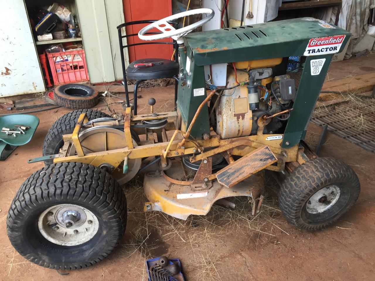

Joined: May 2016
Posts: 3
Thankyou all for the warm welcome,

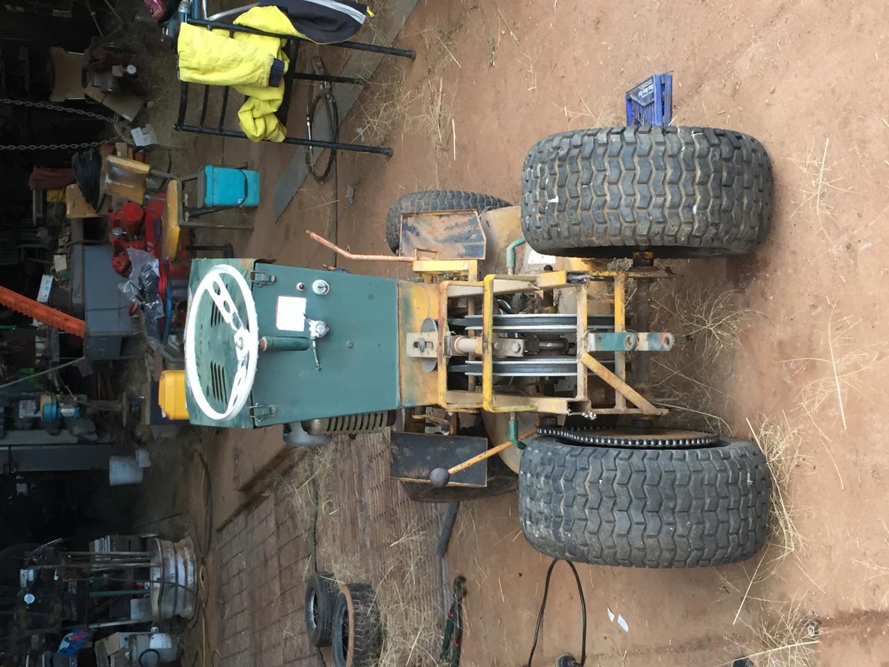

I've just pulled out a few photos out of my phone and put them on the laptop. I have changed the tires and am currently in the process of folding a new rear end, should be good improvements and am keeping all original pieces in order to put it back together correctly. If you notice the right rear hub has been rebuilt by the previous fella who owned it as the key had torn the inside out, he rebuilt it without the key and has just used a lock nut which allows that wheel to slip slightly. [Linked Image]

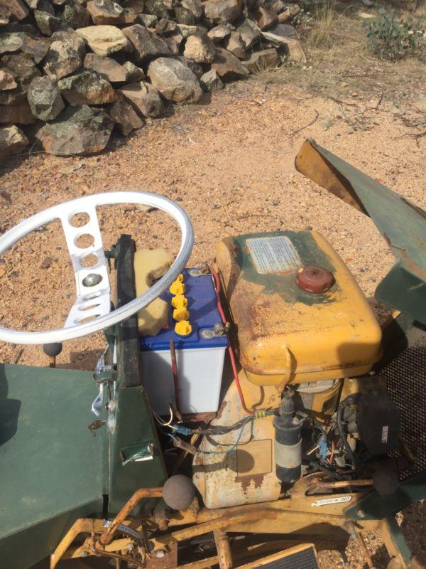

It really does seem that if or when something plays up there are not many genuine parts around these days. Yes this is the eBay one from a week ago. I had it home and took her for a spin and the first thing I noticed was the tires just digging into the moist soil; the turf tires will help a great deal I hope. The battery is a little dull, i have put it on charge, might there be some sort of charging alternator on the motor or I'll have have to trickle charge it when not in use?
Will keep putting up photos as I progress with it.
Cheers smile
Posts: 8,215
Shadow, the good thing with the Greenies is if you can't get the parts you can repair it somehow,adapt something to fit or get somebody to make the part up, anything can be done and Grennies are always worth repairing. As for charging it isn't that important and is usually too difficult and expensive to find the bits for old ones. If it is a pull start you don't need the battery, but if you want or need the electric start, easiest way is to get yourself one of those booster/jump starter packs and just put it where the battery used to sit. These have their own charger so you can put it on charge every couple of months and then you always have a charged battery. $80/100 for the jump starter is about what you would pay for a new battery anyway
