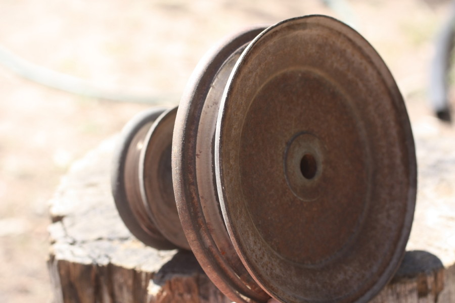

Hi have a Yardman Beetle 1997 rideon with catcher. People complain about them, belts and cables etc. Only ever had to change the belts once and not that hard to do and never broken a cable. Yes its a slow mower but its a catcher rideon and love it.
Motor is a Briggs and Stratton and finally started to smoke. Model 121607 Type 0152-A1 Code 97052856. I was told its 12 cu in which works out to 190 cc. This motor has a 22 mm shaft not stepped 70 mm long. Bought a Yardman push mower and did a motor transplant but, it kicks back when pull starting, apparently it has a light flywheel and relies on the blade being bolted directly to the shaft to run properly. It will run properly if i engage the blades but if i don't or try and drive it it looses power and dies. Sweet if i drive everywhere with the blades engaged.
I can get an expensive new motor but wold like to find out what mower would have a motor to suit second hand. The Yardman Beetle just used a push mower motor with a lot of reduction pully's.
Any help please would be great.

lol thanks already waiting for their reply. Put the motor back on the pushy and runs sweet. No kick back because of the big heavy single blade. Wish i had of known. Skin missing between two fingers from the pull start kicking back on the first pull ooouch

aussietrev, two very big engineering shops out here but they won't do it. The two pully's are about 100mm apart both welded to either end of a pipe. Small one at top bigger one at the bottom. Top one is 22mm id and the pipe is quiet a bigger id with a washer welded inside about half way down. When you slide the pully on the shaft it bottoms out on the washer and you feed the bolt up from the bottom in a socket with extension and tighten.
I did ask if they could make another pulley and they said if i can find two steel pully's the right size yes. Can't find any @#$#@##.

So can I just verify, if you had a pulley set with the small one at the top and an internal diameter of the pipe at 1" all the way, you could fit it on the 5HP you have there, even if it meant making a short shim sleeve for the 22mm section? Because if you can, I have one like that here. Alternatively, you already have the two steel pulleys you need, you just have to cut them off the piece of pipe then the machine shop could easily open out the diameter of the pulley then put them on a new piece of pipe for you.

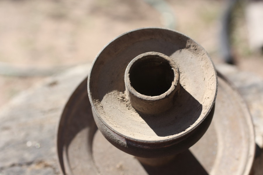

The top of the pully ID is 22mm. The 15mm or so that you can see sticking out the top is 70mm long and has a hole in the end for a bolt to bolt up to the motor shaft. The pipe you can see holding the two pully's apart is welded to the bottom pully and big enough ID to slide over the pipe from the top pully right up to the top pully and welded (sleeved).
Every spare motor i have here has a stepped shaft 22mm to 25mm so cant use them. The motor that came out of the Yardman had a straight not stepped shaft 22mm. Yardman motor shaft was 70mm long and all my spare motors are the same 70mm but stepped.

The tube between the two pully's has a bigger OD bit hard to see but it slides over the tube coming down from the top pully and is welded to the bottom of the top pully.
Put the bolt in a socket with extension and feed up through the centre of the bottom pully and tighten.

Yeah no one really want's to even have a go. Finding it hard even to find these pully's. Their tinny type pully's and the new style are cast heavy with fancy inserts that lock on to shafts. The tube that is welded to both pully's is a tinny thin tube. The tube that is part of the top pully is quiet thick walled with key way.
Was told even if i cut the tube in half they can't machine the pully out from 22mm to 25mm because the cutter would catch the key way and damage the cutter. Find that hard to believe.
So try and find a motor to suit shaft, modify the pully or make a new one.
I recon if i can find pully's the tube would be no problem and get a guy to mig it up and problem solved. NOW SEARCHING FOR PULLY'S (pulley's spelt properly i have been told lol)

Not a simple thing to weld up, easy for the manufacturer when they are all jigged up and held central and square. I would be looking at bolting a weight between the pulleys to compensate for the lack of spinning crankshaft weight. This is not just wack some weight on it, this needs to be done in a professional manner by someone with fitting and machining experience

The one I have here is exactly like the one you show except it is 25mm/1" all the way through, came off a Cox XL Scout ride on, and has the same method of attaching. So if your replacement engine has a 25mm shaft, even with a stepped section it should go on okay. If you did need to make a short sleeve to fit the stepped section that would be a pretty simple job for machine shop to do. I'll take some photos later.

Measurement across my top pulley is 90mm.
Measurement across my bottom pulley is 125mm.
Measurement bottom to very top of shaft is 152mm
Measurement centre of pulley to centre of pulley is 115mm
Keyway is 4.8mm wide
From the top of the shaft to where the bolt tightens up inside the pulley tube is 70mm
