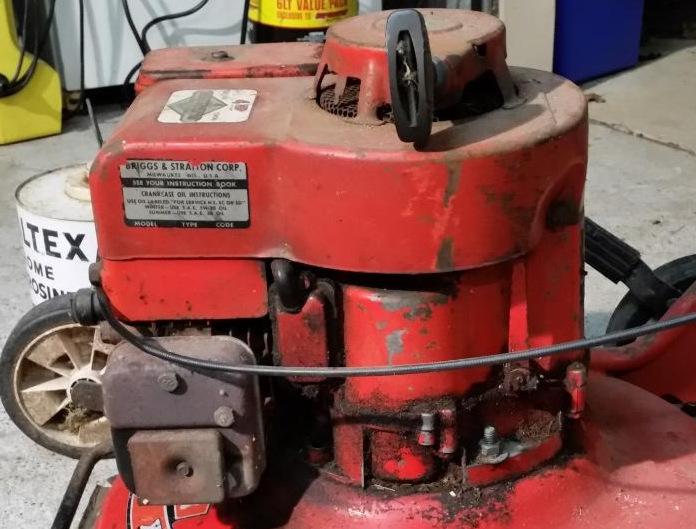

Thank you very much that helps greatly. Is it possible to work out the year model of my rover/engine and whether or not it is the original Briggs engine? I have attatched photos of the serial numbers.
thanks again

The first six digits of the "code" are the date, the last two, or sometimes only one, are the place of manufacture code. So, 5/5/93 would be the date for the engine, probably a year later for the machine by the time the engine gets imported into Australia.
And that means ...
it is not the original engine.
I suspect that a 7210 was originally a Colt Minor - with the 10 Series 4hp.
[i.e. Model 72 + 10 Series]
This would be consistent with the 7313 being the 13 Series
[i.e. Model 73 + 13 Series]
Colt Minors (or Colt 4hp) would be rare these days.
Many dealers simply preferred to sell the 5hp machine.
Both the 10 & 13 Series shared the same design philosophy:
smaller bore; longer stroke. With their cast iron flywheel,
both were torquey motors, and both loved by repairers.
The 10 Series ended production in the early 1980s. It was replaced
with the 11 series 4hp and the 4hp Colt became a Model 7221.

I think its too late for this old girl. This is the condition I found it in. Surprisingly it ran okay. How ever one rear wheel was broken and the axle tip snapped clean off. Can you tell me the displacement of the engine? Through the Briggs website I have downloaded a couple of manuals but neither specify displacement and HP.

Model 126702 = nominal 12 cu in. Actual displacement 188cc, calculated from bore & stroke.

It's a red 4hp Briggs engine. I could give you the engine numbers but its near impossible to read- model- 10xxx12? type- 036 01?
That is going off what my father told me. I do know he purchased it in 1980, I remember it as we bought the block then. It's still in semi-regular use.
