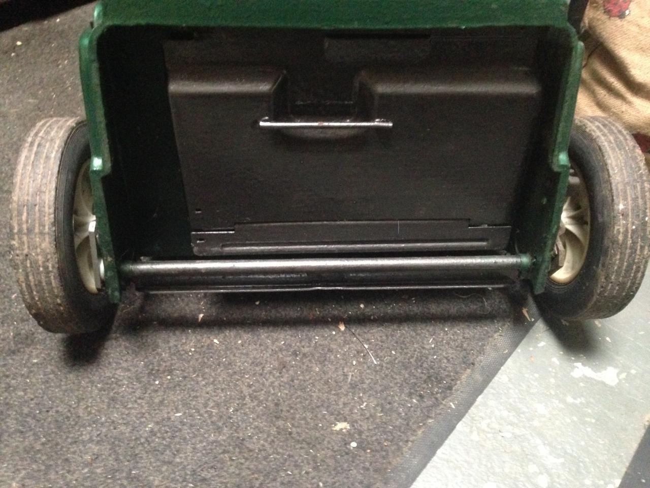

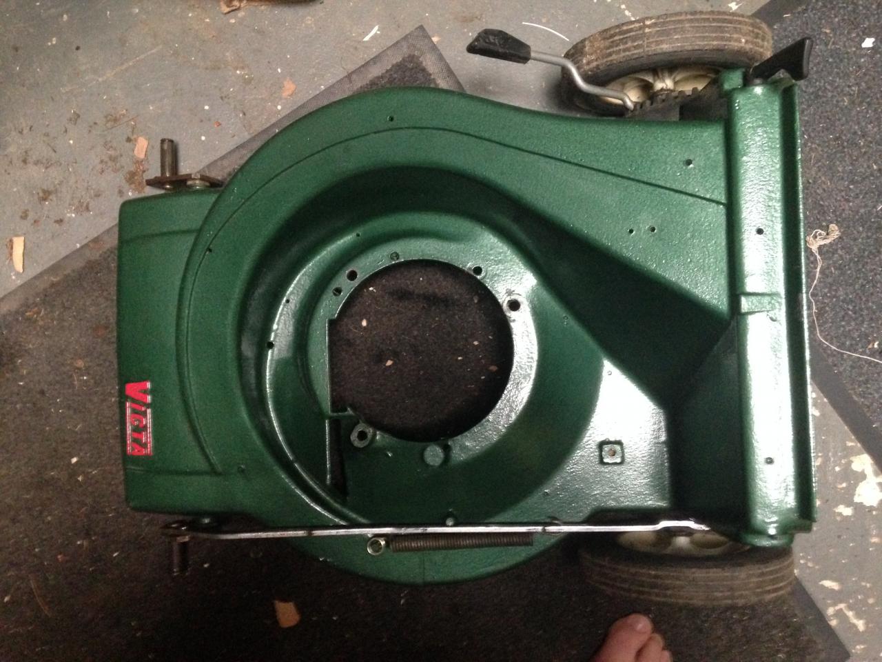

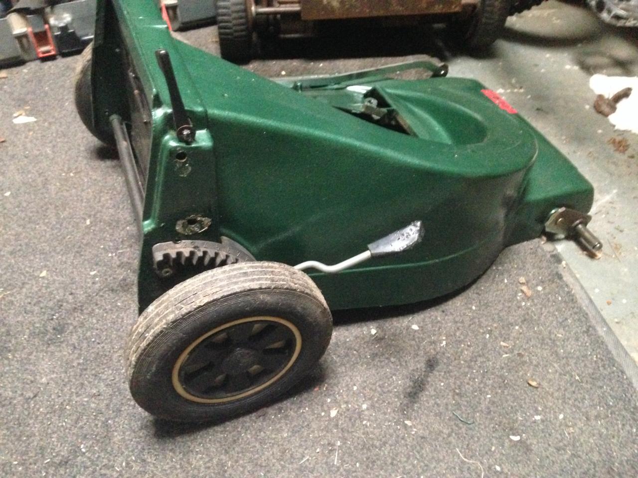

My first post for quite a few years now when I used to own an old Victa Compact. I have recently acquired this base which has been painted up by the previous owner and I am having trouble identifying what model it is so that I can look for a replacement engine.
Does anyone have any ideas..??
Not sure if those are the original wheels, I still have the front pair also have the handles and grass box if it would help. Seems to have the "safety hinged flap" which the previous owner thought might be for mulching?
Thanks in advance for any help with this.

This one is tricky - a 1970s base with a twist. It appears to take
a 4-stroke engine, but with a dress cowl that screwed into the
top of the alloy chute. I can't say I recall any of our 4-strokes that
did that.
However I do know of an export Mustang Electric model with the same style of
wheel as yours, and a dress cowl that affixed to the chute.
I wonder whether the electric engine adapted to the 4-stroke
high-arch base from the period, and you have a Mustang Electric?
Any thoughts?
