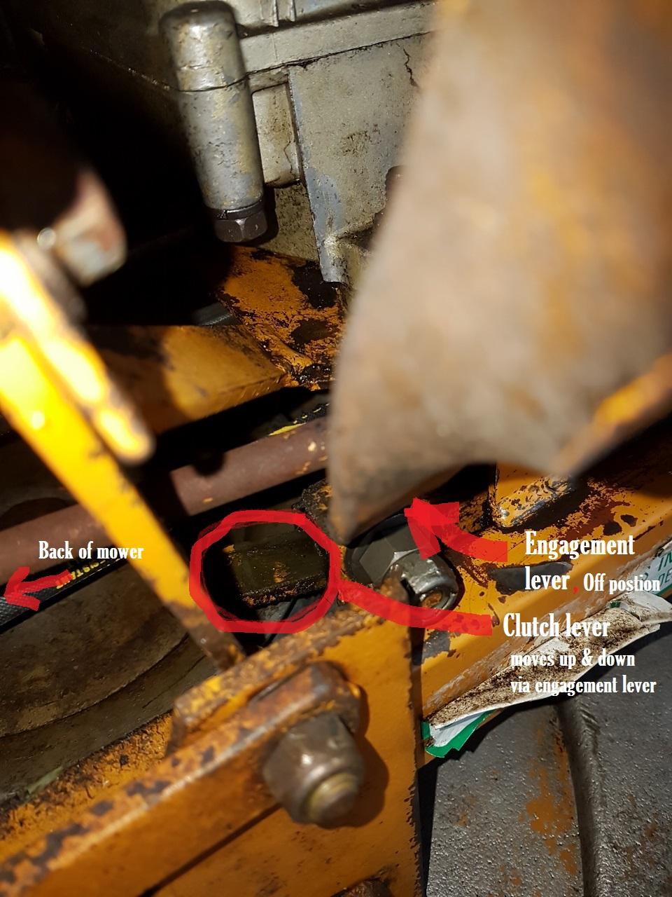

Hi all, and thanks for the add. I have recently aquired a greenfield lawn tractor 8 that has what appears to be issues dis engaging the blades (has a 2 peice pulley by the way). Has anyone got any pics or a manual on the set up as well as the engaging handle for the throw out bearing?. ANY help would be appreciated!

A Pic of the model you have would help heaps. Also have a look at what the cutter engagement lever & linkages are doing when you move it

Im having trouble uploading a pic off my phone, but it runs a "throw out" bearing that is mounted underneath the 2 piece pulley, the cutter lever when engaged puts pressure on the bearing and the lower half of the pulley.

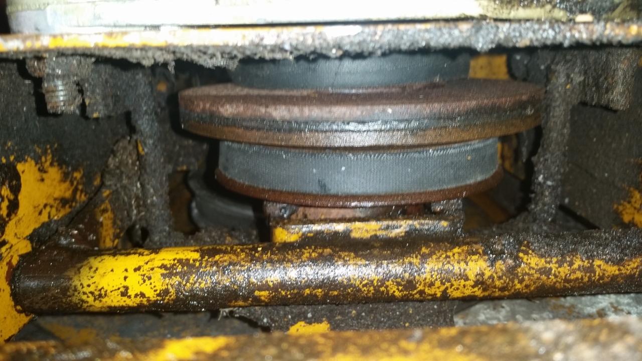

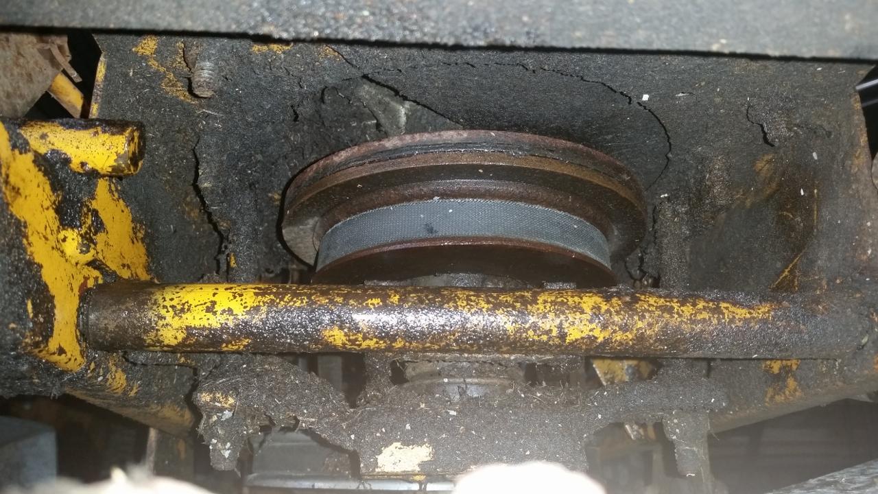

Is this what you are seeing? This is what's on my Mini tractor8 ( under motor ) ![[Linked Image]](https://www.outdoorking-forum.com.au/forum/uploads/usergals/2016/06/full-9138-28720-20150621_152444_1280x720.jpg) ![[Linked Image]](https://www.outdoorking-forum.com.au/forum/uploads/usergals/2016/06/full-9138-28722-20150621_152420_1280x720.jpg) Also if It's what I think it is, Make sure the Deck mounting bolts aren't over tightened (x3). The deck slides back & forth on the deck mounting bracket to tension cutter belt via a mounted spring on it.. You could try going on this site via your mobile & put up pix.

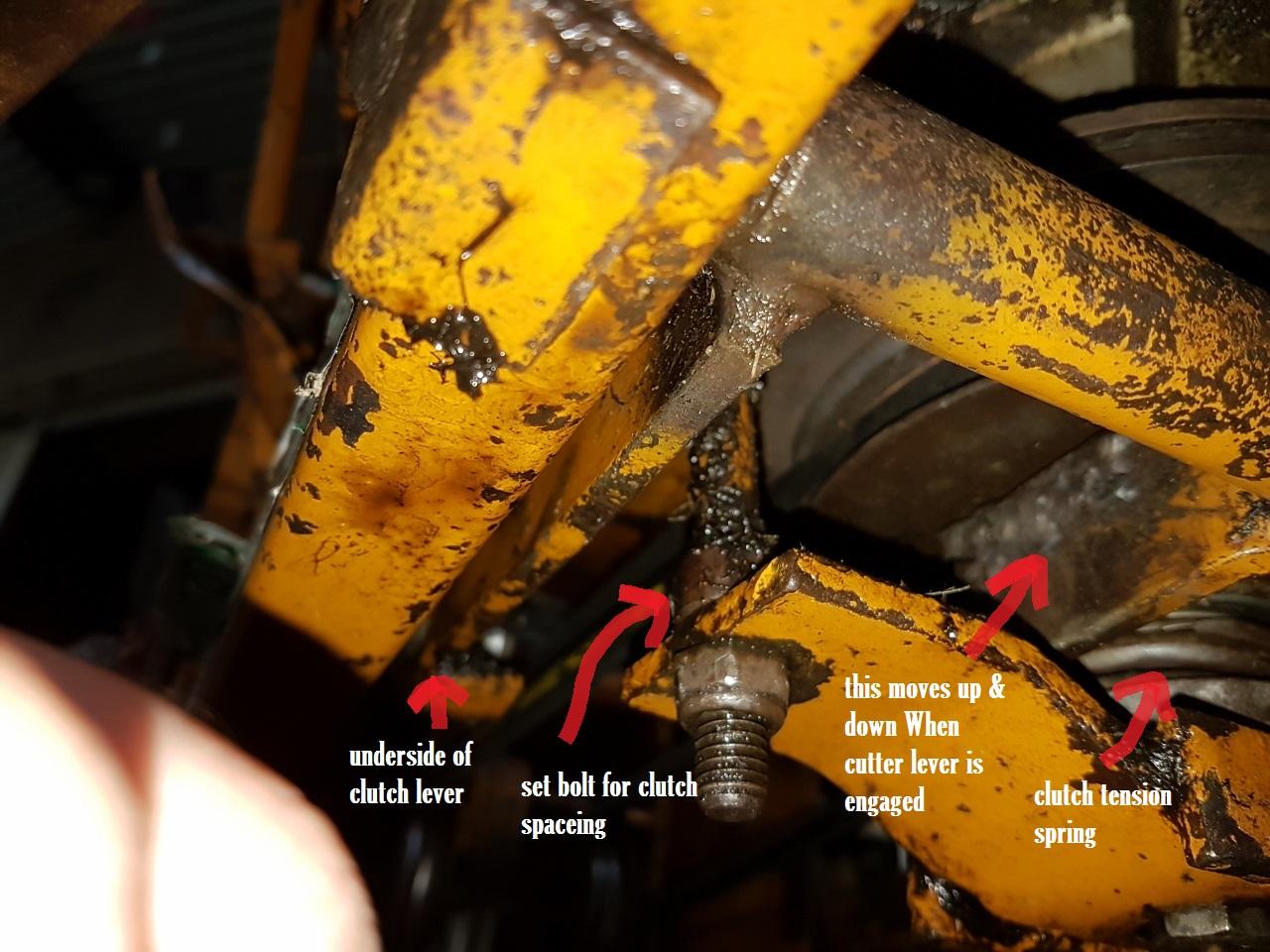

Thanks guys for your valueble input, yes paul, that is exactly what im seeing.I wont be inhailing near thst clutch anytime soon lol, paul, if you could, could u take photos of the cutter blade lever assembly? I have a feeling there is some sort of spring missing.(to relieve friction from the lower half of the pulley). And if anyone has a manual (long shot i know) can they point me in the right direction? Thanks guy's, wonderful site, awsome people !

Thanks paul, i swear if i ever meet you, ill have to buy you a beer or two lol at the moment, there is no contact between the cutting deck handle and the arm that carries the bearing its just flapping in the breeze. Thanks for your help guys.
Joined: Apr 2016
Posts: 13
I think ill loosen the deck bolts off and tinker with the adjustment on the carrier for the lower spring. I think someone along the line has stuffed it up but now i feel i have enough input to finish it off. Ill upload s youtube clip of its maiden voyage lol

Hi all, just a follow up to my issues. I have placed it all back together and have driven it for the first time in 10 (ish) years. A new problem has risen (lol). It turns out when you put the blades on, it doesnt engage. But i know where the problem now lays (keyway collar is on the old engine which is on another mower), hopefully im aloud to pull the other one apart to retrieve the other collar (dont think itll be an issue).
