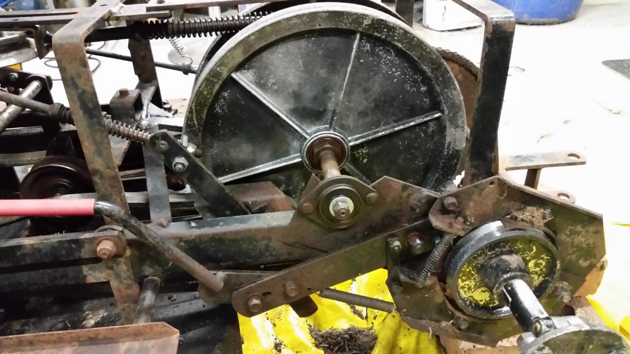

Posts: 310
My Big 11-30 Greenfield has a brake fitted... My HD8 & mini Tractor8 have locking hand brakes
see below 11-30 brake, I have put new pads in since this pic.
Paul
