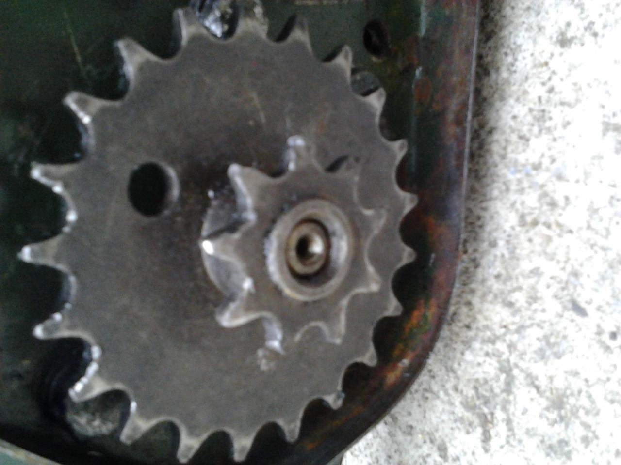

i will get some pics tomorrow,it has key way, it undoes the same way as motor turns,so how does it stay on ?
Posts: 988
Likes: 7
It may require a lock nut or a fold over lock tab, pics will help :-)
Posts: 282
gml
Offline
Greenfield Enthusiast
both sprockets tighten clockwise,loosen anti clockwise,wont they just loosen themselves and come off with engine operating? [Linked Image]
Posts: 988
Likes: 7
Should work OK as the whole assembly is rotating together. Tighten it up as hard as you can with a socket and bar then give the bar a tap with a hammer to finish. If you can work out a way to hold the shaft while tightening even better. Have you got the chain ?

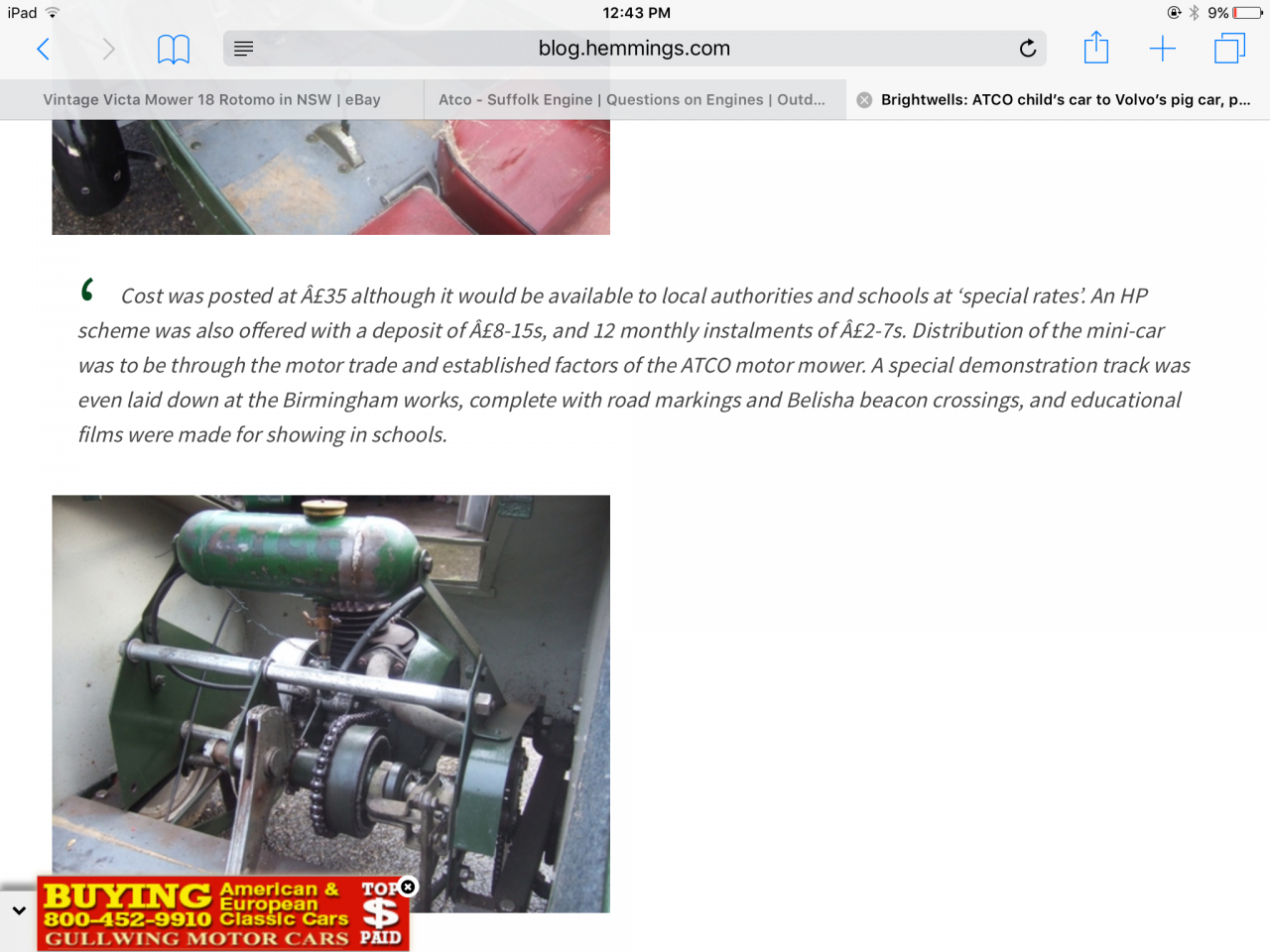

Posts: 693
Off topic a bit but saw an ATCO childs car on the Antiques Roadshow the other day It looked like they had just taken the cutter off one of their mowers and put it in the back of the car to drive the wheels. Apparently they were made right through to the 50's and could manage 8 MPH.
Posts: 988
Likes: 7
Hello all,
There is a great story on these here:-
https://www.outdoorking-forum.com.au/forum/ubbthreads.php?ubb=showflat&Number=51418
Joined: Sep 2014
Posts: 14
Geez!! A beauty!!! They loved green didn't they ?
