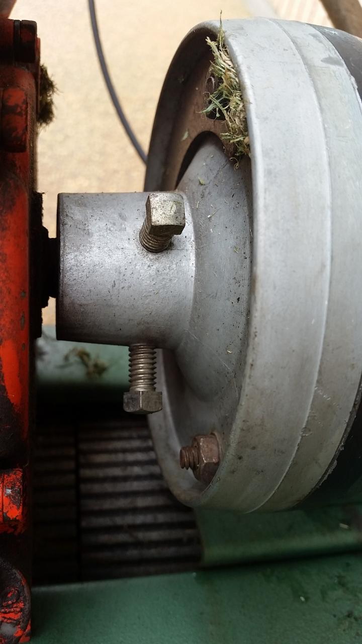

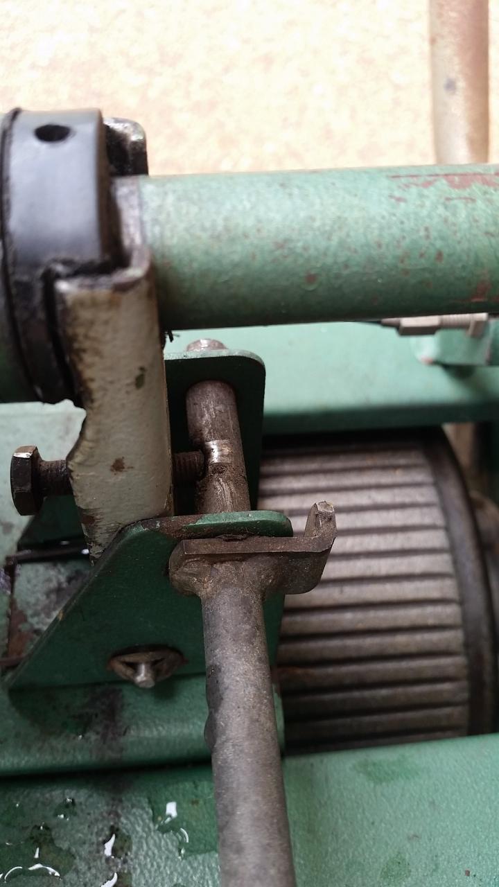

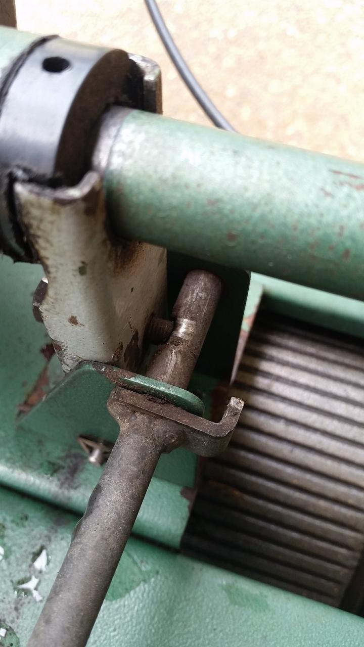

I've had a cursory glance and I suspect it may have something to do with the adjustment of the cutter clutch and the engine drive shaft, but unfortunately that's about as far as my current knowledge will take me. I did notice what seems to be a noticeable amount of free movement in the cutter clutch lever from full vertical (disengaged) to the right (if standing in front of the machine looking at it) - i.e. the opposite direction the clutch lever is intended to move. I've also noticed the screw directly beneath the engine half of the cutter clutch - does this have anything to do with the issue? I also noticed what I thought may be a bit of wear on the clutch lever where this screw meets it - it appears to have ground the surface flat (unless this is originally how it was manufactured). I have attached some photos below, so hopefully they describe better what I am talking about.

You mention a fair amount of free play in the lever, well that's it. You have to adjust the set screw in the fork assembly so that there is about half a millimetre of play between the clutch fork and the thrust pad. This will then take out the excessive amount of slack in the lever and push the clutch cone further inwards, thus no chance of it grabbing. The flat part is designed to be there but put a dob of grease on the contact points where you can see shiny metal.

Also a bit of an observation and that is the clutch half should be a bit closer to the engine, about two to three millimetre clearance.

Thanks for your reply - that did the trick! There was a bit of mucking around as when I first tighten the set screw I must have gone too tight as I could no longer manipulate the lever - then it went back to too loose. Got it where I thought was right and started it up and it ran like a dream. I suspect that adjustment actually had impacts on the cutting reel itself when it was engaged, as it seemed to run much faster/better post adjustment. I did note that the lever still moves to the right about the same amount (i.e. past full disengaged) but the handle is certainly a lot 'tighter' to operate - is this correct? I feel the lever shouldn't really go past full vertical, the only explanation I can think of is that the flat part on the lever is overly worn and allows a bit of free play, even when the set screw is adjusted.
A quick query - which piece is the 'black plastic thrust pad'? Is that the first circular black piece with notches in it at the top of (what I assume is) the fork assembly? Should this piece not be as notched/worn as it is?
Also, can you please clarify your statement about the clutch half being closer to the engine - is that the gap between the silver clutch half and the orange side wall of the engine (shown in picture 6)? IS that as simple as undoing the two square headed set screws and sliding the clutch half closer towards the engine on the drive shaft and then re-tightening them as well as adjusting the clutch fork set screw accordingly to move the 'other' clutch half equally closer? Sorry if that is confusing, but this mechanical stuff is all fairly new to me!

Yes the part I am referring to is that black plastic component . The notches on the side are there to accommodate the clutch fork and thus stop the pad from rotating. It's just showing a bit of heat stress.
Yes the clutch half is a fraction to far away from the side of the engine casting. all you need to do is loosen the two square headed set screws and slide the body towards the engine so that there's about a 2 to 3 mm gap between and then adjust the clutch fork accordingly as you did previously.
Also remember that when the clutch is engaged (driving Cutter Reel) that you should have a small amount of free play between the fork and thrust pad so that there's no actual residual pressure on the 3 components involved (Clutch Cone, Thrust Pad and Clutch Fork)
