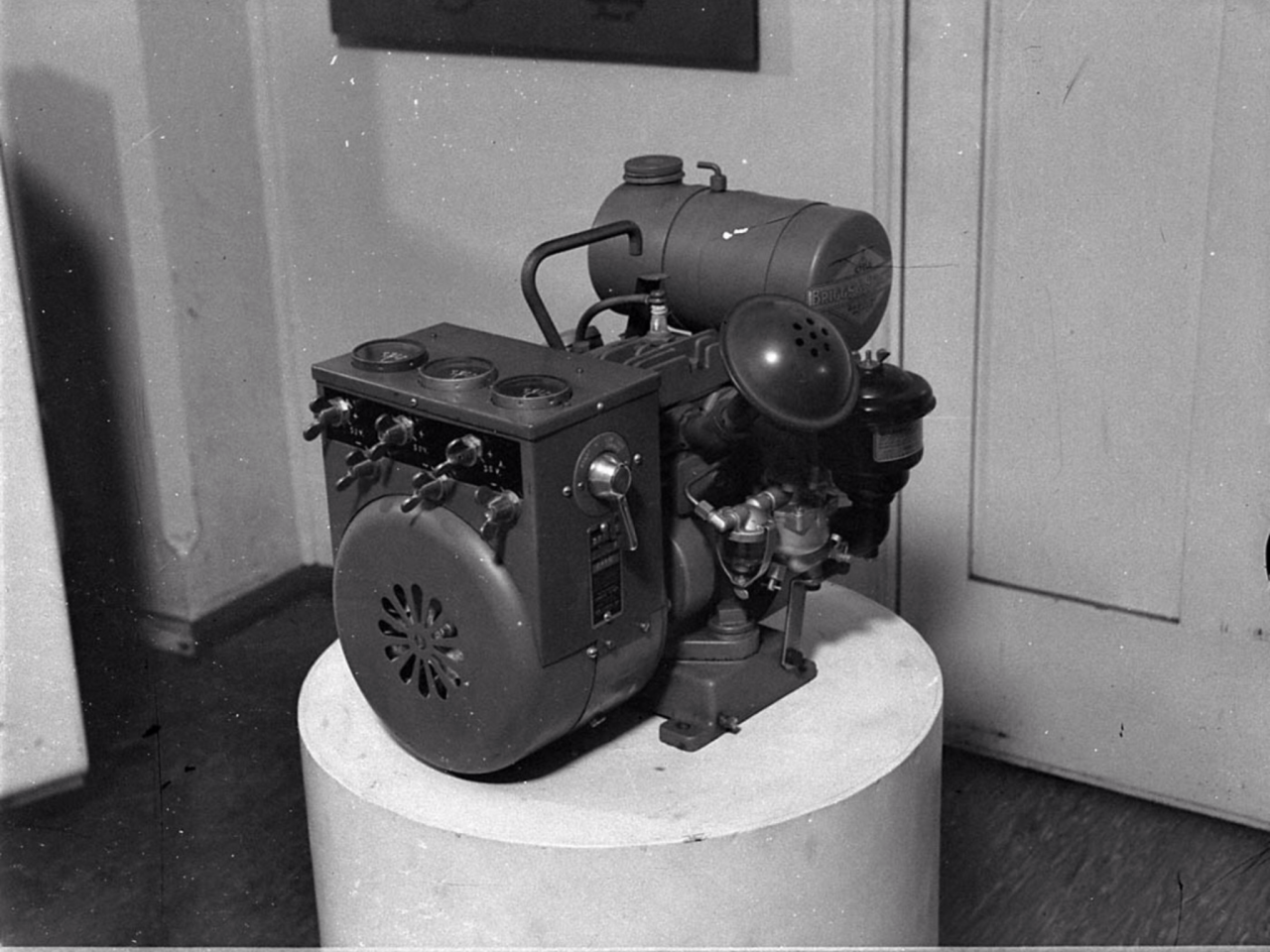

I picked this engine up from a friend of mine, it was locked solid and full of water. Australian made by Pecision Engineering in Sydney. It is of course a Briggs and Stratton clone engine, Amplion also manufactured a clone as well. I have recently acquired an Amplion and there are some minor differences in the build.
CyberJack supplied some material showing the genset which I believe mine was once a part of. I found army green paint on mine so maybe it's an ex army unit.
More to follow

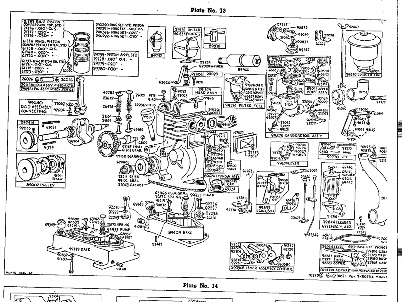

Here is a manual for it which covers all of the clones and is free to download from Briggs and Stratton
http://www.briggsandstratton.com/~/media/Frequently%20Asked%20Questions/Engine/PDFs/Antique%20Manuals/Antique%20Manuals%20FAQ%201/Model%20I-domestic.pdf
:-) I have a block with a very good bore for a Briggs, interesting thing is that there is no markings on the Briggs block but Amplion put there name on the camshaft moulding. Precision left theirs unmarked as well
