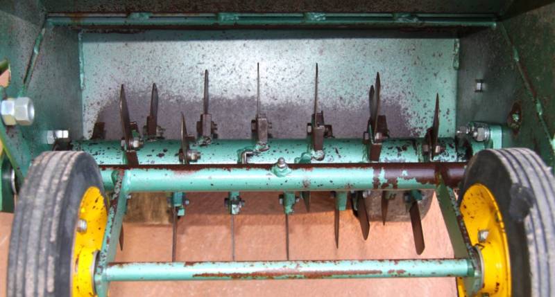

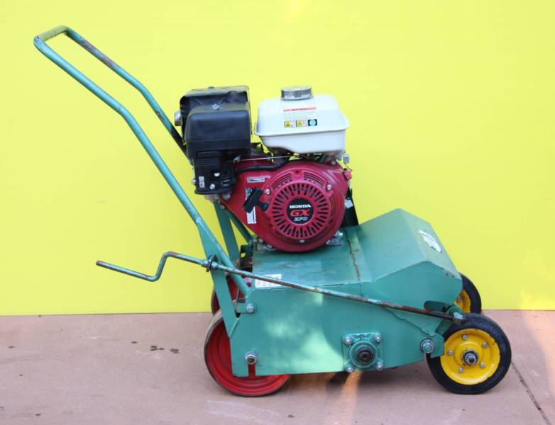

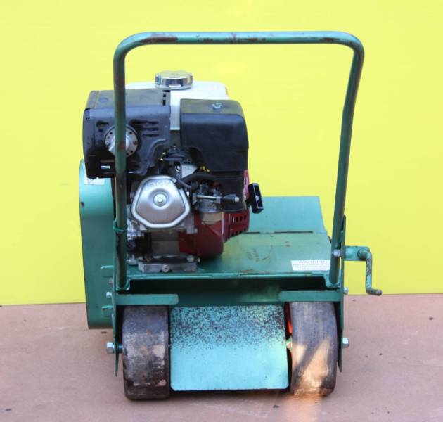

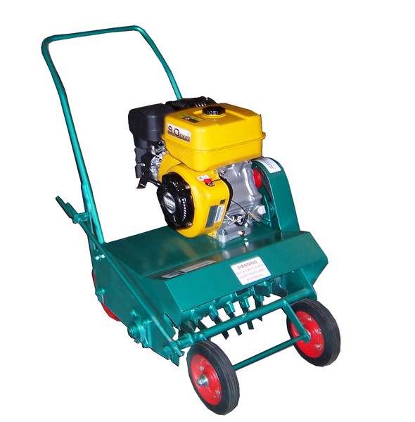

After some playing around with search terms [these things are also called vertimowers and dethatchers], I believe I have an ID on this one; it's still in production over in WA.
There are a number of distinctive features that pretty much ensure that it's an INGS Engineering Vertimower & Thatcher
Maker's pic:
A few detail pics pinched from a current Dumbtree WA ad:
The manufacturer isn't on the Web, but at least one of their dealers is, Crommelins
