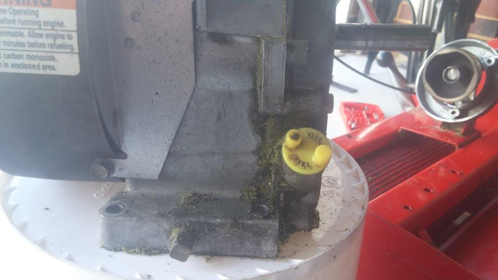

The big side gasket/seal on the shaft side of the engine might be leaking a tad, there was a bit of residue at the bottom on that side when I picked her up.

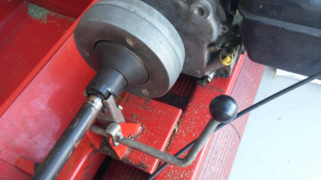

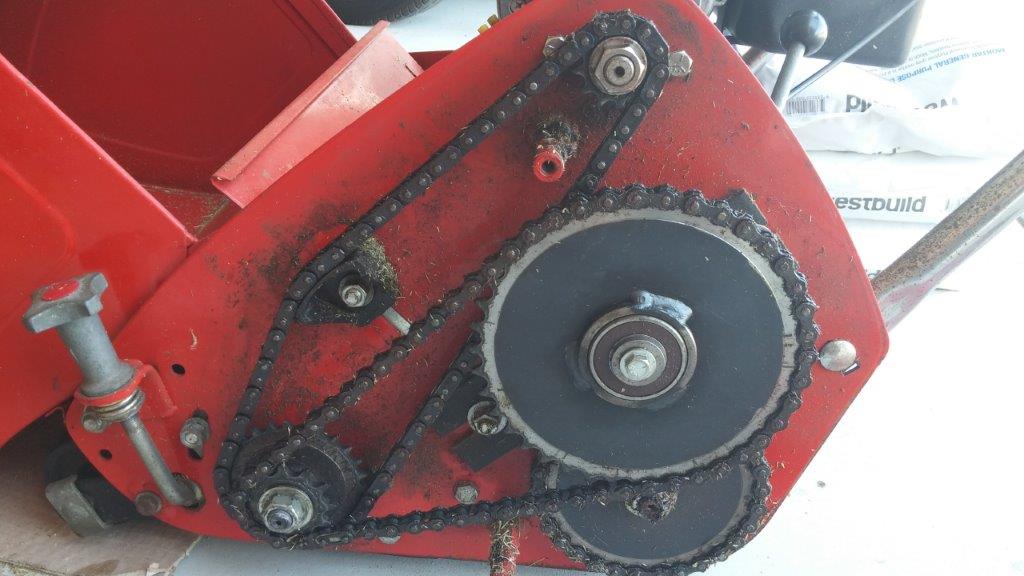

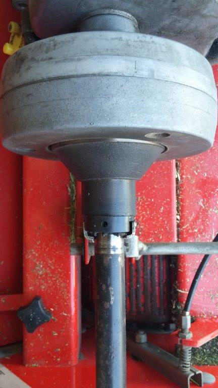

Thanks for the reply. Here are some pics, although re-reading your post, I neglected to take some pictures of the bed knife area. I was able to tighten the two clutch housing bolts a bit tighter - under a quarter turn, but didn't want to go too tight in case it would be detrimental or I stripped it. It's allowed the reel to engage now and spin under load, however the clutch housing still visibly wobbles, especially noticeable at slow speed.
What do you think of the chain tightness?
Roverdude45

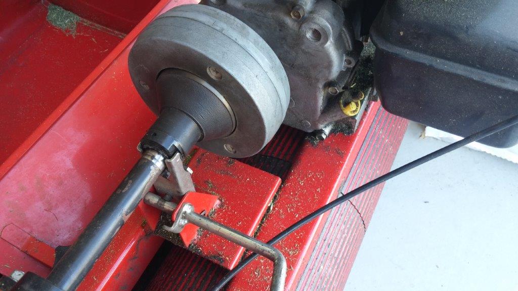

Here's one of the clutch engaged, looks like it's coming out far enough.
Hi there roverdude45,
Well it seems like you have what we call a flogged out clutch half which has also added a bit of premature wear on the clutch lining and the plastic thrust pad.
First things first and that is undo the 3 bolts that hold the clutch halves together and then remove the 4 mounting bolts that secure the engine to the chassis. Once this has been done inspect the clutch cork as it should have around 1.5 mm of cork thickness, but I feel that it will be much thinner than that and if that's the case I would organise a new lining and a the engine side clutch body at the same time.
Before you order any parts can you please remove the clutch half from the engines PTO shaft. One thing I feel might be an issue and that is the key steel that is meant to stop the shaft rotating inside the clutch half and create positive drive.
I'm bringing this up as you mentioned about seeing the shaft spin inside the clutch half and I'm starting to wonder if a previous tenant or lawnmower shop has had the engine off and forgotten to reinsert the key steel and just used the two set screws as a way of locking up the clutch onto shaft.
Once you get these major components apart and post some pictures up of them, I'll then be able to give you some further advise.

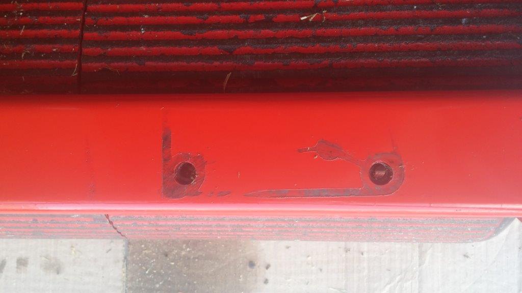

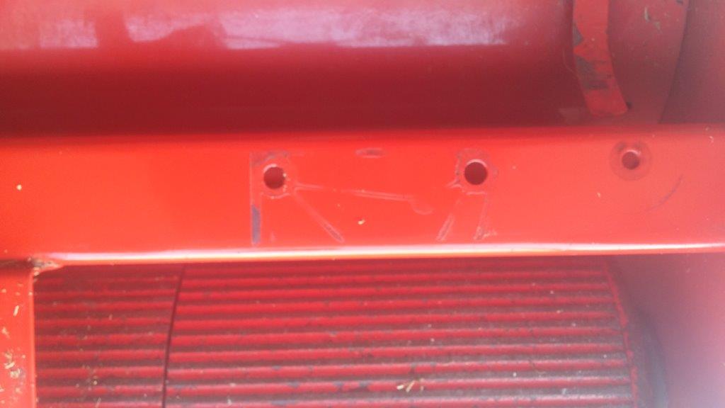

PS. While I remember can you please once you've removed the engine, clean the chassis rails and take some good close up photos of around the engine mounting holes.

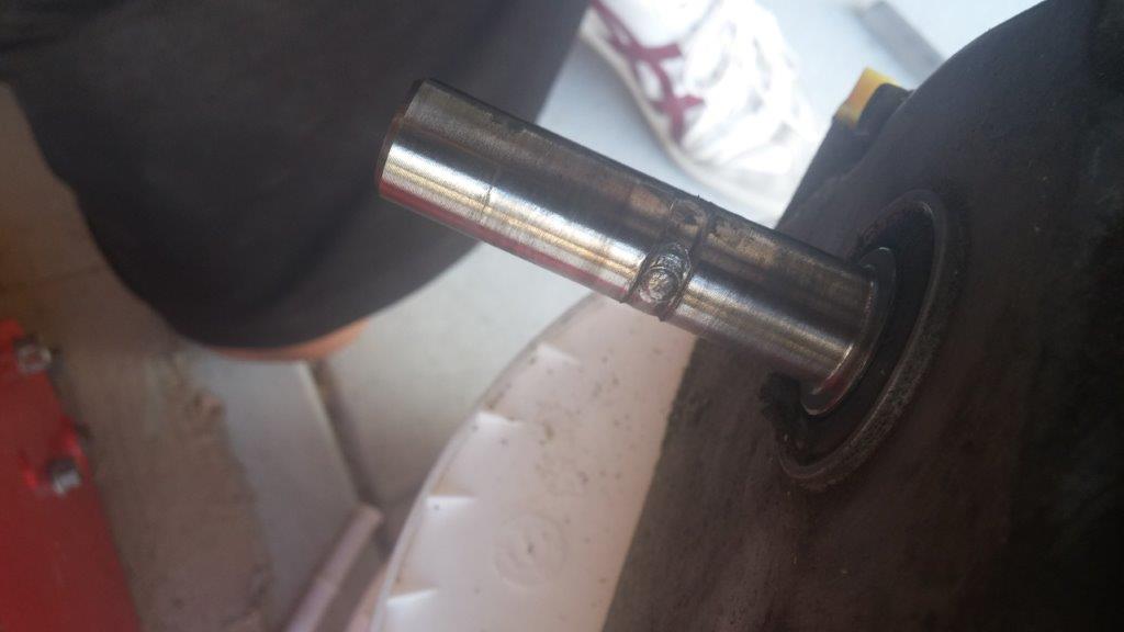

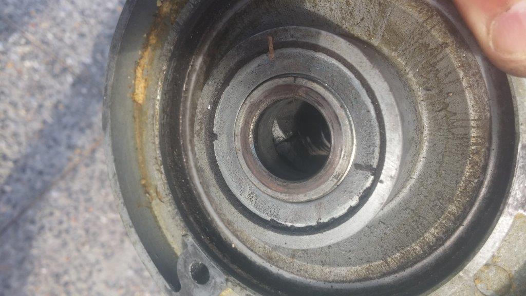

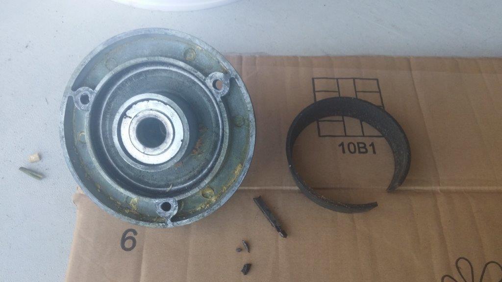

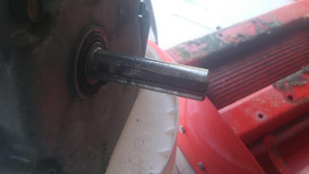

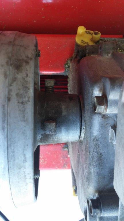

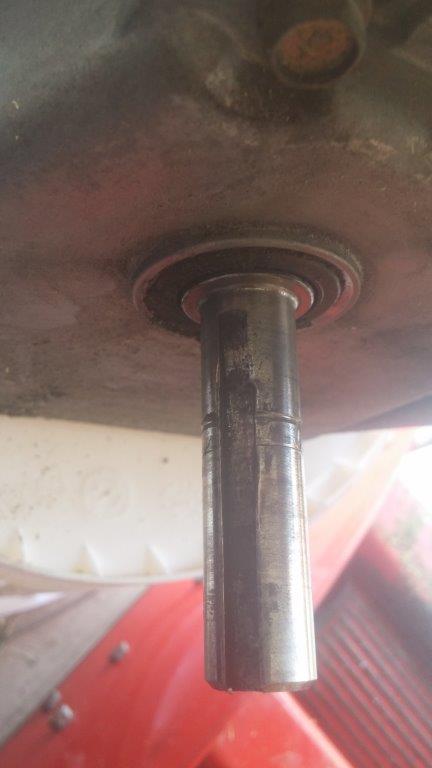

Good news is I had time to look at it this arvo. Bad news is looks like my key is blown along with my clutch half (crack inside it), and there is certainly some damage to my engine shaft.
From what I can tell the issue has been ongoing for some time. There are multiple points on where the two bolts of the clutch half housing have been tightened hard onto the shaft, and a channel has been worn into the shaft - should be able to see from the pics.
My clutch cork basically fell out, glue must have come off some time ago, it's worn down to about 3mm. Did you mean this cork is normal 1.5cm thick?
The deck itself looks OK, I couldn't see any cracking.

- Based on your experience is the engine shaft OK to run as is or will I have balance/vibration issues and or risk damage to new parts?
- Otherwise will need to replace the shaft (if possible?) as well as that main side seal by the looks of it. Or maybe just get a new motor with the newer shaft size and clutch half if the costs are going up.

FYI my motor details are as follows:
Model 091202
Type 1371 E1
Code 990713YA
I had a look at the outdoorking shop but couldn't find a specific shaft listing for 091202-1371-E1. Just dunno how easily available they are or if I can just use any crankshaft from a second hand 3.5hp engine, does the 'type' matter? Either way OEM new looks pricey - if I have to replace the shaft with one of those I think I'll just bank on a new motor?

I appreciate what Bruce has said in the above post and thus has pointed you in the right direction regarding the said component but I note that Price is an issue and the thought of purchasing a replacement engine is on your mind, thus I have come up with the following solution.
No need to worry about that engine shaft as I feel it will be fine. All I would do is rub it fully with a fine grade emery to remove any burs. I know that the damage from the set screws looks bad but it's not that critical because the parts of the shaft that need to be absolutely parallel are just before the screw location and also at the end of the shaft. Now as the mating parts are steel and die cast, it will always be the die cast that wears away, not the steel. The worn groove left by the screws are only going to have the screws bite into it again to stop any movement. Hope that explains it for you, also if you thinking of totally eliminating the issue, a new Chonda engine at around $129 delivered would be the obvious choice.
Now,
You'll have to purchase another clutch half, Thrust Bearing that's internally damaged, Key steel and also buy a new cork lining along with the glue required to do the job. Oh and BTW don't forget to purchase a new black plastic clutch thrust pad. This will ensure a square push on the clutch cone.
Re-use your current set screws from the previous clutch thus saving on costs of replacements. The screws will be fine on the PTO shaft as long as they are done up nice and tight again, thus with the fitment of a new clutch body all parts will fit together rather snug and perfectly aligned.

PS. Yes those rails are A OK, very lucky indeed I must say considering the state of your clutch.
