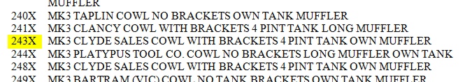

had a 'hammertone' finish. The Villiers MK3 Midget engine was stamped
243X. The Villiers documents I have confirmed this was the original
Clyde specification engine.
