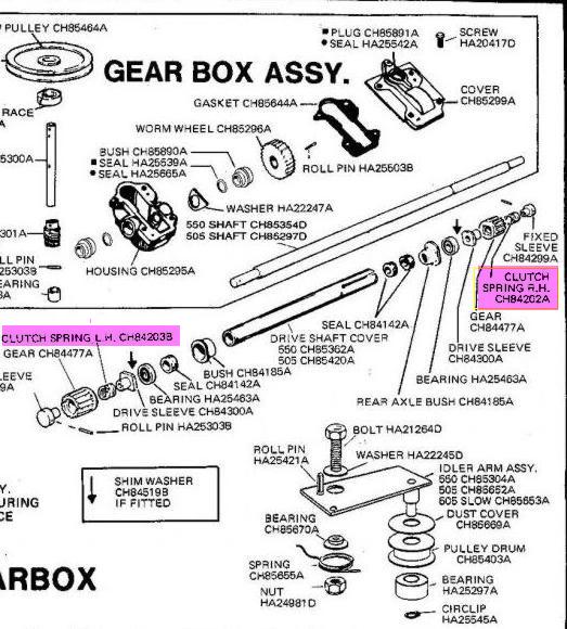

I found an illustration. There is a left-hand and right-hand spring
in the drive carriers. Simply swap the drive carrier assemblies side-to-side.
This is the most obvious explanation for what you have described.

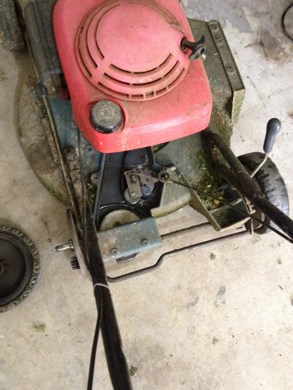

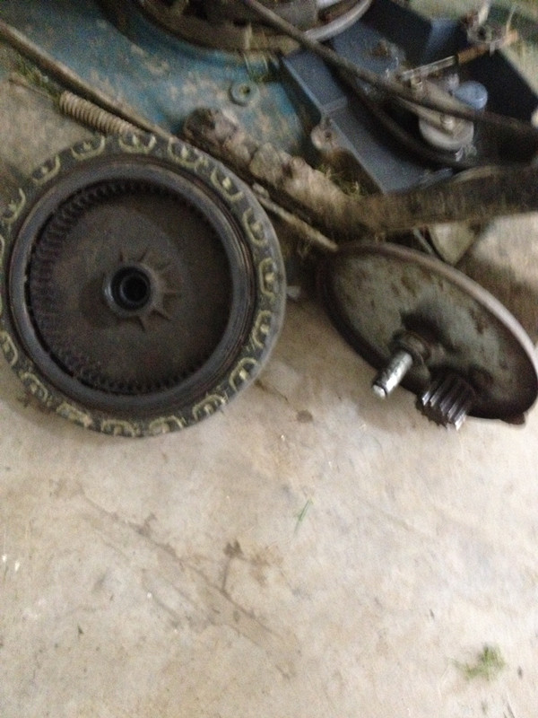

Hi here are two picture on the SP part.
