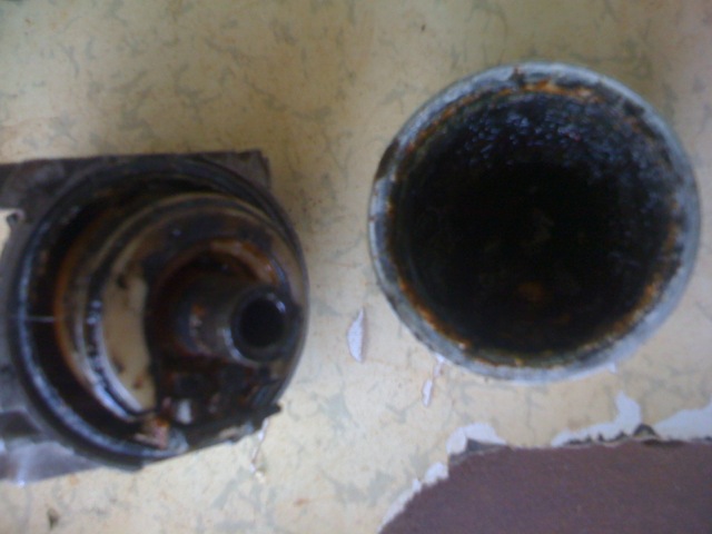

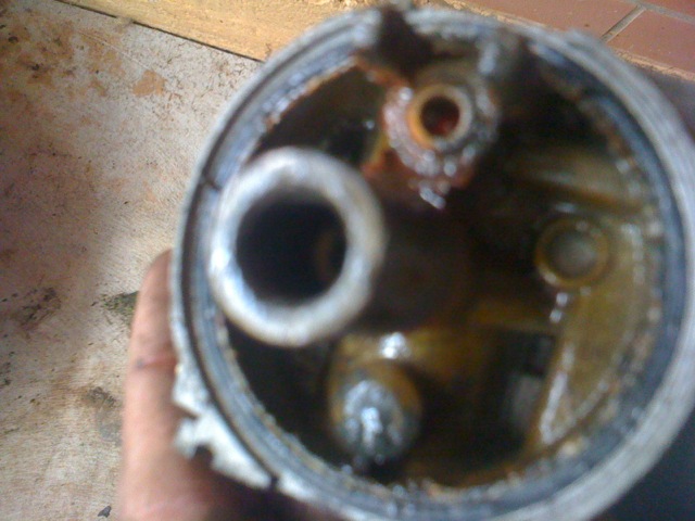

Wouldn't start. Needed a carby clean out. Bare in mind this is a near new Gardeners Choice mower.
Fuel filter completely blocked, carby completely blocked. It seems the owner ran it on a VERY rich 2 stroke mix!
Couldn't believe it when I pulled it apart!
Pete
maybe there is a problem with the anodizing or whatever the coating is they almost use on sanli's carb's . had them come through with broken starter cords and all say ( never was hard to start before ) all full of rust n crud but ones fitted to pope and victa's never seem as bad , water yes but just gunge really , no scale like these ones i wonder why , or is it just the fuel we get around here PETE ?

Maybe. I did a Victa V40 today which also needed a carby clean out but it's bowl was spotless.
This particular case was user error though as when I squirted carb cleaner through the inlet thick red oil squirted out WTF
I had to use sand paper to clean this one out the scale was that bad.
Could be something in the fuel but I'd say if it is a supply issue it's more likely to be a petrol station contamination issue ... something to think about though.
Pete
