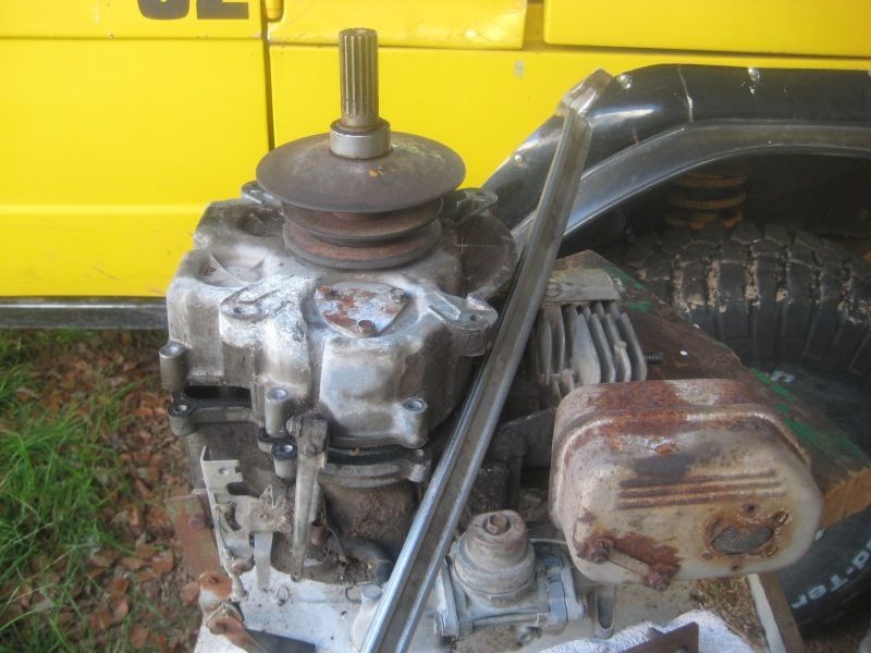

Originally Posted by Bushy555
Wonder if this will work:
[Linked Image from i288.photobucket.com]
Have been told that the top output shaft apparently is on a separate spline shaft of the output of the Honda engine. Correct? Have tried downloading the owners manual and so far I can't see how it all falls apart. Perhaps I am reading the manual incorrectly.Yes it anti clock wise
Cheers for any info, pointers, help at all.
Posts: 7
Heh. Dead set simple.
Put a big set of stilsons on to the shaft, gave it a tap, and it just came straight off (un screwed - anti clockwise). Couldn't believe it.
And because I have been pulling, pushing, hitting, slamming the engine for the past four months trying to get it off incorrectly, the pulley's just slipped straight off in my hands. I can easily see how it can be rusted in place and take a few tonne of a press to pull it off, but because I've been playing with it for so long --- just slipped off as though it was just sitting there.
All up, it took me about one minute and thirty seconds from picking up the stilsons under the bench to having the cover off and the two smaller lower shafts out.
Looks like I have a smashed valve stem push rod thingy which is stuck inside and is causing a full lock up upon the cam trying to push the valve push rod.
