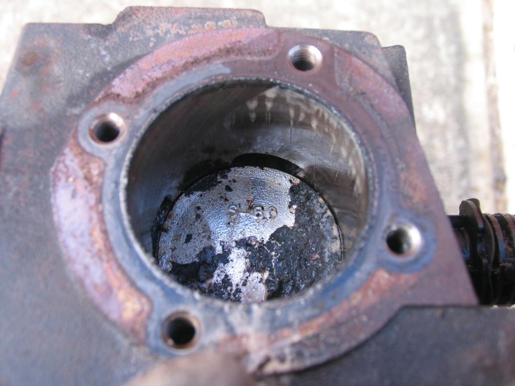

Just picked up a fairly late model victa this arvo(freebie) that had been for a paddle in one of Brisbane's latest sun showers.The gentleman said it has been for a swim so the first thing I have done is pull the plug and gave it a few pulls and there was water in the cylinder,now I want to strip the engine down for inspection.Is removing the starter and head enough(and fuel system) to give a clean out or should I strip it to a bare block and inspect everything?I have intentions of moving the mower on so I don't want anything dodgey with my name on it.

Yeah sorry about the lack of info but I think it'll be worth it.I'm new to the fixing mower thing and it is a reflex action on thinking victa = 2stroke.But anyway Its a 2 stroke 160 powertorque.Not much water came out i'd say 50ml at most and it was a tad milky probably from mixing with oil off the barrel.It didnnt have any look of rust at all, I think I have got on to it quick enough that is why I want to strip it down straight away.I'll take the starter off in the morning and take some pics.

Thanks bigted I got a bit anxious and pulled it apart early this morning before checking this post.
It's not pretty but not bad news I think.The bore is in pretty good shape from what I can see,I will pull the piston out to check that it has no serious problems hiding.I will have to make a tool to remove the crank so it'll always come in handy cause this won't be the last time I will remove a piston I'm sure.Should I give it a quick hone to be safe???and also I am on a bit of a tight budget so are those cylinder hones from supercheap any good or are the a waste of time.also if I give it a light hone do I need new rings or will the old ones be ok?(providing they are in good shape)
wotwozthat #64341 20/05/15 06:32 AM
Wow you are to quick and keen.I would have just ragged the bottom end clean with a rag as Bigted said then run it for a while would have worked really well,but you went all the way. Personally I wouldn't even worry about removing the piston.These engines really aren't worth that kind of time.If you had the Australian made power-torque I'd back you up on that,but if you must you must.
Yes a hone would help,and yes the ones from Super-cheap are fine as I have used them for years and I've had no problem (or was that from Bunnings?Bugger I don't remember I guess they'd be the same).
I usually just make sure that the carbon build up around the ring groves are clean.
Just be careful when making a tool to undo the crank as if you get what your making to hot it will most likely break when you go to use it.
There usually is an auction on eBay that has those tools.I don't know maybe even Bruce has one in his shop.Also make sure if you buy one you get the right one as there are two different types.The early model and the late model of which you have there.
I guess from what I see I'd just clean the bottom end with a rag,clean the end of the piston put it back together and fire it up.That's what I'd do.As I really don't see any problem that would require this kind of work.
That would still be a satisfactory fix,it's a 2 stroke it would thank you for that.I've fixed many in the same state some even worse than that and they are still going just from cleaning and running,but that's up to you.If you need more help just ask I just can't see that it needs that kind of work,as yes you have got it early.

It took me a whole day to come to your conclusion and I agree totally now.My attempt of making a tool didnt go so well I just could'nt get it to bite enough to crack the factory + time torque setting if I kept going it was more likley to damage something most likley my knuckles, I have done that enough to know when it is coming now.In the past 3 weeks I have some how managed to end up with 17 mowers to fix blushso far I have revived 3,so when funds allow I might as well fork out for the proper tools.
I have managed to clean it up ok so I will do like you say.A bit like shutting the gate after the bulls bolted,but we all got to learn the hard way hey.I will get back to it tommorrow and see if I can get It fired up.I did notice from another post that It was a chinese block I did'nt know of such a thing (nasty trickery).They say you learn something new everyday,today I learnt plenty so I can go to sleep tonight knowing I dont have to learn anything new for at least a week.
