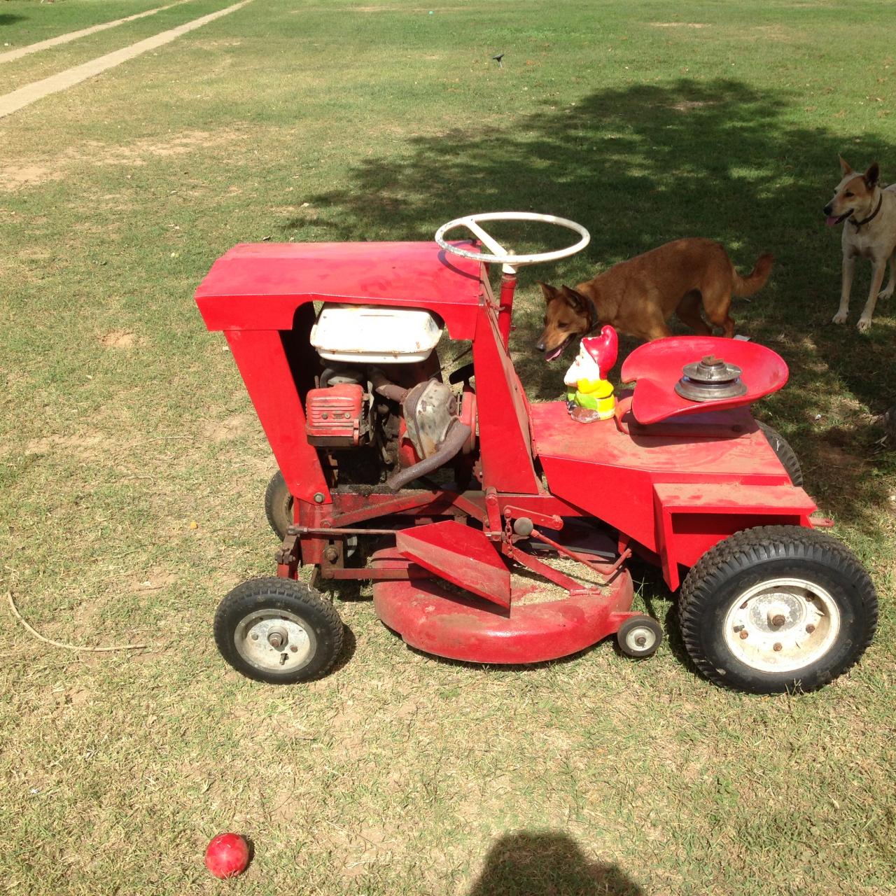

Morning all,
Well, well, well, what have we here?
That 'Red' is interesting. Can we have more photos of this one please. Firstly it's a straight rail machine but the real interest is in that it has the RHS front axle pivot which I think is the earliest type of axle and has the steel steering arm which is also the earliest type. But the machine has the one piece rear drive cover (the cowl that the seat is on) which is the later design and the bonnet is hinged above the upper deck arm pivot point which is also a later model thing.
Noticed too the pulley/clutch assembly on the seat. Can we have detail photos of that too? gml and I have worked out that the earliest machines had a slightly different setup here too. Also has the early hand brake setup.
Very interesting machine. Is that a G65 engine? If so, I'm suggesting we are looking at one of the very first G65 machines.
Definitely more photos please.!!!
I'm also mildly curious about the tractor 8 in the first photo as I've not seen that cowl style before (without the white headlight insert or that decal style).
Also, this thing about your time as a technical illustrator.....?
PS and NB!: given that this is a straight rail machine and an early bird my call about the belt size may well be wrong!!

The red one lives 20 klms from me and I dont own it but I can get more photos. Theo Reinhold designed this mover after he was ousted from the Rover Mower Company. I used to see him every working day for a couple of years and he told me many stories about building this model. He has passed on now so all this information is limited to those he told the stories to. The parts were made by company in Springwood Brisbane Queensland and he put them together virtually hand built awaiting the motor before the sale. My memory has to go back 36 years but anything I can find I will let you know.

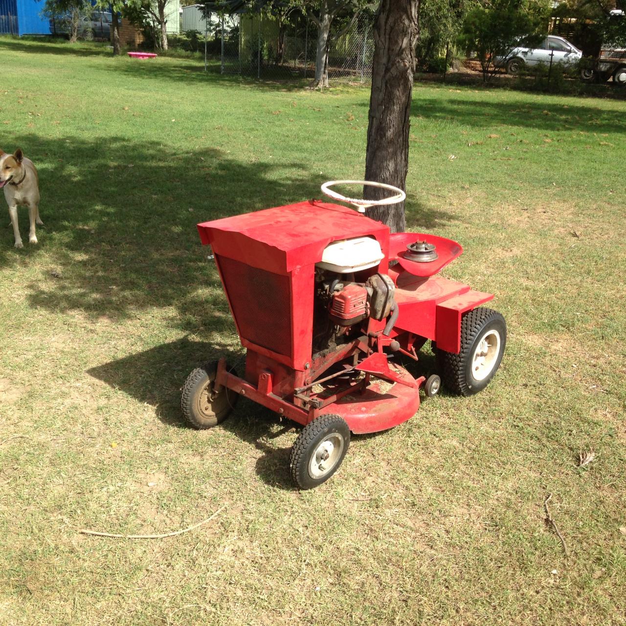

Here is a side view of Big Red. I will keep working on getting more photos

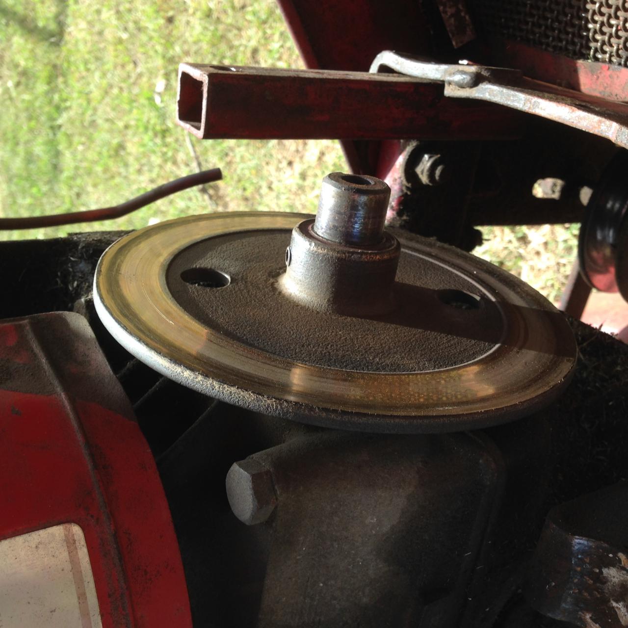

Joined: Apr 2017
Posts: 35
Pulley from big red. Note clutch built into pulley. I believe belt runs to cutter pulley and another belt goes to forward reverse pulley system.

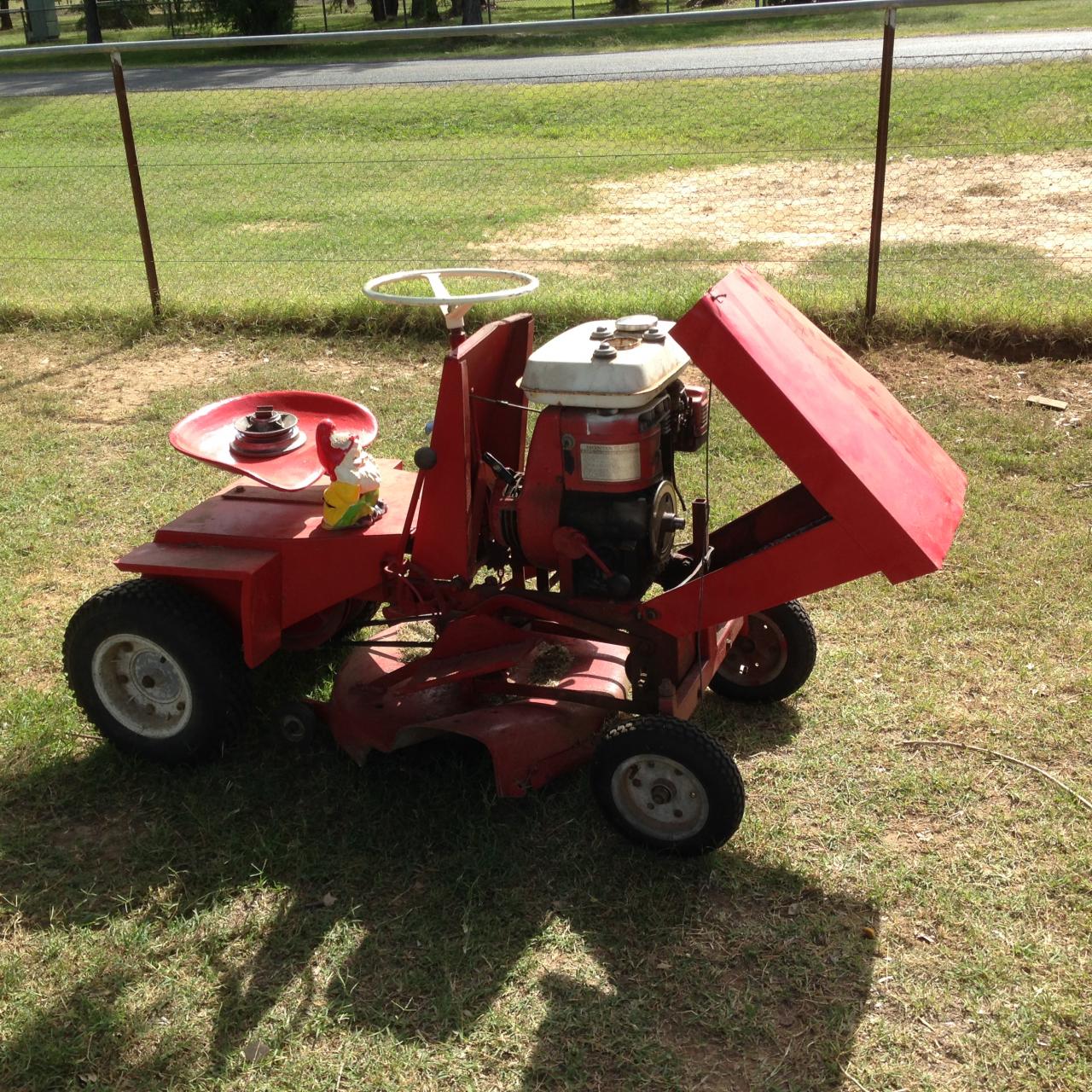

Here are some more views of big red. If any more are required I will have to have a trip to town. I will try to get some photos of the yellow model that followed Big Red.

Morning geenhorn,
Thanks for the extra photos. I can't make out the engine size on the engine data plate but the third photo shows very well the way the steering wheel sits high which leaves little doubt it is a very early g65 machine. Rare and worth hanging onto.
And for certain my call about the belt size is going to be wrong as it was based on a dropped engine machine. Not sure how to establish the correct belt size. To date I've not seen a parts list for these very early machines.

Ah, I see from my ol' Super HD8 cattledog that you are referring to the Honda clutch pulley assembly.

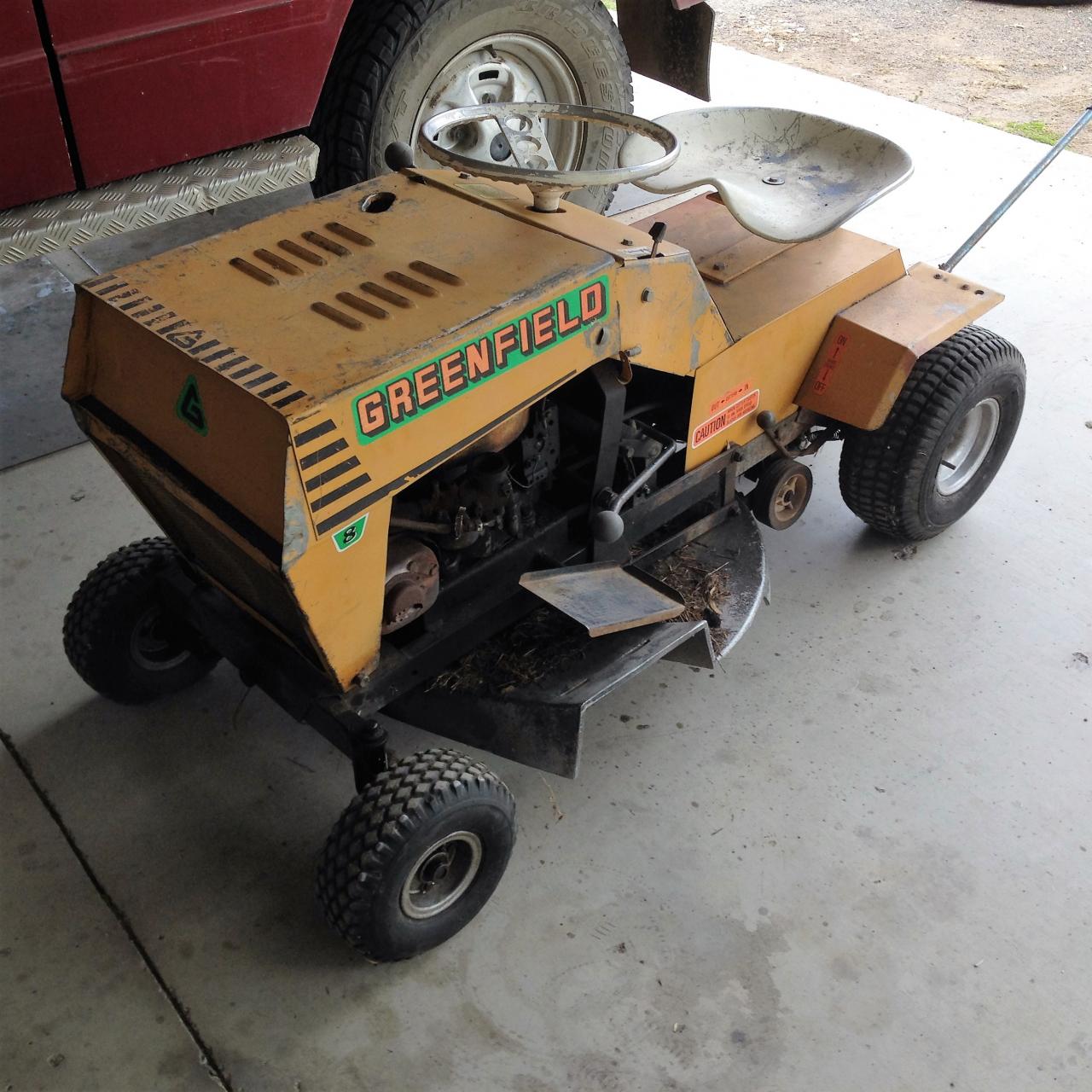

My Yellow tractor 8 with no aluminium nose cone needs a rear axle as its axle fatigue cracked through the weld. I rewelded it but hard to get true. I would also like to know its year and what it is called. [Linked Image]

G'day geenhorn,
I guess it's a Tractor 8 but it is intriguing. I've not seen that front end without the white insert or that style of decal before. Also the rear mugguard and associated transmission cowl shape is different - more like that on the later version of the HD8 (i.e the HD8 with the same body shape as your white one but with the forward sloping mudguards) and not entirely the same as PhippH's machine. Also the rear tyre size? Perhaps there is a chance the engine is original and so the code may be a pointer to date. Also, the tractors I've seen have a 4 digit serial number (sometimes followed by a letter) stamped on the top of the front axle beam mounting channel. I'd be interested to know if you have this number and what it is.
I'll check on the axle but I've already given away a couple locally, one is broken like yours, one has been badly repaired for the same reason, one is bent,........let me get back to you.

The non aluminium nose cone has to be after 1983 but should be within 2 years after the date as they were talking of getting rid of the nose cone in 1982. These green decals were used in 1981 onwards. Its chassis number stamped onto the axle beam holder is 81800491. The motor assuming its original is 8hp B&S I/C and is 319cc and yellow air cooled cowel. It was seized but removal of the plug and WD40 spray in bore freed it up. I will get the engine number after I pull engine out.
Rear axle has been rewelded by myself. It was slightly bent after weld but I ground out the weld on the 91 degree side and put lots of weld in and let it cool. Presto, now 90 degrees so I will use it to get it going at least. I wonder if you can run tubeless tyres with these original alloy rims. I am a metal polisher and one of the rims has had sparkle added. I think the mower may restore well as tinware is very good order.

Getting back to the 1966 Red Greenfield, owners have bought belts, a 66, 67 & 68. A 68 is recommended in the parts book but on the machine it slips due to not enough adjustment. I think that the V shape in the pulleys have wear that needs a smaller belt to cope. Any comments would be welcome.
Posts: 282
gml Offline
Greenfield Enthusiast
evening all,i will be hunting for belts for my old red shortly, i think i will go to a industrial belt shop and see what i come up with,i have nearly finished cosmetic resto on my g40,

geenhorn, That Tractor 8 of yours still intrigues me. I was out with the wrecking pile and looking at the bonnet of one of the anniversarys that I've got and started thinking. The anniversarys (at least some) had the aluminium insert so they were using the insert up until 1987 at least? Also it has a similar '3 stripe' decal just behind the insert in a similar style to most of the Tractor models I've seen.
The serial number is also interesting and is completely different to any other Tractor model number I've seen. In fact it has a similar number of digits to the HD8's.
I'm still wondering if it is a very early Tractor.........

Did your mate with the red beast get the belt problem sorted? There is a lot of adjustment in the slot that provides the tension adjustment (adjusts the position of the shaft that the pulleys under the front of the engine ride on) and so if a B68 is too big then a 67 should fit.
However if the problem is that the belt is sitting so far down on either the engine pulley or the cutter deck pulley that the belt is riding in the bottom of the groove rather than up in the vee, no amount of adjustment will help. This indicated by a 'wear shine' in the bottom of the pulley groove. Pulleys with less wear are the only fix.

Hi prd & gml
The belt that worked best was the B66. He let me mow half an acre with Big Red, wow I rode on a 51 year old Greenfield. You could smell burning rubber though. By the time he did an acre the belt was history but still left a beautiful finish. He intends to get a kevlar B66 belt for replacement. I will keep you in touch. Belt size was given to them by a Greenfield employee who said the parts book stated B68, and B68 does not work with worn pulleys.
