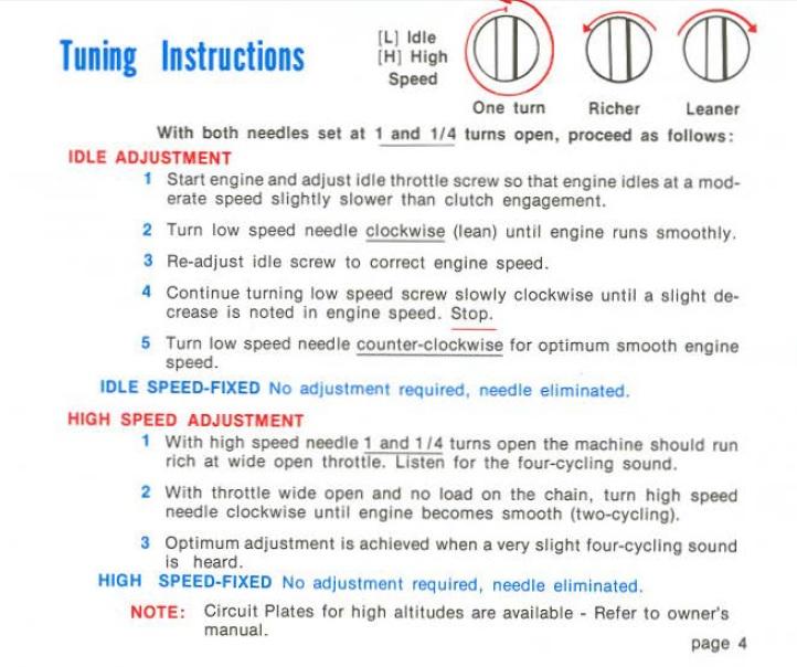

Why did you set the idle mixture screw to 1 turn? For the WA, the manual says start with both idle and high speed needles set at 1.25 turns. At that adjustment the H needle should be somewhat rich, and when you tune it properly you'll probably end up at about 1.125 turns if the metering lever height has been set accurately.
Getting those little engines to idle is an art, especially if you have the bad luck to have an engine with a slight crankcase leak, though in that case it will probably be quite difficult to start as well. Just set the idle speed high at first, and follow the instructions. These are for the WA:

Walbro are normally preset at 1-1/2 both L and H and fine tuned from there. First make the metering lever is set at the correct height. The W tool makes it easier but it normal even with the small valley it retracts into for the WA/WTA/WT carbs.
Set the L mixture to best idle speed plus a tad richer then adjust the H speed for best top speed but don't exceed max rated rpm. If it wants to do this enrich the fuel to limit the top speed.
