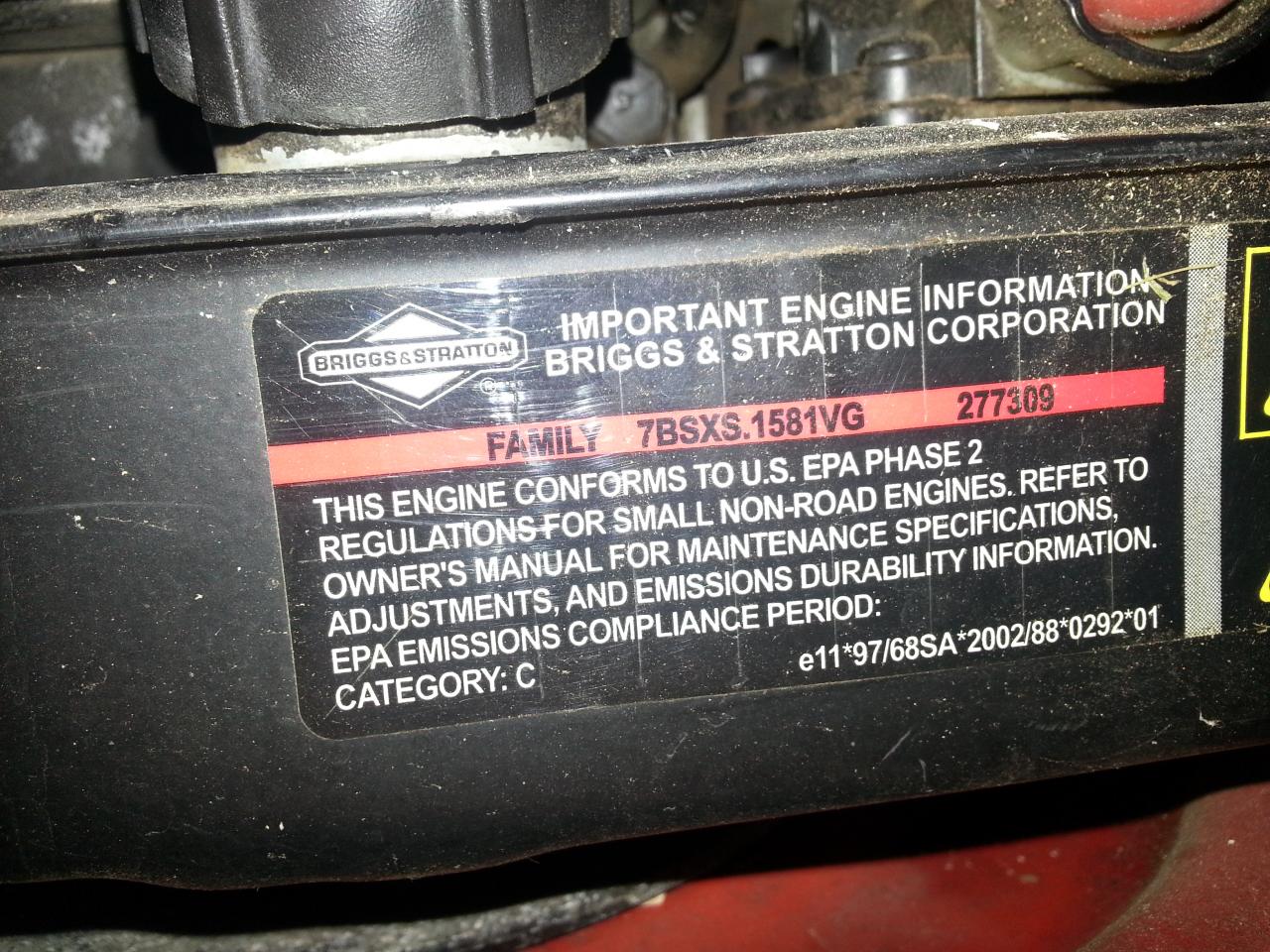

I am attaching few more pics I took today morning. Not sure if the shall be helpful but may help figure out where it was made.
