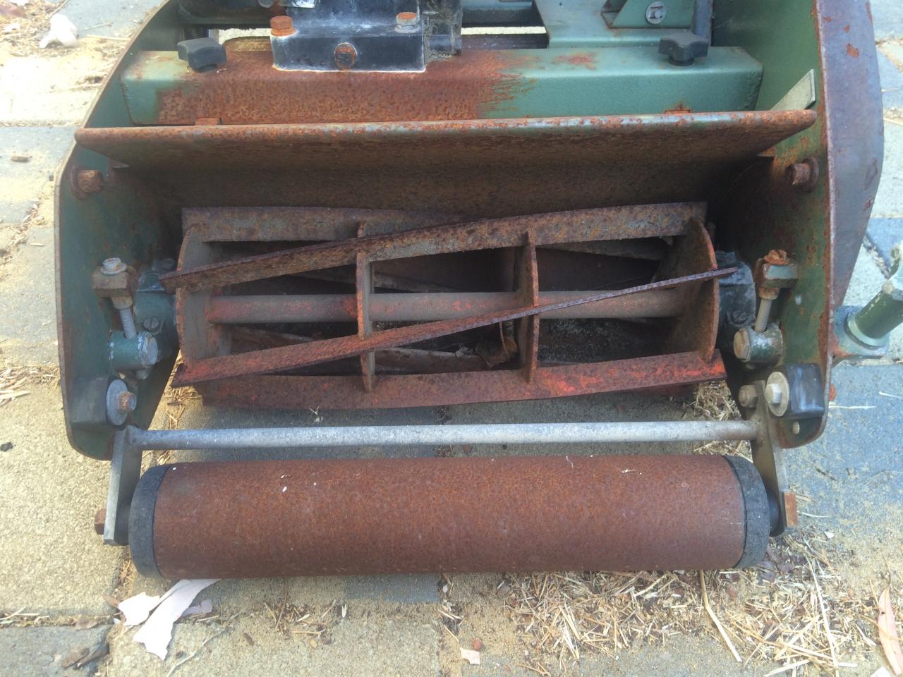

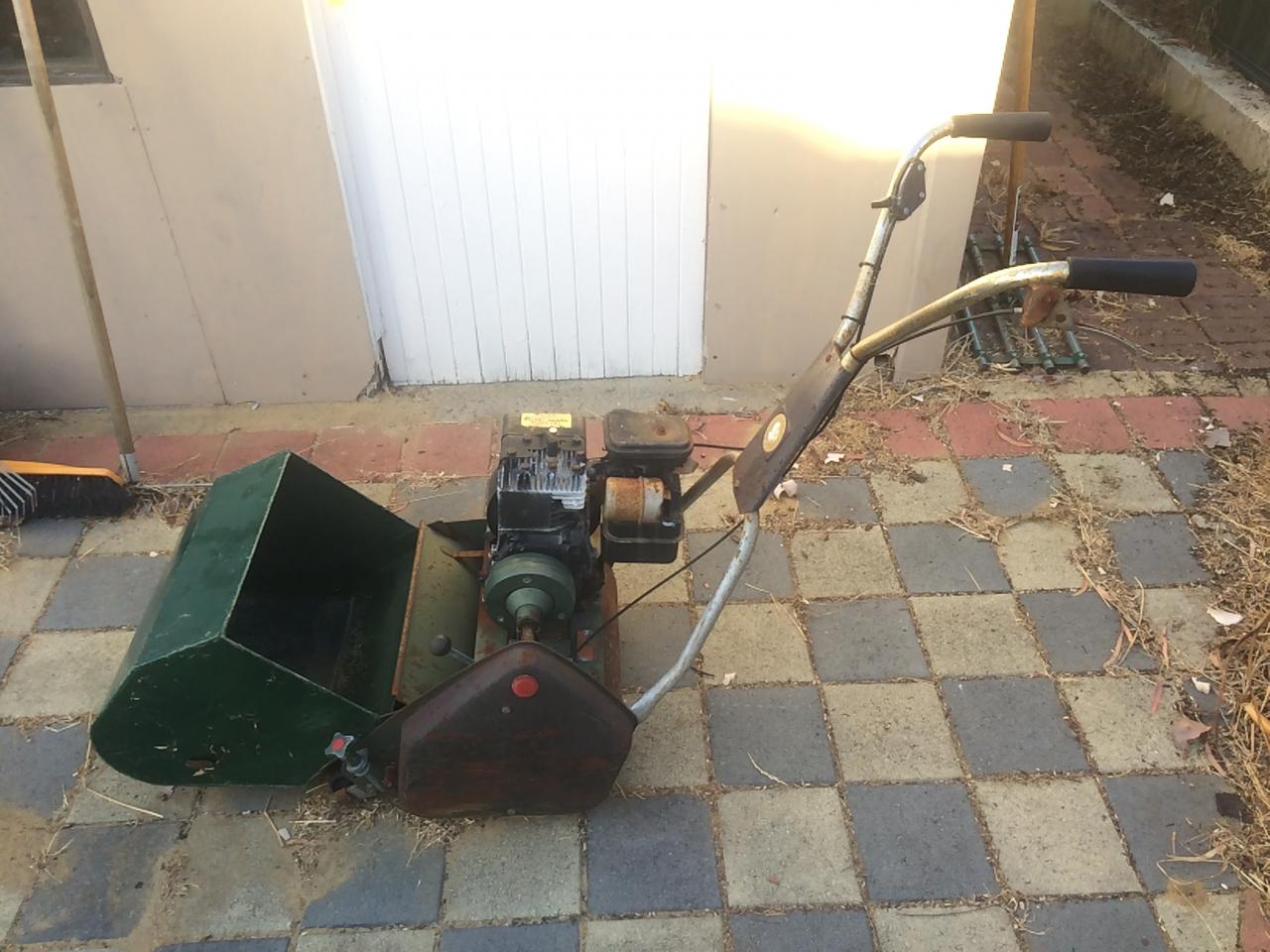

Just saying g'day and posting a couple of photos of my latest verge side collection. My neighbour was kind enough to pick this little beauty up.
She�s currently not in working order but I plan on doing a least a bit of restoration..
Can anyone please provide a bit of background to year, all original parts etc.?
Cheers Hooksey

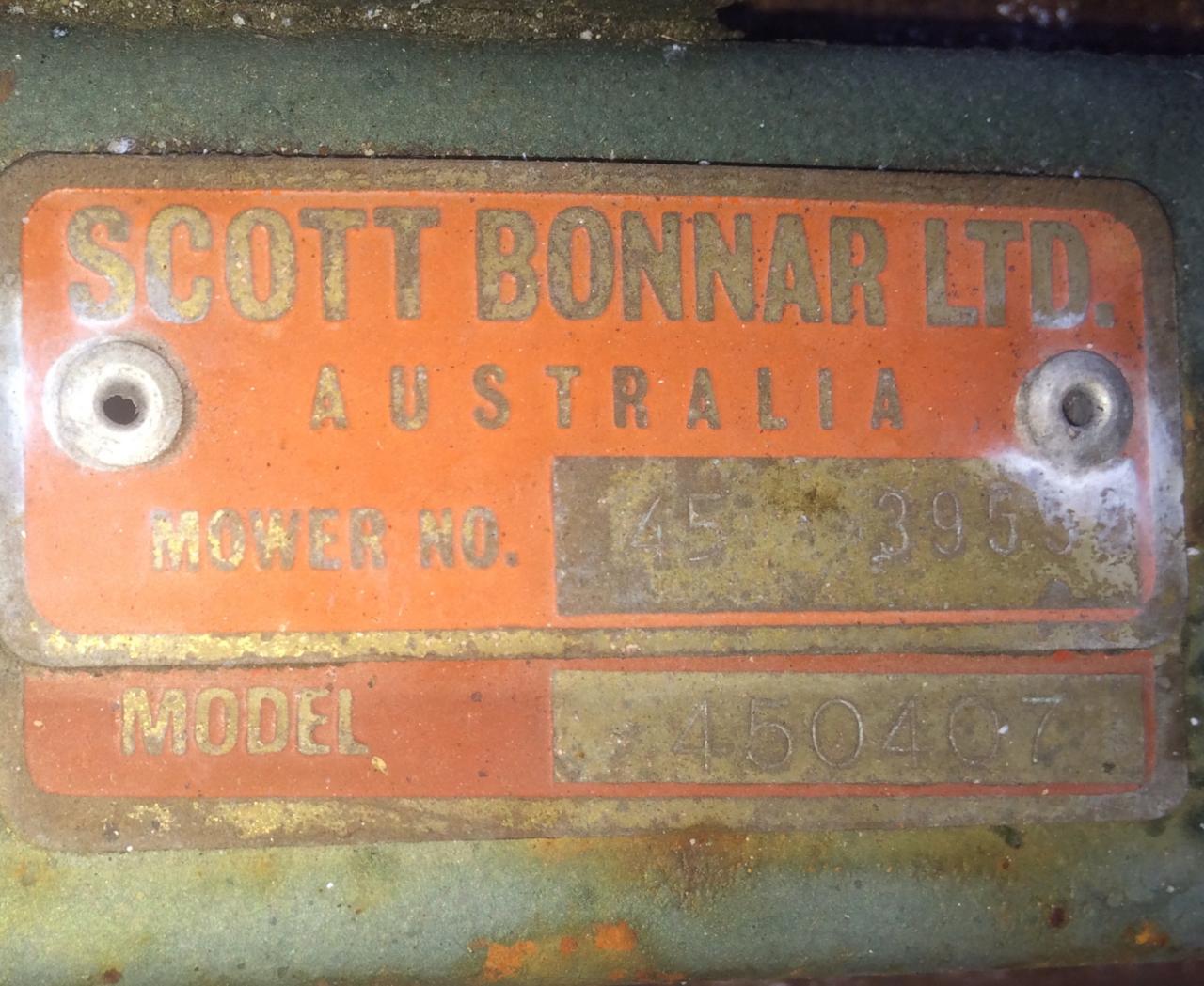

Hi Hooksey, and a warm welcome to the forum.It's nice to welcome another Scott Bonnar Model 45 owner on board. grin
Your machine is a 14" Model 45, manufactured in the Thebarton Sth Aust. factory and would have been made in late 1974-1975 and it is featured in the model range for those years (Model 450407). It would have had a Kirby Lauson (Tecumseh) engine fitted originally and is a Series 2 chassis have the twin rail engine deck.
It has been fitted with a Briggs and Stratton engine at some later stage; if you can post the complete string of numbers stamped into the metal air cowling (adjacent to the carby inlet manifold) that should read Model, Type and Code, we can tell you the date the engine was manufactured. wink
Grumpy is our resident Briggs engine guru, and I'm sure he will chime in here and give you some ideas on how to get it running sweetly.
In my opinion, this machine would make a nice restoration...once you get the engine running, I will help you with any faram and chassis probs. wink

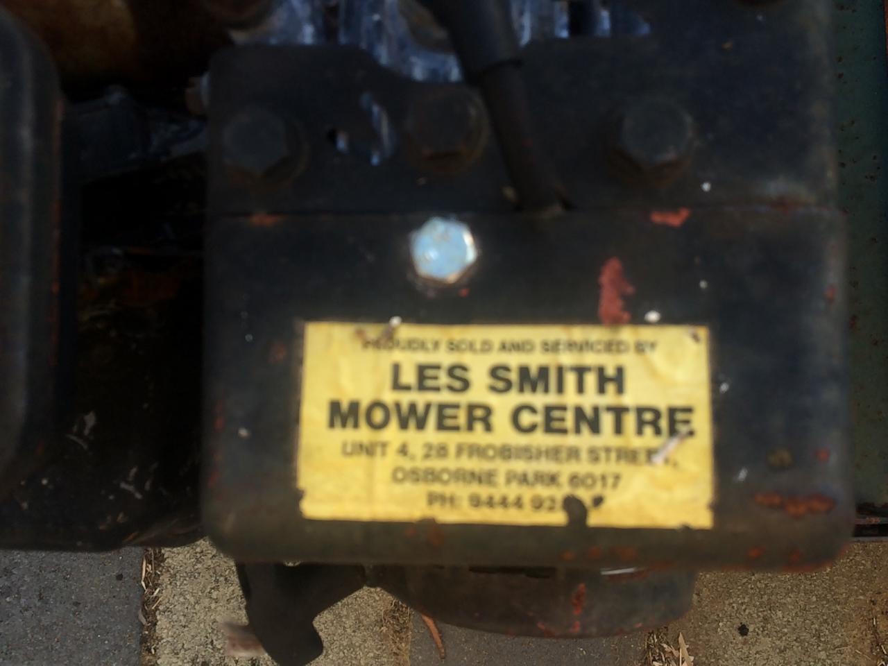

Ive had a good look at the engine and i can't seem to locate the string of numbers. Would anyone have a photo that can direct me to where exactly i should be looking?
To the left hand side of the Les Smith sticker follow the cowling down a little bit and look towards the rear edge of it and you'll find a series of numbers stamped into the sheet metal.

I'm not sure if it actually had a Kirby fitted originally as it has the lower legs on the handle bar bent to suit the rear mounted tank on a Briggs engine. The Kirby fitted machines didn't require this as the tank was forward mounted, thus having straight lower legs.
Please correct me if I'm wrong.

Hi BB, from my records, the model 450407 was originally fitted with the Kirby Lauson...whether this machine actually was....remains a mystery....as it has a later model Briggs fitted....
You are correct about the lower legs...but I have seen another machine on this forum, with supposedly the original Kirby, had the bent lower legs of the Briggs version.
Maybe when the machines were erected, they just grabbed what was to hand... wink
Yes you are probably right, without knowing someone from within the SB factory that actually had an interest in what was going on we'll probably never know so many things.
I must admit there must be someone still alive that worked at the Thebby Factory.
Hi BB, yes mate, there probably is...It is a shame that their not a member of ODK, we could surely pick their brains.... wink

Well the Engine was made on the 10th of August 1981 so that sadly doesn't give us the correct date. One thing that is odd about this machine and that is it has the Rover-Scott Bonnar Catcher rubbers fitted which is strange.
I'm starting to wonder if this machine has been repainted at some stage as the bearing housings on the reel have also the same colour on them as the chassis when they should be in fact natural die cast, but that double ID plate arrangement is earlier than Rover Scott Bonnar days..............

Looking over the photos again, I feel that the bolted on catcher rubbers were the result of a previous tenants 'improvements'. Maybe one of the spot welded lugs separated from the side frame, and they decided to change both to bolt on....
It is definitely an early Scott Bonnar Model 45, Series 2 twin rail chassis, as evidenced by the double riveted ID plates, and I agree with you that it has had a repaint at some stage as well as a after-market (or homemade) catcher fitted.
It appears it has had a hard life...but can be restored to its former glory with a little TLC. wink
