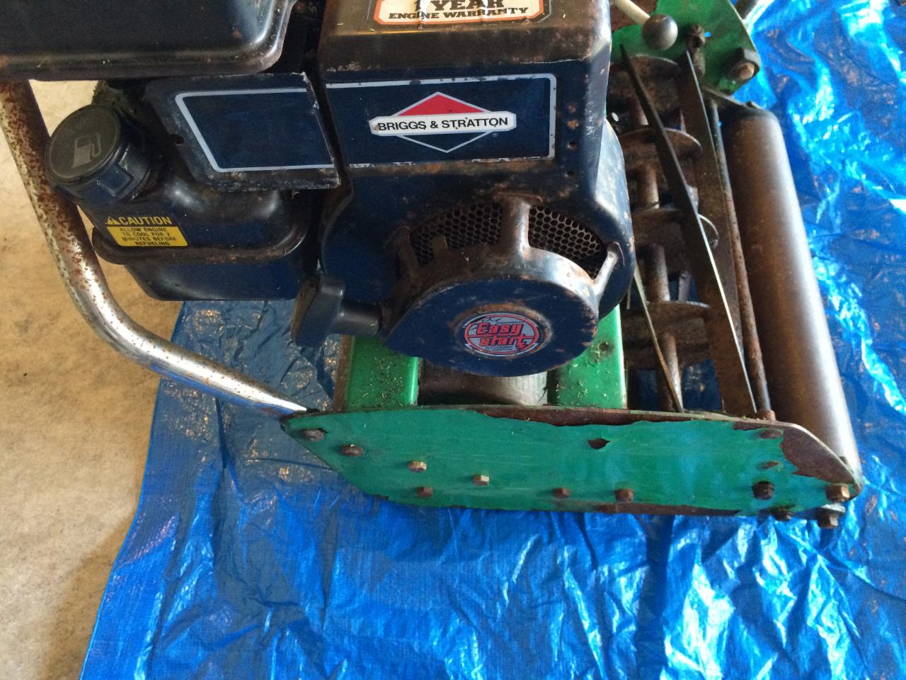

Purchased a Scott Bonnar/Rover 45 Cylinder mower (5058) just the other day and she needs some work.
Before I go all in spending up $$$ keen to get your opinions. I am in for $50 thus far.
My first stop after purchasing it was the local mower dealer/service centre. I was advised the crack in the chassis along with a "bodged clutch housing" made it un-economical to repair.
So after doing a bit of research and stumbling on your website I discovered the crack in the engine mount/chassis is common to this model and not a death stroke as advised. (nothing a bit of welding cannot fix)
The clutch housing and captive cotter pin he referred to appears to have been replaced in later models with 2x grub screws as evident in mine;not a bodged job at all.
So after a bit of research I was feeling slightly less despondent about my new purchase. Time try her out........she cuts but not particularly well; those pesky weeds bounce right back up, and the mower it self shakes like a leaf leaving a slight Ali feeling in the arms.
Alas here I am, not a mechanical bone in my body but keen to try my luck on my first repair/restoration job.
Starting with the chassis as you can see from the paint work or lack there of it's definitely had a neglected life. A mate who owns a fabrication business will assist with sandblasting, welding a painting it.

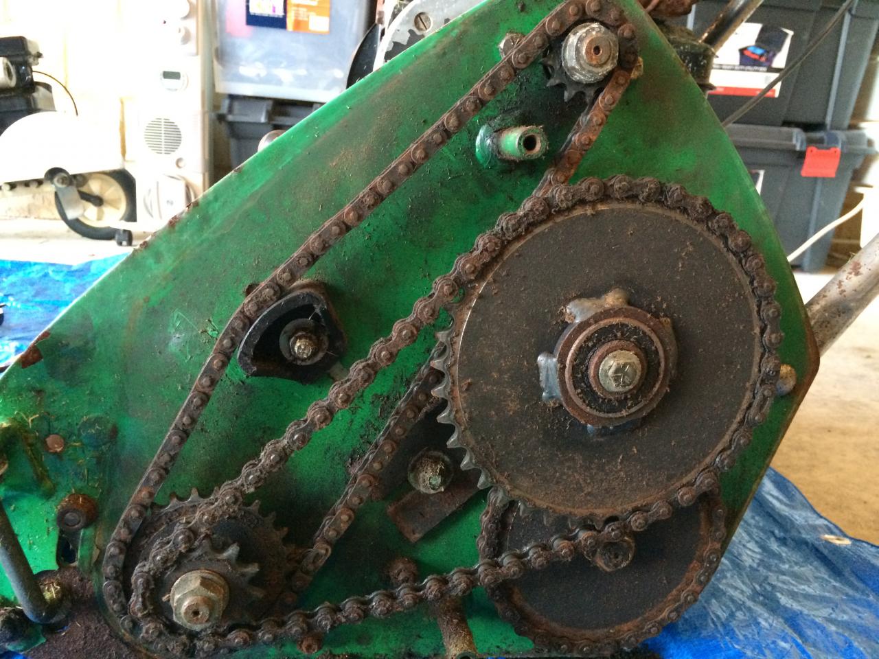

The sprockets and chains are heavily gunked up and I plan to clean once I now how to remove them. (need to buy a 3 prong sprocket remover as shown in Deejays video; are these expensive and where can I source) (Is soaking in degreaser and cleaning with an old toothbrush ok?)

Hi Chris, and a warm welcome to the forum. Its nice to have another Rover-Scott Bonnar owner aboard, as we all like to learn new things and tinker here. grin
From what I can see in your pics; (and many thanks for posting good, clear pics) here are my observations.....
Your machine is a 17" model, manufactured at the Rover factory at Eagle Farm in Brisbane, sometime in early to mid 1989. Your 80202 engine was assembled on the 26th October 1988 at the Briggs Rolla facility in Missouri.
The cylinder reel has heaps of life left in it; it looks to never have been ground.
The chains need to be removed and soaked in degreaser to remove the gunk...just take out the removable links...just like the chain on your bike when you were a kid! Lol!
The 3 leg pullers you can get from an automotive shop and are not expensive.
The top (small) engine shaft sprocket will have to be replaced as it is badly worn, as is the double cutter sprocket, you would replace the primary chain as well at this time so as not to ruin the new sprockets. wink
All the other sprockets appear to be serviceable.
The grass deflector, deflector clamp screws and associated hardware appear to be missing, you will need to source new or second-hand ones as the deflector is what put the grass in the catcher. wink
All in all, a great score for $50.00....you will need to replace the cylinder reel bearings, perhaps the bedknife (bottom blade)...replace the double cutter and top sprockets, get a new primary chain, deflector and hardware, get the reel and bedknife sharpened; clean and grease the chains and mechanically you're in business!
As for stripping and painting, just follow my video to remove the engine etc and when you get to that stage, just post here and we will help you though the next stage. wink

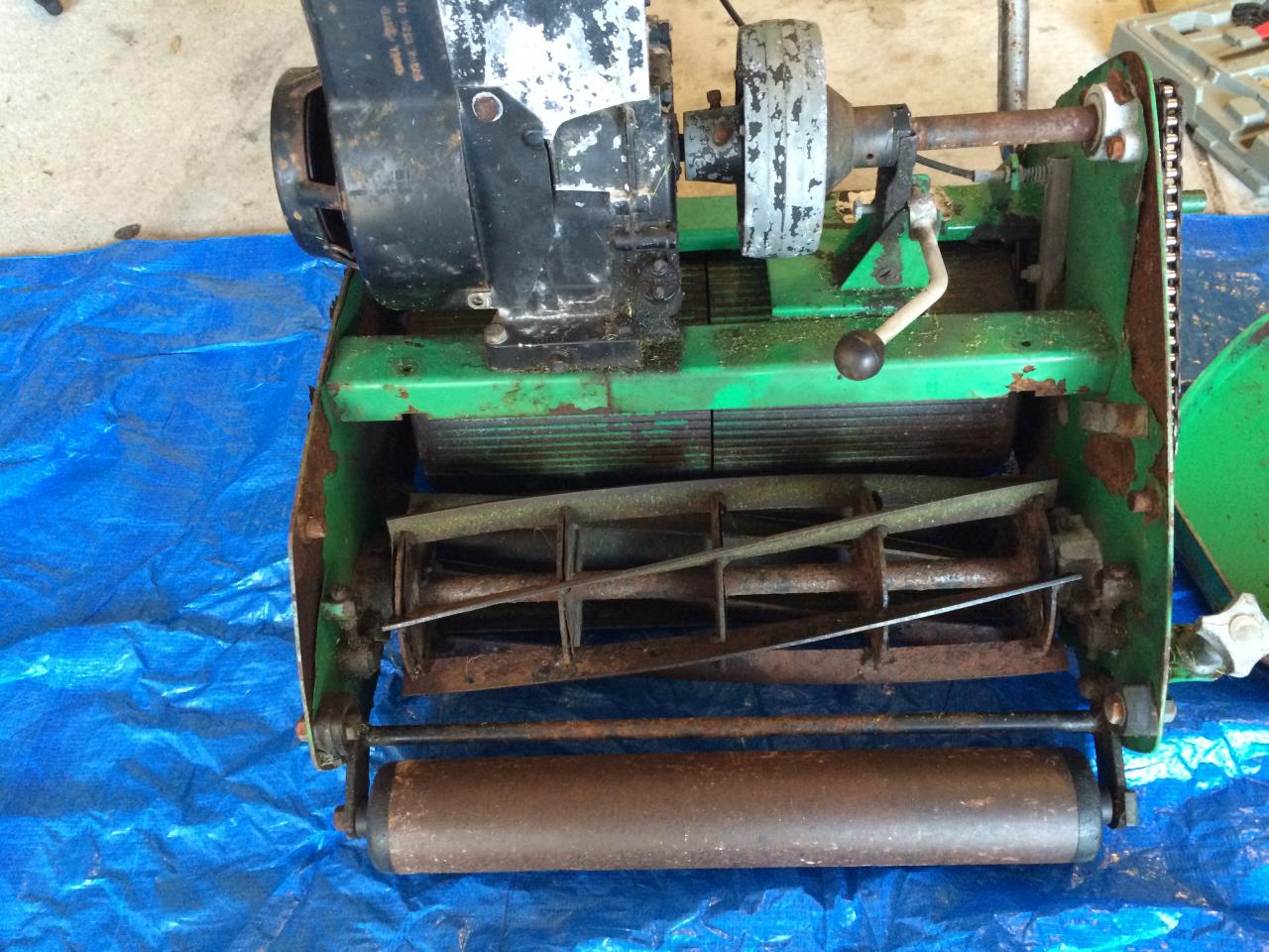

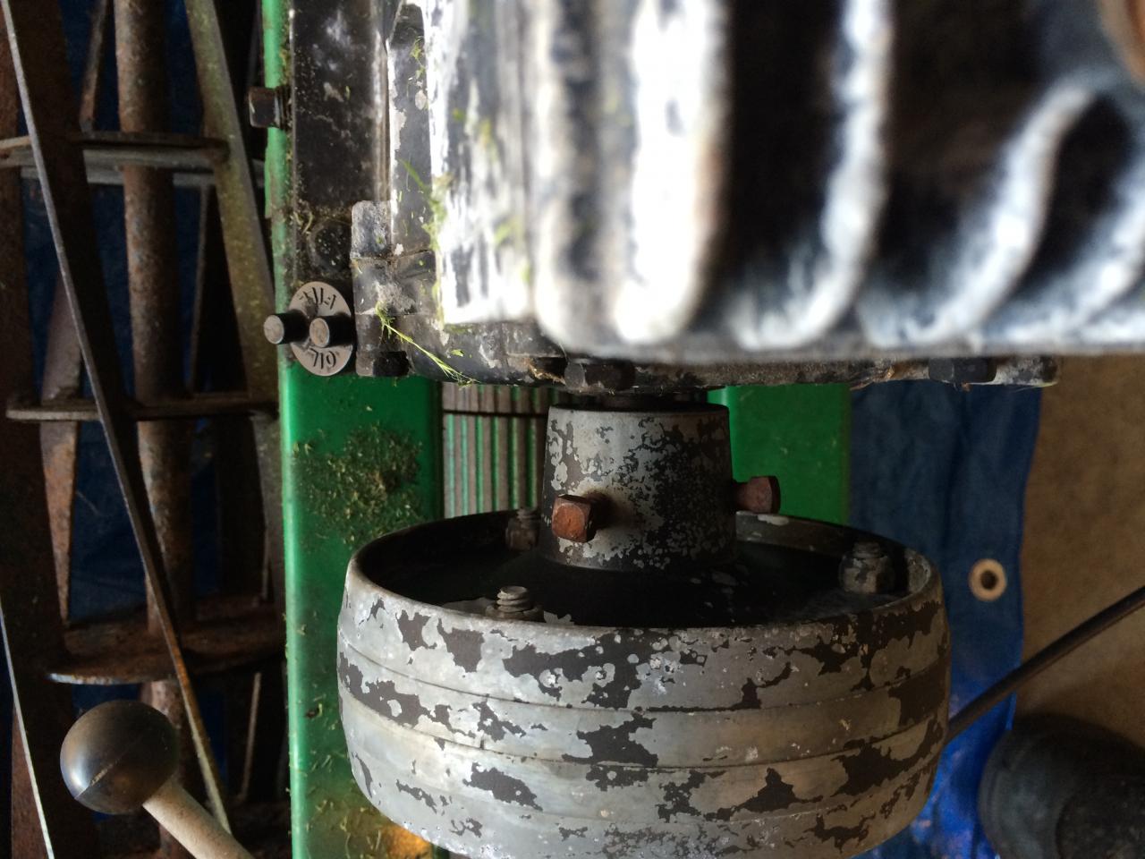

Hi all,
Thanks Deejay and Grumpy for your assistance, Deejay your videos made removing the engine, cylinder and bed knife easy!
Apologies in advance as I am no doubt naming the components incorrectly.
Hoping you can provide some further guidance removing the
"Front roller"
"Small engine Sprocket"
"Large Sprocket"
"Medium Sprocket"
"Clutch Cable"
"Drive Shaft"
"Rear Rollers"
Also the cylinder bearings aren't coming off, can these be "wedged" of [Linked Image]
f with a screwdriver ?
I have attached some pictures so you know what I am referring to.
Once removed I will be sending the following off for sand blasting and powder coating
- Rear Rollers
- Chassis
- Front Roller
Can the drive shaft and clutch assembly be sandblasted and painted or is it better to hand sand and spray paint ?
Hi ChrisUzA, I have been busy with family stuff all day, but I will give you some guidance in the next day or two, you will find it all easy...Don't for get to take plenty of pics along the way....It helps you to put it together again!. grin

Deejey mentioned the small engine sprocket and the double cutter sprocket along with a new primary chain. (There is a local retailer in Perth seeling for
$59 - Small engine Sprocket
$92 - Cutter Sprocket
$30.95 - Chain
Do the other sprockets look ok ?
I am hoping the above plus some new stainless nuts and bolts to replace the severely rusted ones along with 2 new cutter bearings will be all that's required.
