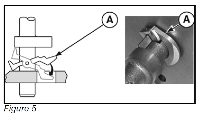

Here is an illustration (from the manual) of the compression release on the Vanguard and Intek engines:

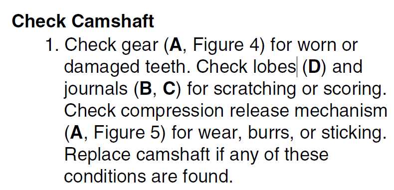

As you can see, the compression release consists of a stamped piece of steel, sitting on-edge, which protrudes slightly higher than the cam lobe at a point halfway through the compression stroke. Briggs indicates that there is a possibility of this component wearing out or sticking. Here is the instruction for inspecting the camshaft:
Before considering dismantling the engine to replace the camshaft, you should perform a simple check on the decompressor. Look closely at the rocker arms while slowly turning the engine by hand, with the spark plug removed so it is easy to turn. Watch for one of the arms moving momentarily during the compression stroke. If the clearance is correct and neither arm moves, the decompressor is kaput.

If it runs properly when you do that, it is pretty clear that there is nothing wrong with the engine except that the decompressor isn't working. At that point, I think it will be necessary to remove and inspect the camshaft and tappets.
