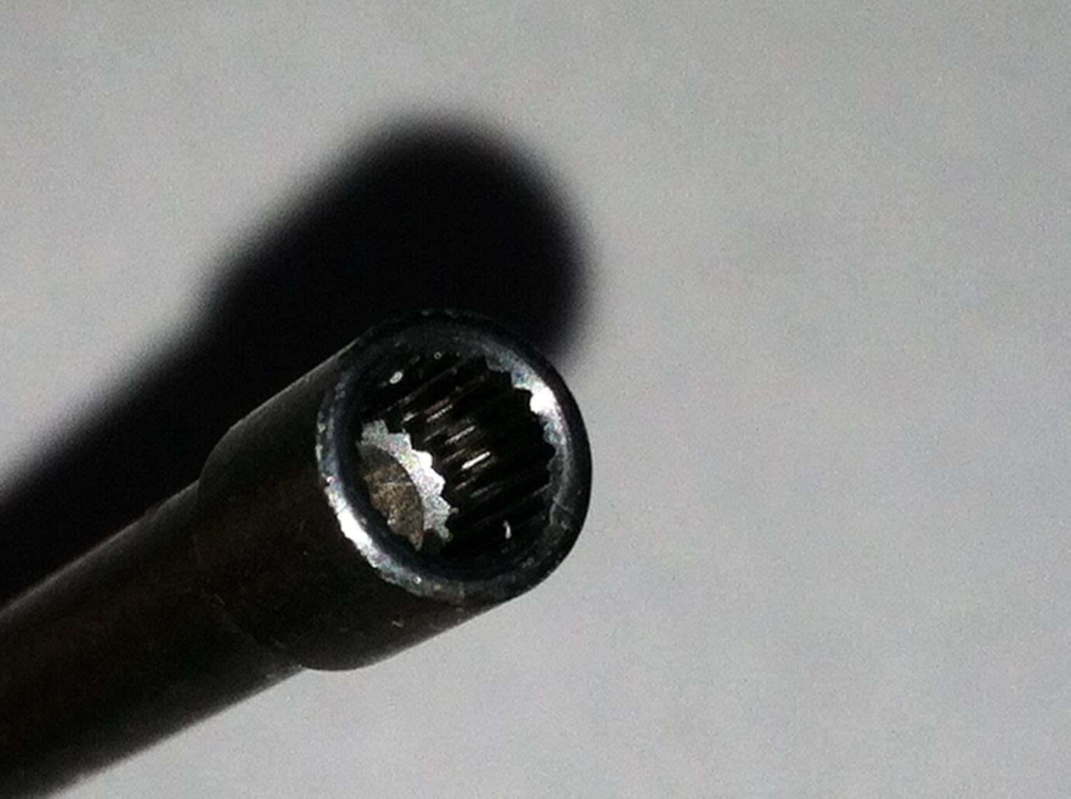

You can see an image of a standard Husqvarna carburetor adjusting tool here:

You may find you need to install a rebuild kit, when you get into the details shown in the manual. (You certainly will if you have to remove the Welch plug, of course.) Also, when you come to adjusting the mixture screws, you might try a trick others sometimes seem to use, with moderate success. Find a piece of thermoplastic tubing with an ID about the same as the root diameter of the splines on the screws, heat it up, push it over one of the screws, and let it cool. Then you hopefully will have a tool for making the adjustments. Depending on the quality and wall thickness of the plastic tubing, it may last for years, or it may die during this current project, but you can always cut off the last quarter inch of tubing, heat it up again, and proceed from there.

Hi Grumpy, thanks for the manual. To start off I cannot find any numbers on the carby what so ever except for Zama C1T, it does have different numbers on each arm,choke arm throttle arm etc, it is simialar to the top left one with the blue choke arm except my carby has a seperate primer, not attached as in photo. I was able to use the manual as a guide which worked a treat, never even thought about taking the mixture screws out. The idea of a peice of hose was wonderful, worked beautifully on the third peice of hose. Found out the low speed screw had a bit of gunk sitting in behind it, looked like a peice of sand but softer, I'm thinking sale dried out fuel as the chainsaw was sitting for some time. Blew it out backwards a couple of times just to be sure, then through were the screw goes and hey presto nice and free.Followed manual through to the end, put it back on chainsaw second pull it kicked over, just had to adjust the idling screw which I had to turn back off about three turns, now its running like a new one. Thanks heaps for your help and patience again Grumpy, its much appreciated.
