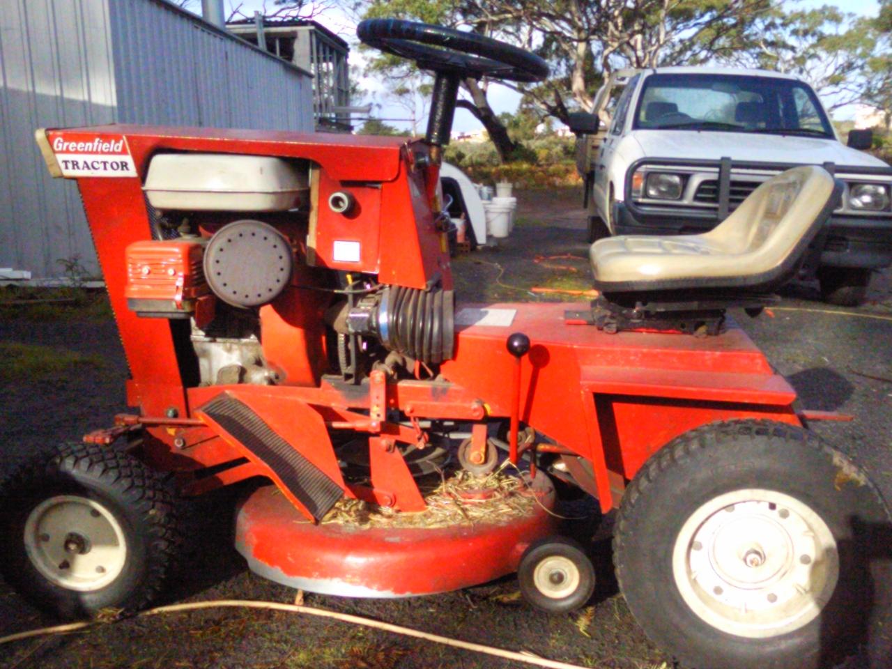

Hello, just need some advice on my early model greenfield, from what I can find out from your fantastic forums she is a pre 1970 model running a G65 Honda. I have only had it for a matter of weeks and runs like a clock. Last weekend while cutting through some rather tough ferns, lamandra (sags) etc I felt an occasional surging motion. It appeared to be transferring from wheels not the cutting disk as at different points I was on already cut areas, Any help would be greatly appreciated. Regards Phil

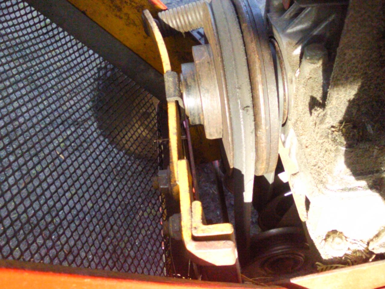

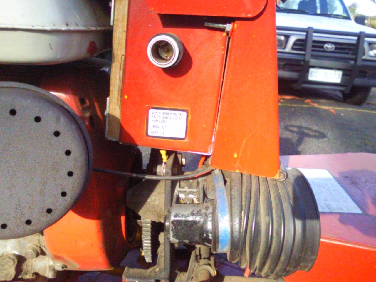

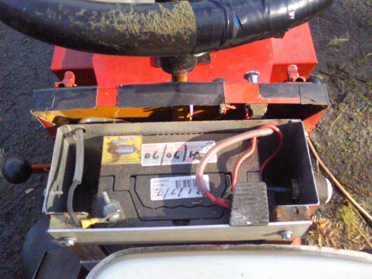

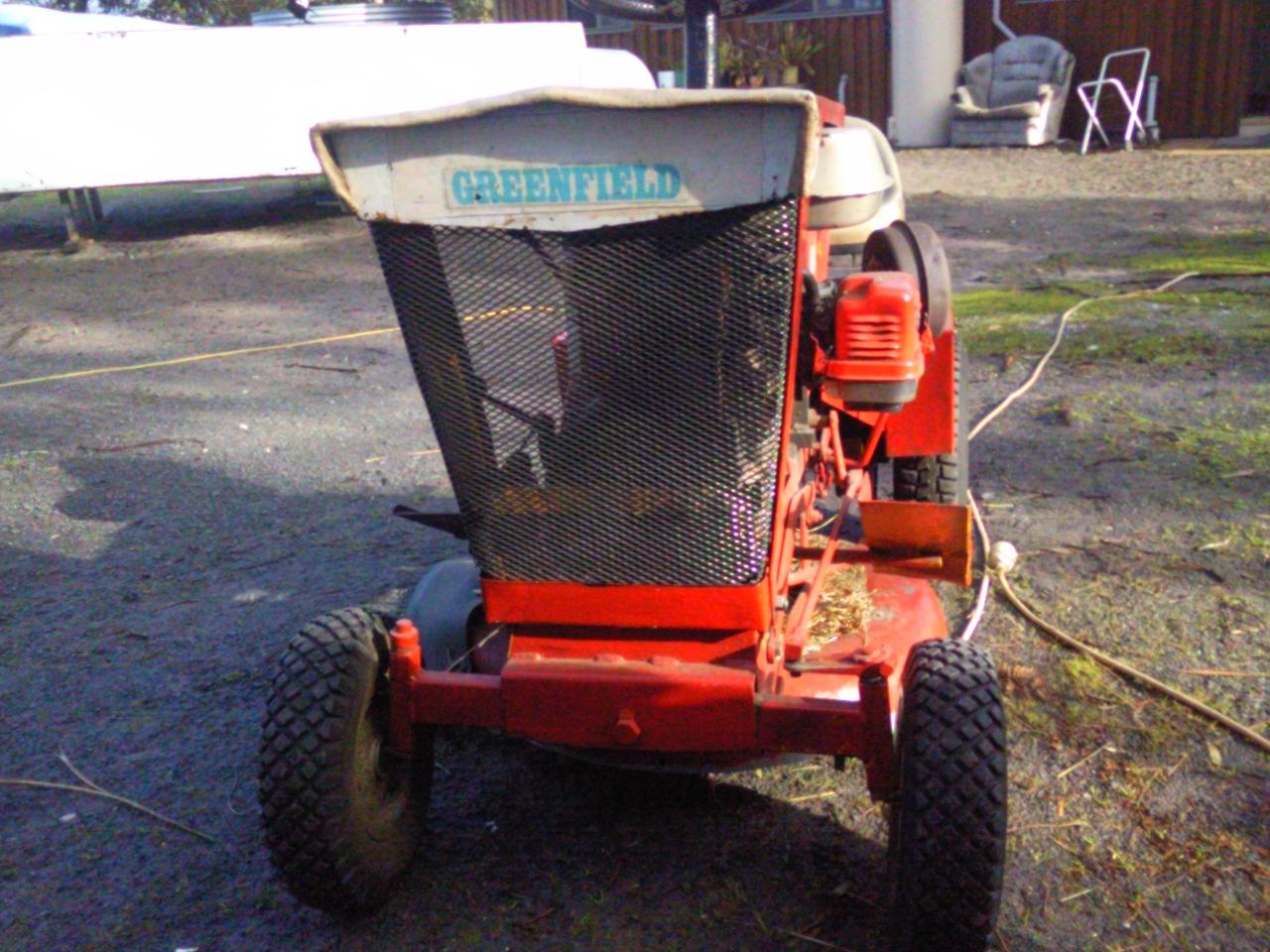

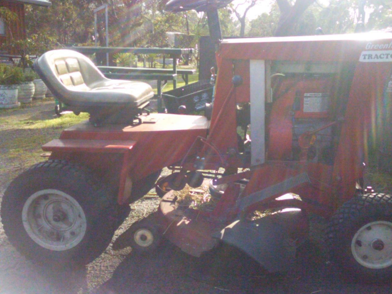

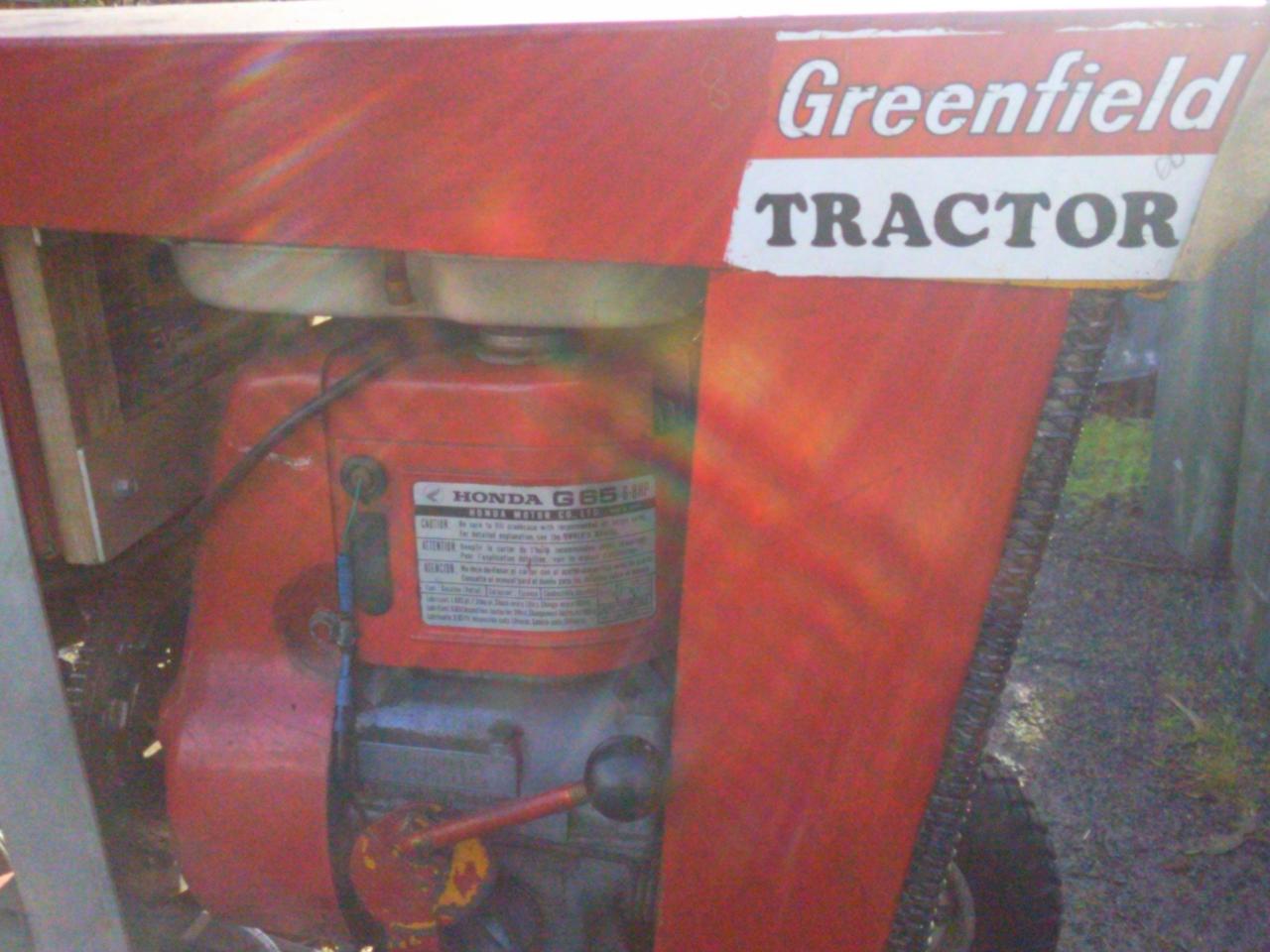

Grumpy, sent these pics. The first shows the general condition, the rear tyre you can see has just had a new tube fitted. I used a wheel barrow tube from the local hardware same size and rated to brick trolley so I thought, why not at $8.99 against $17 for genuine. Can you spot anything that is unusual with the old girl? Second pic gives a clue. The third is the spoiler. The chap I bought her from fitted this from an old volvo, no alternator no room really, just plug in to the modified battery charger for 4-5 hours after 3 hours running. The socket is just above in the battery box. Back to the second pic, he fitted an old rule (static tacho) for his daughter so she knew which speed to start/drive and cut at. The silver colour pull switch next to the bonnet clip gives current to the starter and the black rubber one is the starter. Next weekend I'll adjust the cutter belt and see if that fixes the surge and squeal. Under the air filter box there is an oil tray presumably to prevent dust and dirt etc. from being drawn in. Can you advise me what type of oil and how deep it should be please? I was thinking maybe chainsaw bar oil, thats what I used on the chain. At the moment its about got 2mm in it and is reddish in colour. Phil

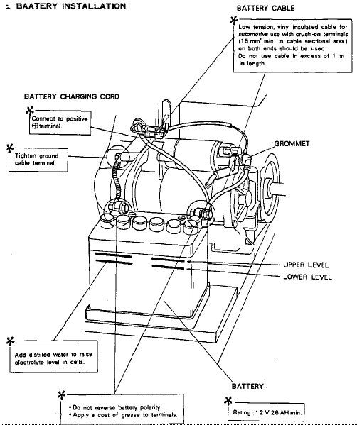

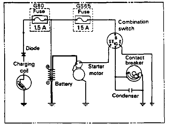

First, Phil: the Honda G65 engine has a built-in 15 Amp alternator inside the flywheel, as an adjunct to the magneto. If it isn't working, I suggest you correct the wiring so it does. Your other wiring sounds irregular as well, but I don't have a wiring diagram for the HD8. Here is the wiring for the engine itself:
Here is the Honda-specified wiring for charging the battery, if that is ever necessary once you correct the wiring:
The other issue is, it is the wheel-drive belt tensioner that requires attention, not the cutter drive.

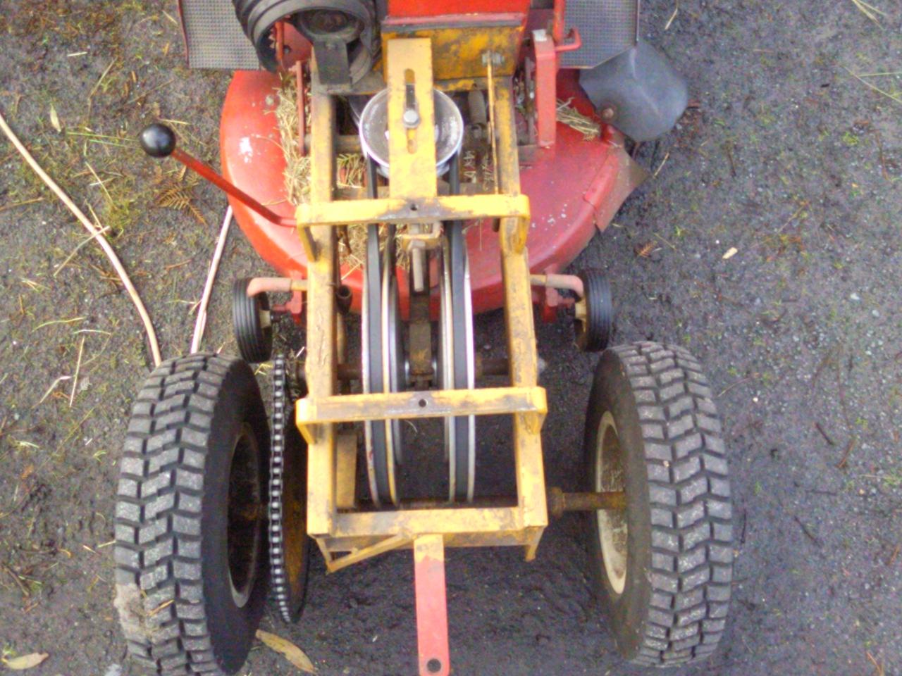

As regards the drive belt tension, the spring-loaded tensioner for this is mounted beneath the seat. This thread has some good pics; https://www.outdoorking-forum.com.au/forum/ubbthreads.php?ubb=showflat&Number=40749&page=1
It's designed to take up the slack automatically, and has a very simple non-return latch, but the shaft can get stuck once it gets rusty. As grumpy says, it likely just needs freeing up, or a bit of persuasion. 'Til it locks into the next notch.

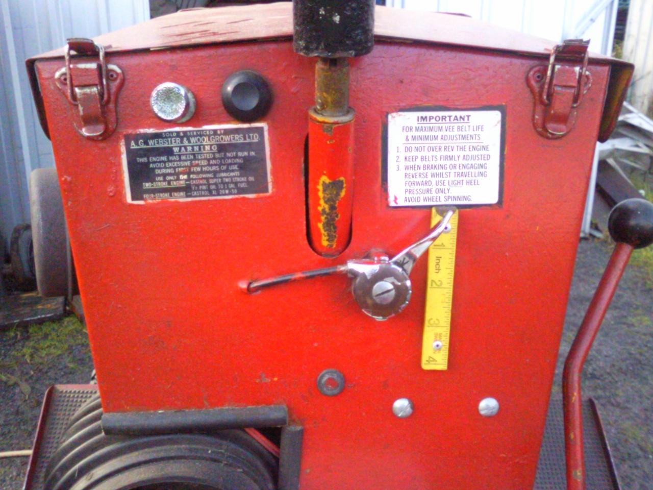

Dunno that the G65 of that era would have been fitted with any 'lighting coil' or alternator. The HD8's didn't have any wiring diagram; all of the electrics were on the engine, including the ignition cutout switch!
Electric start wasn't a Greenfield option in them days - that's quite an ingenious setup there.
When Honda vertical shaft engines came out, and Greenfield went to vertical shaft engines, the new electric start models became much easier to sell to cockies. Meant that the cockie's missus could start the mower and run it around, instead of having to get hubby to come in and start it up.

I can imagine Greenfield buying their G65s without the starter motor, since in 1970 I think that would have been the usual specification for ride-ons in Australia. What I can't imagine though, is why they would then have fitted a battery to a pull-start magneto-ignition mower - it sounds completely non-functional. It is the presence of the battery that made me think this mower started life with a G65 fitted with a starter and an alternator.
As far as the alternator, or "charging coil", is concerned, the workshop manual shows it but I don't see it on the few G65 parts lists that are still available on-line, so it, and the starter, may have been optional rather than standard. It might be best to have a look at the engine, checking for signs of residual wiring that match the engine wiring diagram I posted previously. If any of that wiring is present, chances are the charging coil is still there and can be connected. Alternatively if you have any reason to remove the flywheel, such as to check the breaker points for example, you will see whether there is just an ignition coil, or extra wiring for battery charging.

Grumpy, I will check that out to see whats going on. Just had time tonight for the drive belt adjustment, previous owner did a jury rig to the adjuster as well. No spring just a couple of lock nuts on a thread though the frame closest to the pulley. Would the missing pieces be still available?

I don't know if your adjuster ratchet uses the same parts as on later model, vertical crankshaft Greenfields. One possible solution is to contact Greenfield's service department, in Queensland. If the parts are similar to current ones you have a couple of easy options: get the parts from a wrecked modern machine, or get new parts from Greenfield. If the parts are considerably different, you could post something in the Outdoorking Wanted forum asking if anyone could help. If even that doesn't work, you could contact Rodeobob, a member who owns 3 HD8s, none of them complete or working, and see if he can help with some parts.
On another subject, if you look at the pictures in Rong's thread (a link to which has been posted twice previously in this thread), you will see that the HD8 is not supposed to have a battery or battery box: that is one of the previous tenant's improvements. I do not know if there is some other extraneous wiring on your machine powered by 12 volts, or if alternatively the previous tenant was a bit confused and installed a useless improvement. Perhaps he wanted an easy way to carry a battery around his property, in case he needed to jump-start a machine somewhere remote from the homestead?

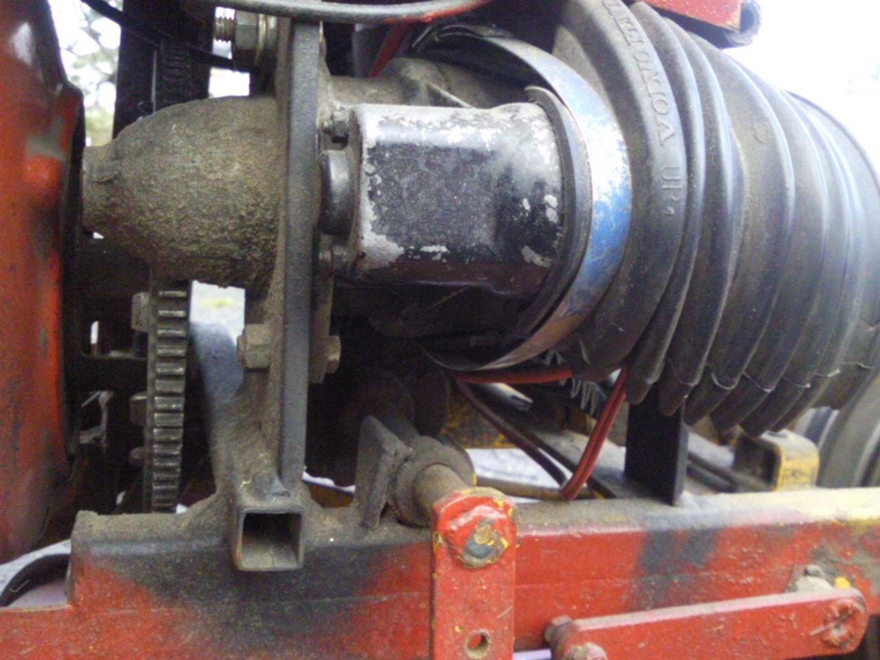

Even though the OP [phillipz] hasn't been back for some time, I think I should clarify a few points about this setup. Grumpy, it's apparent that the 'tenant improvements' have been extensive here.
What he appears to have done, is to fit a battery box in place of the original toolbox, and a ring gear/flex plate and compact starter motor [probably from an outboard/marine engine].
The starter's Bendix spiral drive housing and solenoid are visible, but the motor is concealed by the corrugated rubber cover.The ring gear/flex plate has been bolted up to the Honda recoil starter cup, and a bracket constructed to mount the starter motor.
Of course the battery would run as 'total loss', i.e. need to be charged by an external charger. The socket mounted on the left hand side of the battery box looks to be the connection point for that.
It looks to be a 'cigarette lighter' type 12V socket, rather than the superior ISO4165 [aka Hella/Merit] design.
All a very Heath Robinson way of going to an electric start ride-on!

Gadge and Grumpy,I'm back, sorry I hadn't repied to you Grumpy. Nothing else is connected up to the battery. The previous tenant installed the starter (from a volvo) because his daughter who was previous to him, could not start it with the cord. Rather than selling he changed the starting mechanism. The ring gear/flex plate was found in the corner of a shed somewhere. The battery is a permanent setup so I don't think it was used as a spare to start something else. Yes Gadge the battery does run at a total loss, something I can live with. I used her today like most weekends lately, had three hours run time and two starts from drink breaks and the forth start was showing low output. Had enough by then anyway. A few hours on the charger tonight and it should be ready for tomorrow.
