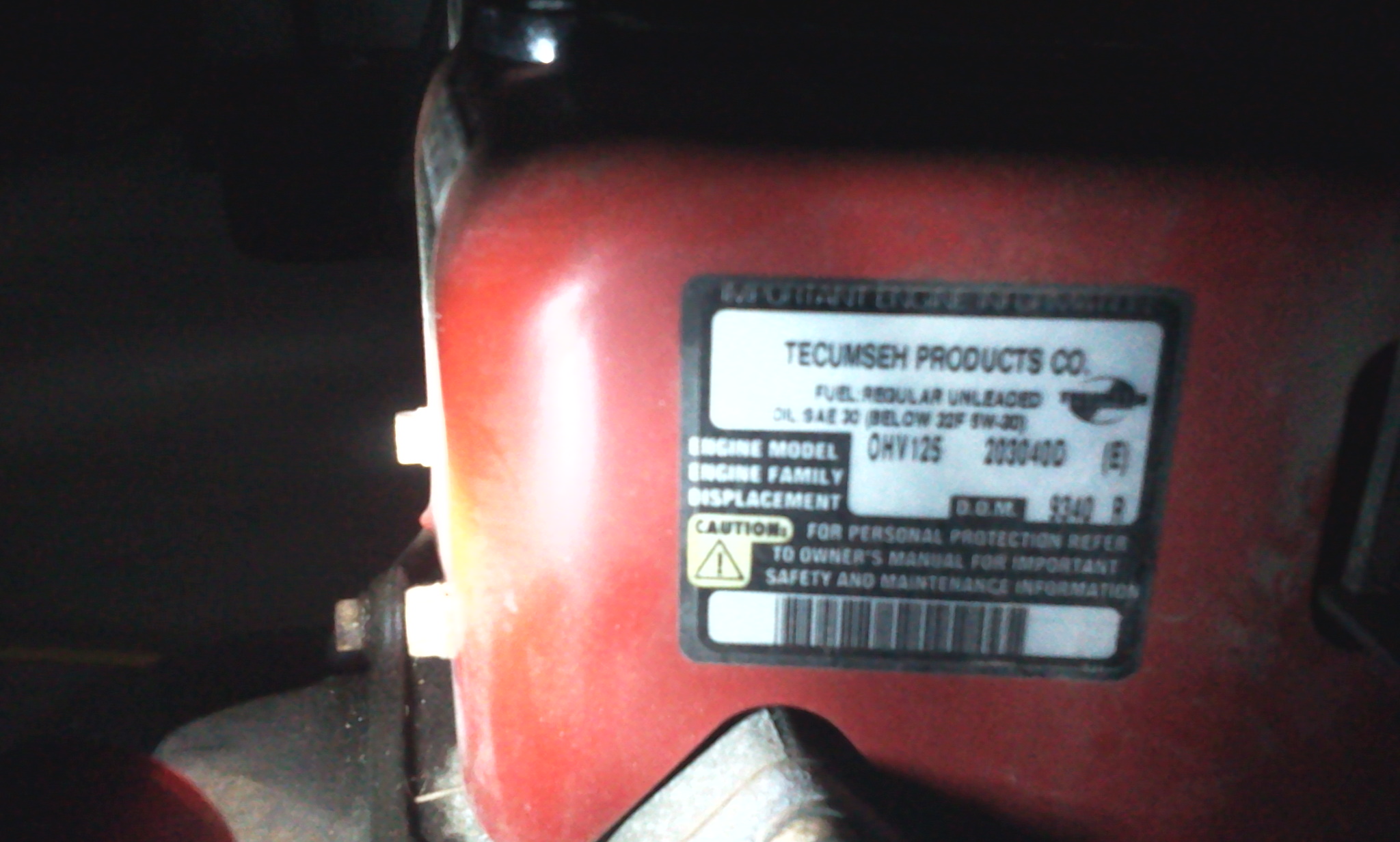

the motor is a Tecumseh 12.5hp and on the ID plate it has model OHV125 203040D (E)
then underneath it has D.O.M.9340 (R)
i assume this is a replacement engine???

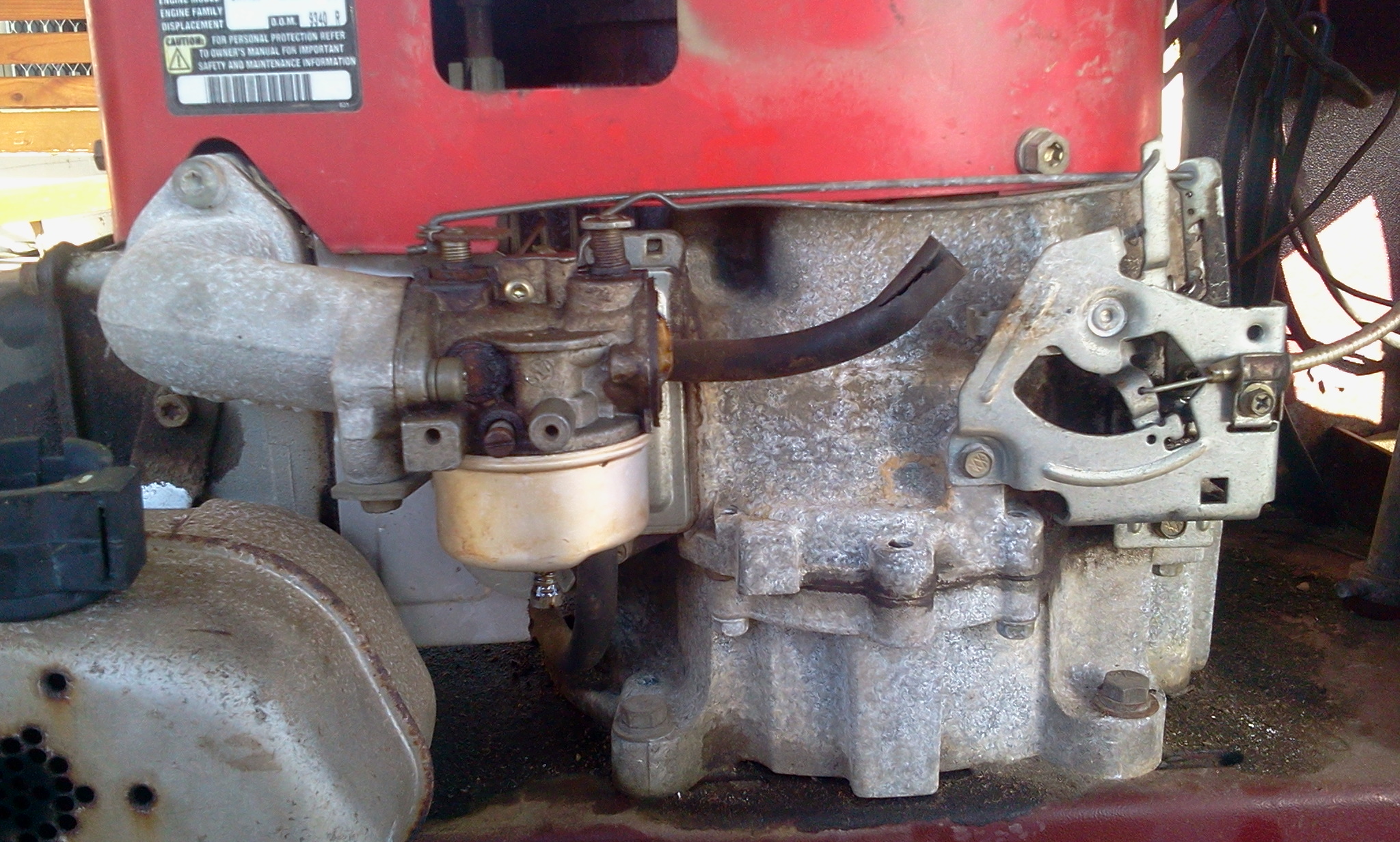

This is the carby tp left is the id plate
Joined: May 2014
Posts: 28
The screw projecting downward from the center of the float bowl (circled in red) is the main mixture adjustment. The horizontal screw just above the top edge of the float bowl (circled in green) is the idle mixture. Preset adjustments (that is, the starting point for tuning the carburetor) are 1.5 turns from fully screwed in for the main mixture, and 1 turn for the idle mixture:

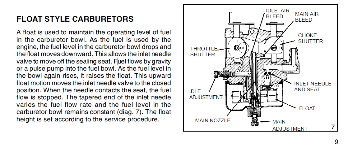

Here is a diagram showing the working parts of your carburetor:
As I said previously, I currently suspect that there has been foul play in that carburetor, and you need to be on the lookout for "tenant's improvements" made before you got this machine. Look especially for signs that the "main nozzle" (a combined main jet and emulsion tube) is either fouled or modified. If you are lucky, it is badly fouled and the previous tenant amputated the working part of the main adjustment screw to compensate for this, rather than clean it out, then when the fouling progressed even further and it became lean despite the amputated adjuster, he/she disposed of the machine.

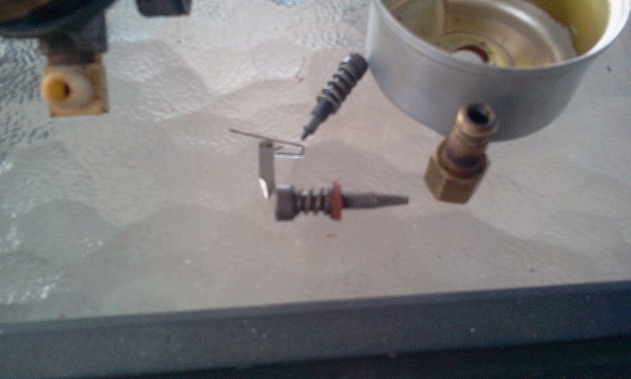

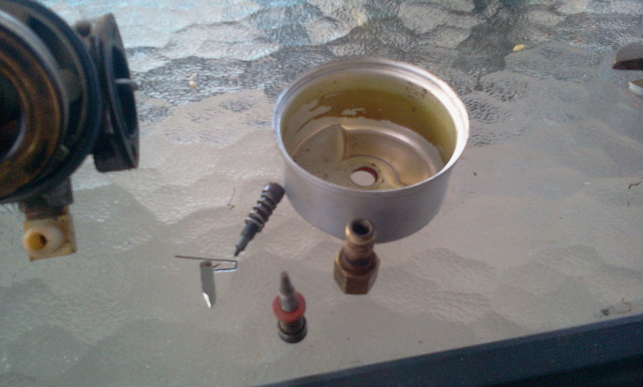

wow thanks for all that information this a photo of the mixture screw and float after first clean it was ugly [Linked Image]
You have to get the emulsifier/main jet out of the carburetor body before you will get anywhere. If it doesn't come out easily, it is probably stuck in by hard gum. That happens a lot to Honda emulsifiers, and is something of a hassle with them, because they are only held in by the main jet screwing up from below and pressing hard against the bottom of the emulsifier. With those, you mustn't push down hard from the top or you'll damage the top of the brass emulsifier, which is the discharge area. In the case of your Tecumseh though, I suggest that the emulsifier probably screws in with a thread near the bottom, and there is currently lots of hard gum gluing it in place along the length of that thread. Just check whether there is a screwdriver slot in the bottom of it, right above where the mixture screw goes in. (Most likely the slot will have been completely trashed by the yahoo who had it before you.) You have to remove the gum so you can unscrew it, and this whole exercise will be quite a trial if there is no slot left. Regardless of that, removing all of the gum is the first step. I rather suspect that in the end the emulsifier will be a total loss by the time you get it out, and you'll have to source another one somehow. I don't think it will be possible to clean out the lateral/radial holes in the emulsifier without removing it from the carburetor. Please keep us posted as you go with this, before you trash it the rest of the way, just in case we can find a non-destructive solution.

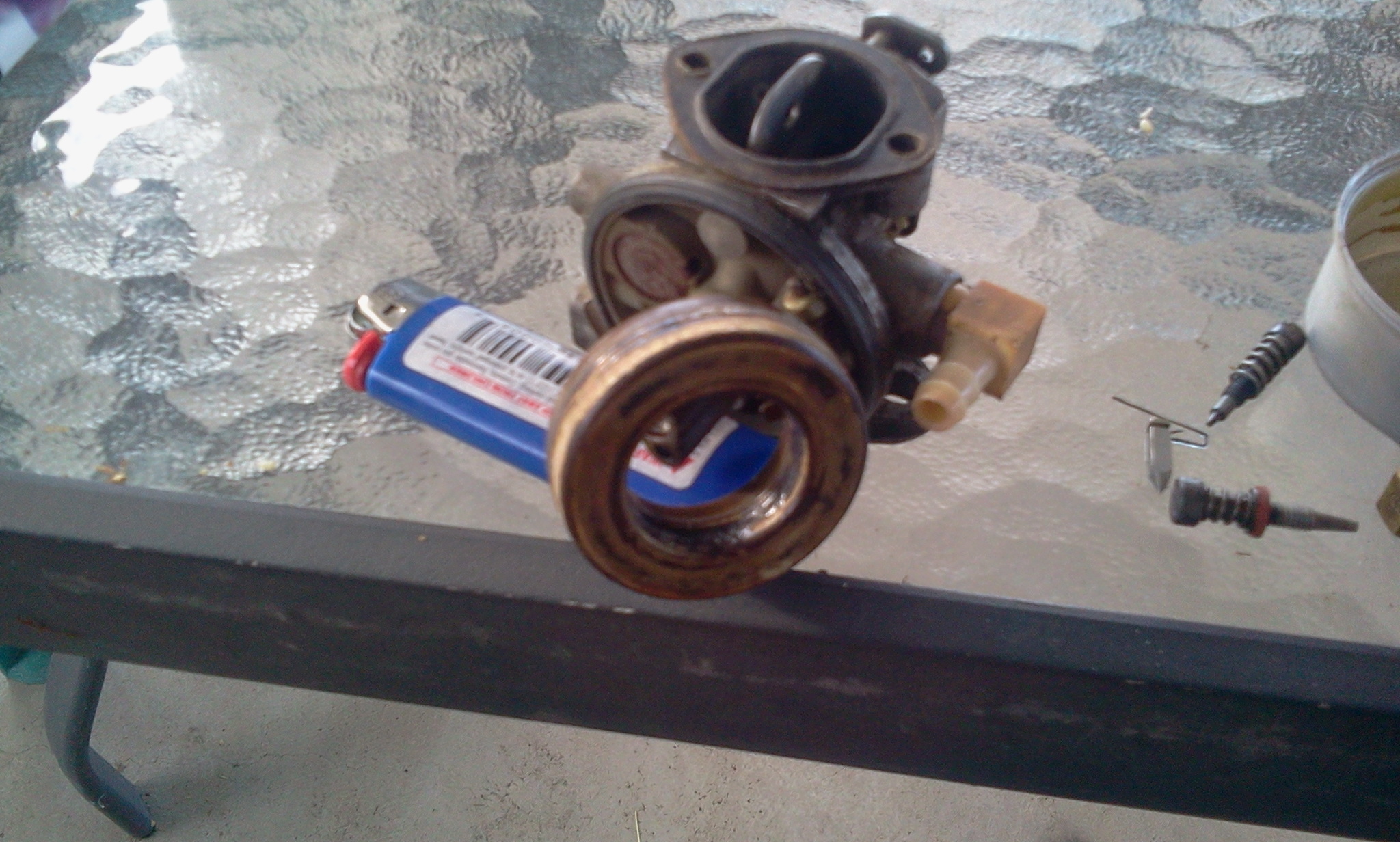

I don't think molasses will help with hardened petrol gum, and I don't think it will penetrate a tight thread. The stuff that works is a spray can of carburetor cleaner, and it is almost miraculous if you haven't used it before. However it can't dissolve what it can't reach, and that may be a problem in this case.
Can you post a picture of the carburetor from underneath, as close as possible, so we can have a look at the "main nozzle" (that is, the emulsifier) and try to work out how it is retained in the body casting? I'm used to them being screwed in. I just can't see it being pressed in because you then wouldn't be able to get it out for cleaning.
