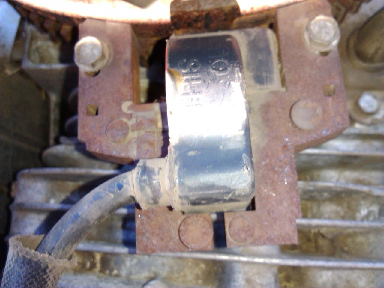

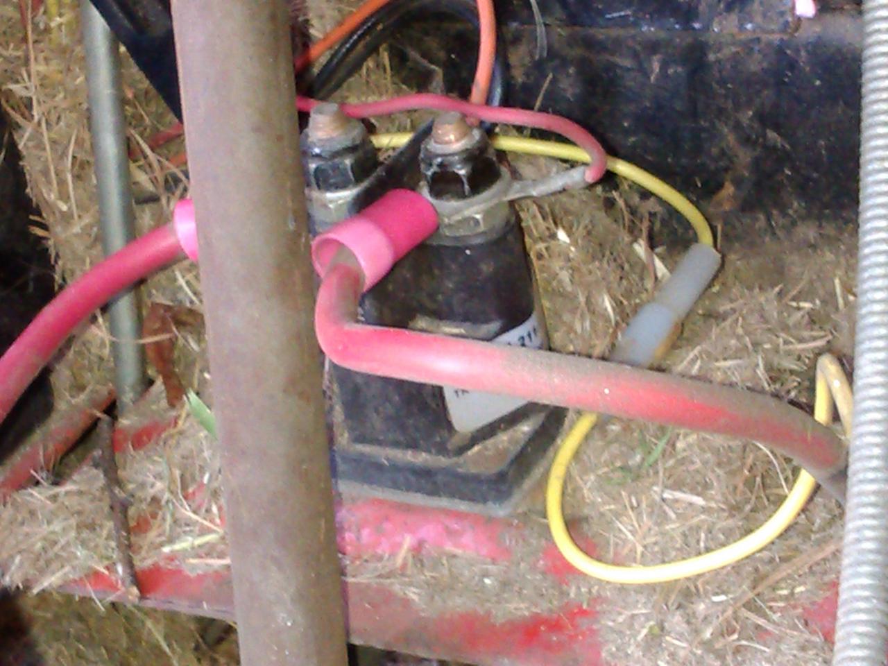

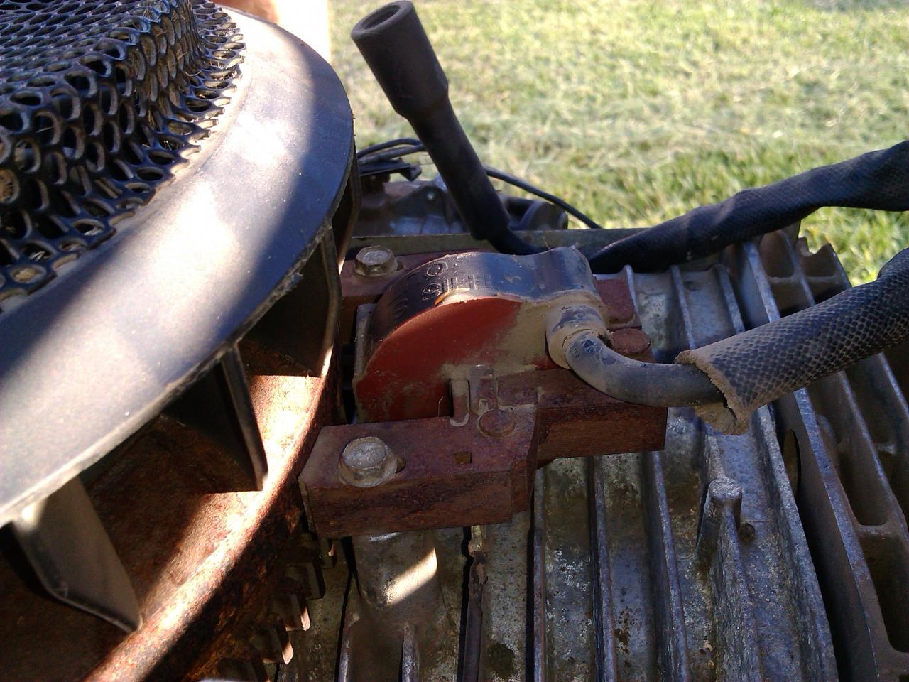

Hi, have a Rover ride on, (Murray?)model no. 425621 x 108 c/d.It heats up and cuts out minutes into job, last time burning smell and smoke coming from the armature. Since then it will not start at all, a 15 amp fuse behind the solenoid keeps blowing when turning ignition key. My questions are, 1) is the overheating/ cutting out caused by a faulty armature and 2) is the fuse, no ignition a additional problem, suggestions appreciated, Cheers, Rod.

Is the starter motor being activated when the engine is already running? That would have an ugly effect on the starter mechanism, and the associated wiring. If the starter motor sometimes starts running without you touching the multifunction keyswitch, there is an electrical defect in the keyswitch or the wiring attached to it. Please clarify whether this is what you are telling us. The only reason I ask about the starter motor is that you have indicated that the starter motor operating solenoid (your last photograph) is somehow implicated. That solenoid has no function other than to operate the starter motor.
You said that smoke was coming from the armature. The item marked "armature" on the wiring diagram is the ignition module, of which you have posted photographs. That Magnetron ignition module has nothing to do with the mower's electrical system. Is the problem with the ignition system, or the electrical system, or both? For background, we have had cases before when some previous tenant (owner of the mower) has become inventive and improved the wiring by connecting the Magnetron's kill wire to plus 12 Volts whenever the engine is running. When this happens, the Magnetron soon burns out, possibly emitting smoke as it does so. The kill wire has only one function: to stop the ignition when it is grounded. When the engine is intended to run, the kill wire must be floating (that is, neither grounded nor connected to a voltage). In this case, it seems conceivable that the evil deed of rewiring the kill switch to the wrong terminal of the ignition switch, also interfered with the starter wiring.

Hi, sorry for delay re getting back to you, ok, Model 31F777, Type 0318E1, Code 040524ZD. Sorry for confusing you, only included pic of solenoid to show area where 15amp fuse located. On inspection of the existing wiring compared to the wiring diagram it is evident that it has been " modified". Will attempt to rectify this wiring issue over next couple of days and continue this discussion with the result of the rewire, Thanks for pointing me in this direction, Rod.
