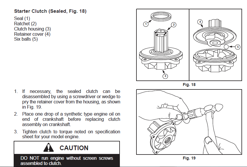

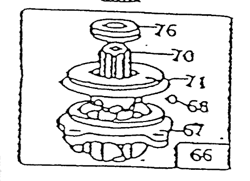

The slack rewind cord on the starter supports the notion that it has partly seized internally. If you look at Page 5 of 12 in the IPL, you will see this illustration:
You can see that it has a normal Briggs sprag clutch. This type of starter is prone to squealing, and paying out some of the rewind cord as it runs, when it has insufficient lubrication.
Here is the page from the manual giving instructions for how to service this clutch - note particularly that you place only one drop of oil on the shaft, and ensure that the sprags, balls, and ball compartments are completely dry and clean:
I apologise for previously posting an illustration of the pawl clutch, used only on the small engines.
It seems you will need to service it. I suggest you remove it and report whether it makes a difference to the start-up squeal. While it is off, you can lubricate it.
Last edited by grumpy; 07/03/14 05:12 AM. Reason: Correct an error regarding starter type

You shouldn't need to open up the sprag clutch Figarow, just inspect and oil (1 drop) the end of the crankshaft where it extends into the starter. However if the recoil starter is showing any signs of slipping, or sticking in engagement, you will need to clean the clutch. Because it is a sealed one, it shouldn't need that unless the previous tenant sprayed the clutch with lubricant and thus messed it up.
Please come back and confirm when you have verified that it was the clutch, and there is no other problem.
