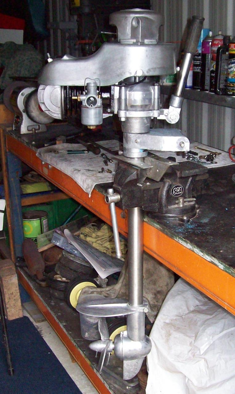

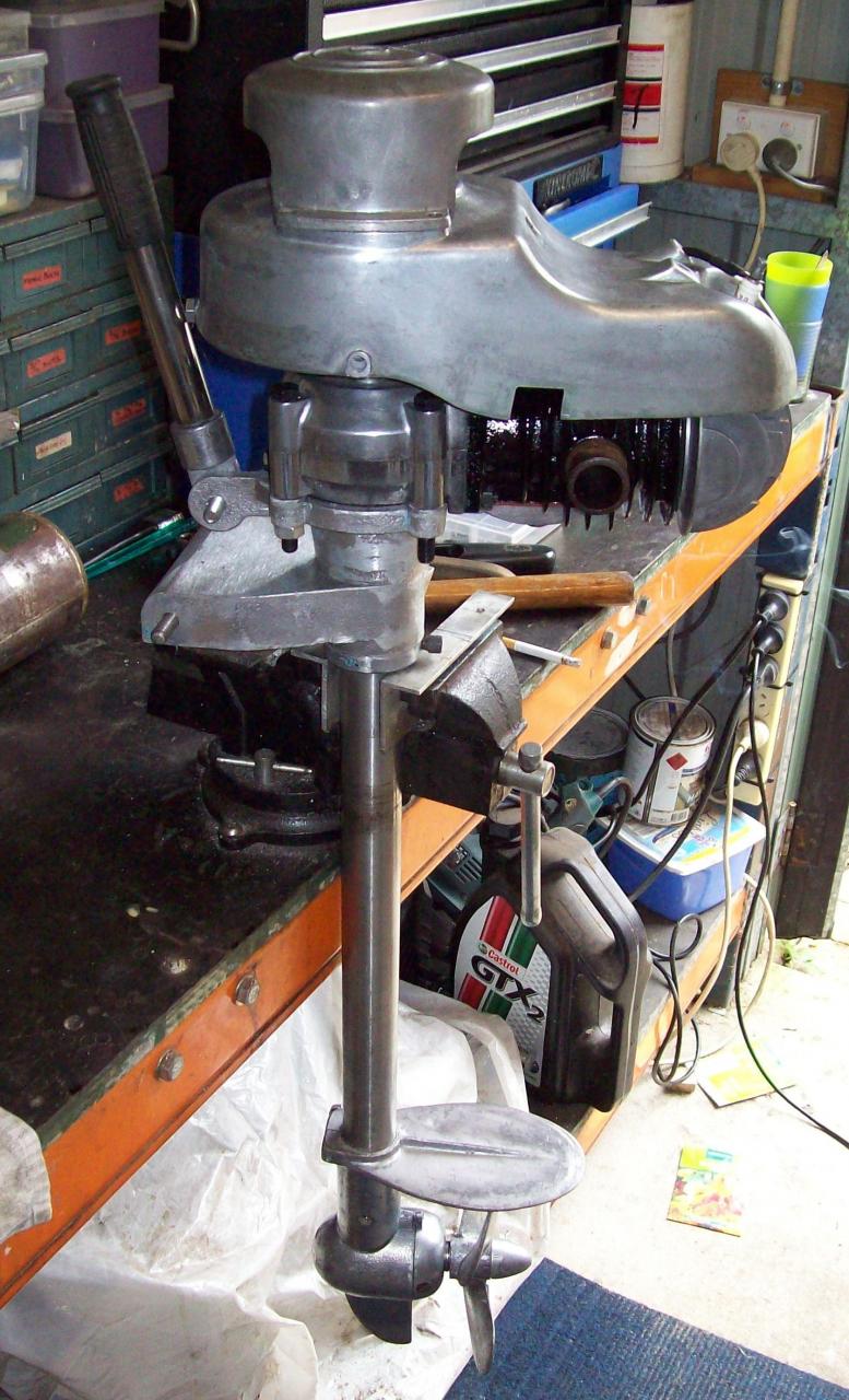

Hi all,

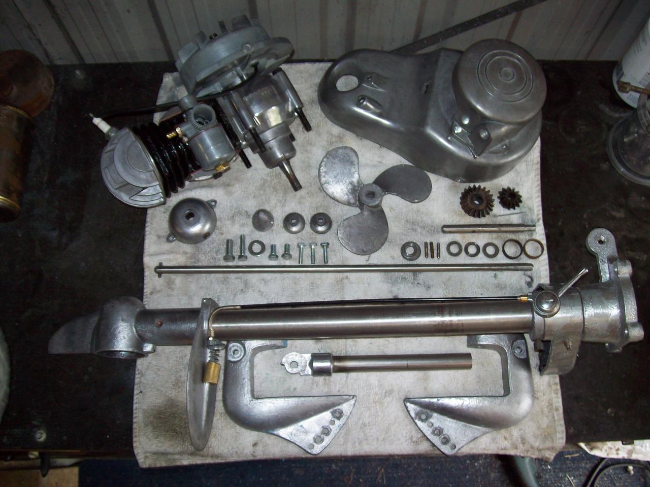

I Finally took the plunge and got myself a Tiger Marine assy that was to good to pass up....Free" often Entices one to overlook their lack of room lols.
Its running an unmarked Tiger 125 engine and carby assy.
Ell-den Dog assy in very good condition. Missing only the air filter assy. If anyone has a spare filter assy,could you please ppm me with a price or trade.
.[Linked Image]
Engine Serial seemingly denotes approx 1960 man date.
Engine has been stripped,honed new rings,gaskets,seals,throttle cable and ht lead.
All parts have been recoed or repaired as required. Drive shaft and gears are in excellent condition,it appears its seen very little use

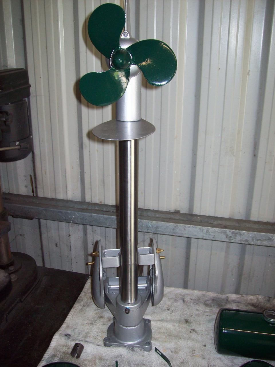

Here are some progress images of its restoration and parts breakdown.
I no longer restore specials nor do I keep Avocado hammer anymore,so Ive yet to decide on a colour,as I only focus on Rotomo.
I was going to run a straight polished alloy or Platinum/Alluminium painted dogleg assy,with a deep brunswick green engine cowl and starter as per Rotomo styling.
Any suggestions would be good.
It was running Original black for the dogleg and of course Avocado hammer for the engine.

Hi Blue.
how do you tell if its a Tiger engine? they look like a victa 18 from the pics you have?i have heard them mentioned now and again but i cant spot a noticeable difference.
as far as your colour goes. it looks pretty good just shiny like that.bazz

Hey bazz,
Yeah shiny is good...was gonna polish the cowl too but cant justify the time. Think polish dogleg and green cowl then send her of to market! Thanks for the input.
Dont look to hard for discernable differences. Tiger was victas industrial/marine spinoff which started I believe around 1957. Prior to this the rotomo engine was used in varying.configurations but sold under the victa brand. Anyways essentially they are model 4 engines with industrial applicable fittings.ie adjust able carbs bracketey and air filter styles. The early tiger engine was stamped tiger" in place of Victa" on the crankase and the serial sequence was not inline with the lawn mower run. Around 1960 they just let them blank. Essentially its the same engine as your mower variety just without the Victa brand. Tiger sold engines for industrial/marine,applictions and also for generic or store brand mowers eg, Hg palmer. So to answer your.question. Its basically the same engine...no real difference other than the ommission of any victa logo on the crankcase and they only ran the model 2 or 3 barrel assy to suit the bun style or clamp on muffler.

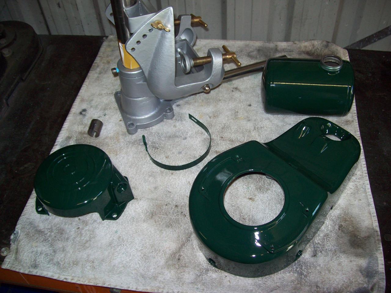

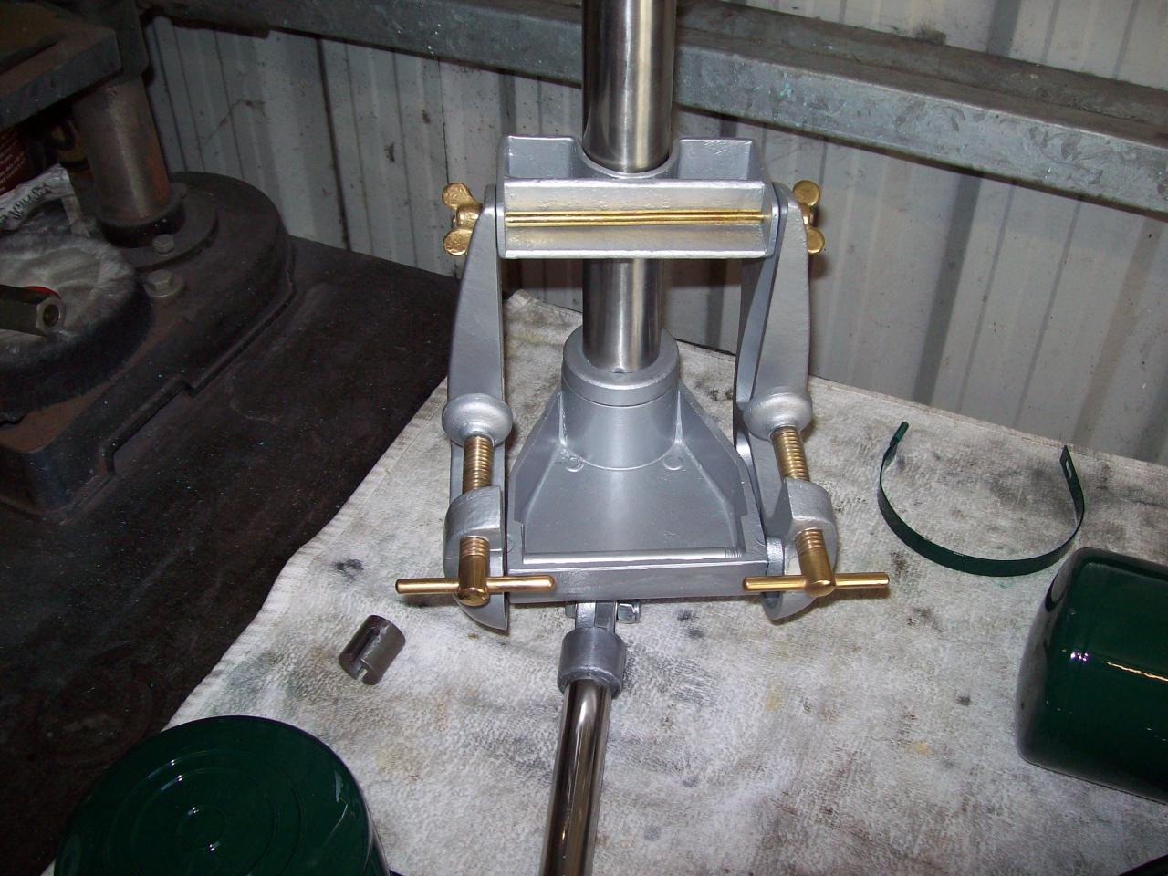

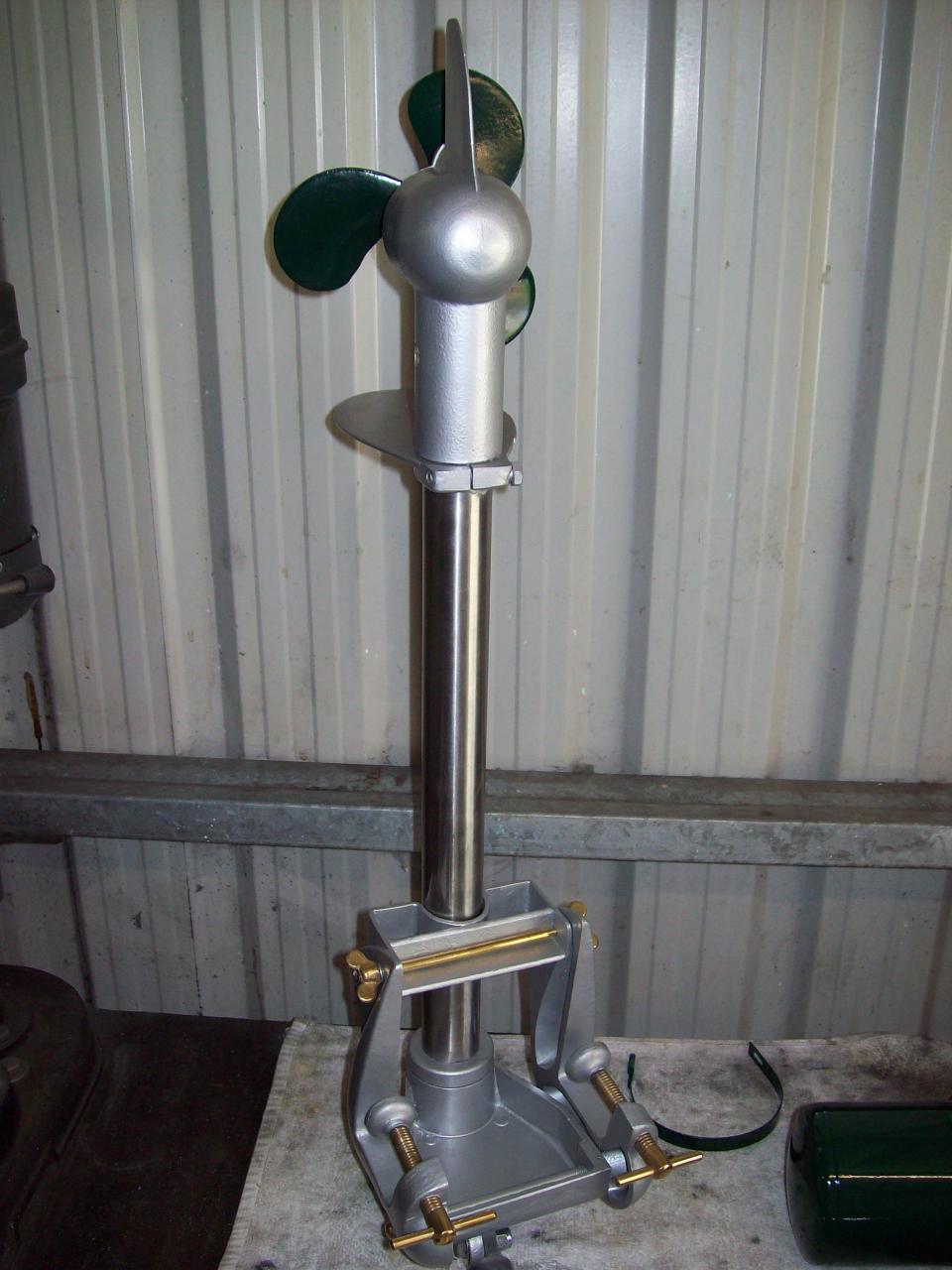

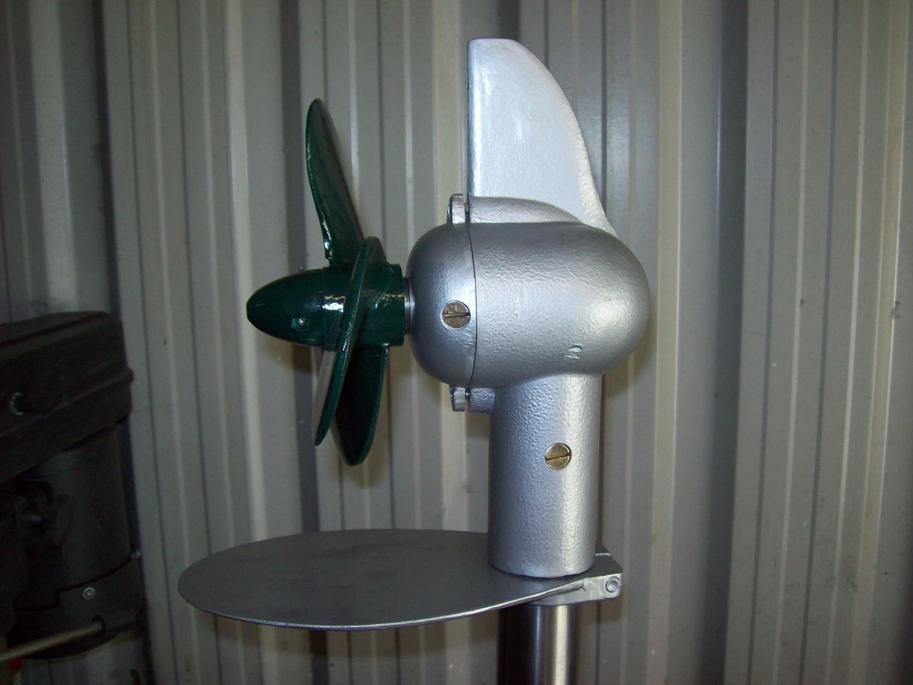

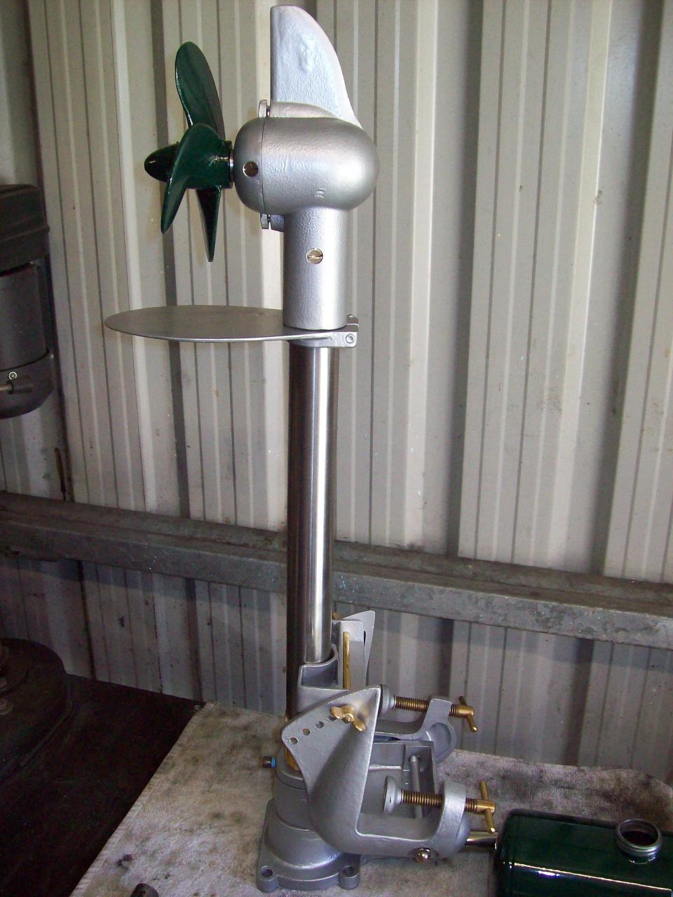

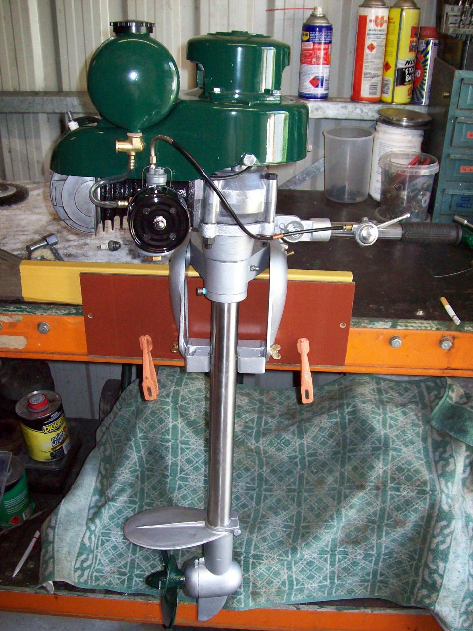

Some Progress Images...it appears my camera only likes silver and not green sorry for the fuzz,Ill get my daughter to take the finals...lols.
Dogleg complete,Engine finished,painting finished just reassembling now.
Still looking for a marine Air filter assy if anyone has one,
congrats Mal, on a fantastic job of the leg and cowling, fuel tank etc....geez mate, it looks brand new....
Can't wait to see it finished. wink
good1

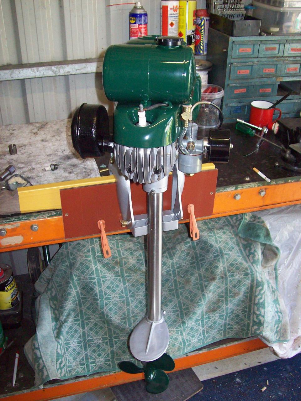

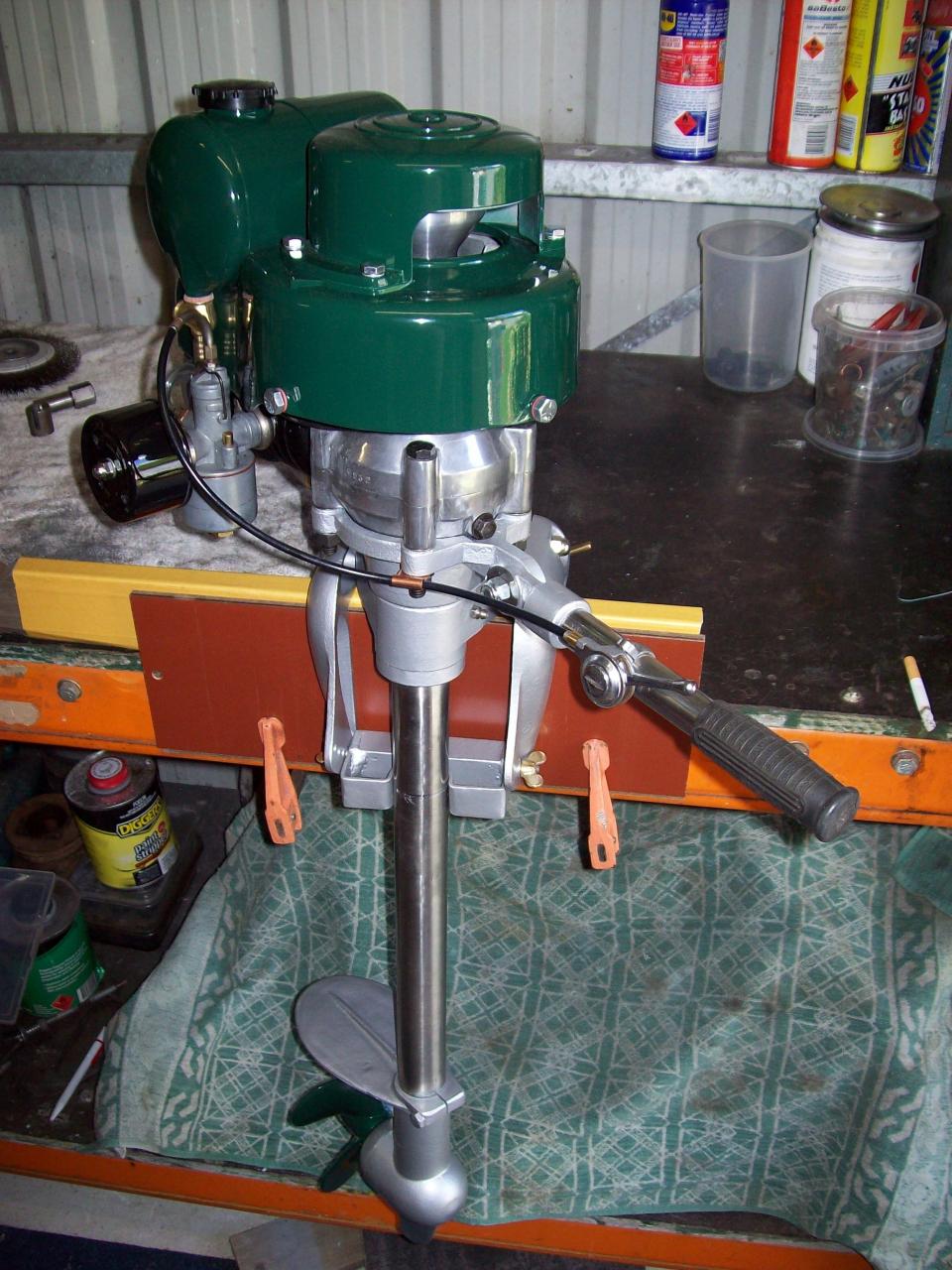

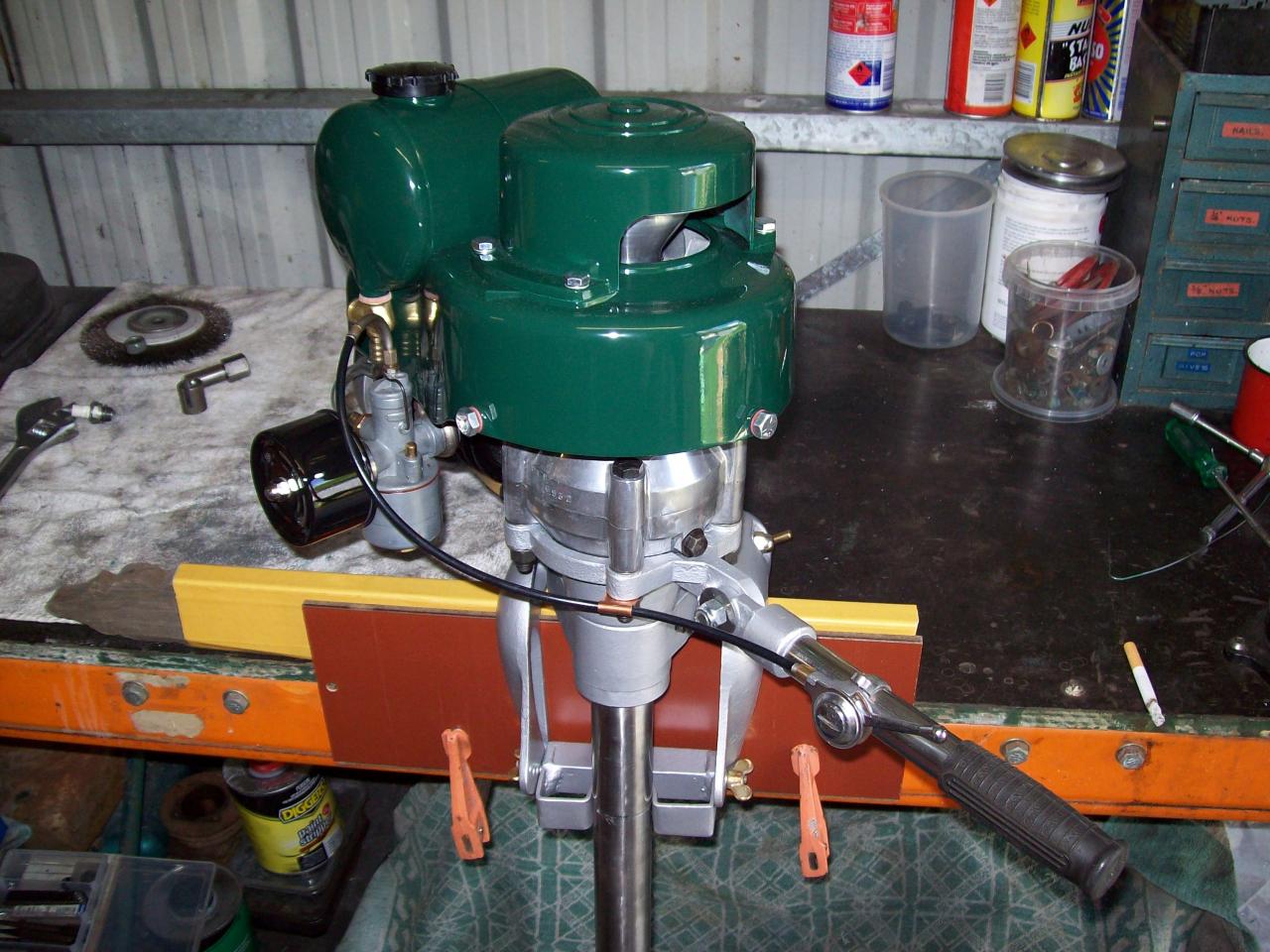

Thanks Guys, appreciate the comments.
Nearly there just wish my camera didnt dull down my green it looks a hideous shade,and shows up inperfections I cant even see with my eyes....hmmm maybee im getting blind,sighs*
Anyways starter rope and handle,just about finished fabricating a new drive dog ,need to tidy up the throttle control a bit more. Add A sticker,gonna go the early model 4 style on the cowl to break up the green a bit(the tiger repros are to hard to find) I hate waiting! Give the paint a few more days and give her a polish make a display stand and thats about it....oh and give it a decent run I guess.
Erm and yes I couldnt wait for an air filter assy,so i opted for the one John West rejected,yes apparently he made air filters as well. Smoked tuna in olive oil actually with a mesh insert dome nut and pipe,fully functional of course lols.....it will do till i can source a genuine....
Thanks again for the feedback guys,ive enjoyed this resto,as its been a change from the rotos and my first marine.....

Awesome work your done blue looks in better nick now than it would have new,A little red on it like the old mod victa badge might look good too? smile...
HT6
Offline
Thanks heaps mate, appreciate the comments.....it did have a red drain plug which I thought seemed a little late for this serial...hopefully the sticker will break up the green. Where do you suggest the red? Sounds like a plan...Just finishing of a model 5 so when I get the red out .I could stencil a smiley face and run it across the cowl front if I get the time.
Joined: Sep 2012
Posts: 418
Yeah I was thinking along the same lines, I like the look of the old Victa's with the green base and red/silver badge it tops them off I think...
Posts: 539
Yeah, that has come up a treat Blue, as always top notch work, are the clamp threads and wing nuts etc painted or wire wheeled brass? is it the industrial carb with the needle? my personal opinion is with the sticker that will be enough otherwise it may look over done. Dont send it to the market! keep it in your shed, you have plenty of room lmao. (nice work John West)
HT6
Offline
Thanks mate smile Wire wheel Gasps* Noooooo never on brass lols. Naaa you know how I love to polish,just on the buff mate,didnt get too excited but. Nope std carb,but I have the industrial adjustable needle style in stock,actually Id never thought about it till you mentioned it:) No sell? but i dont have a boat...or water for that matter frown ok just red nut it is then,besides im too lazy to make a stencil lols.

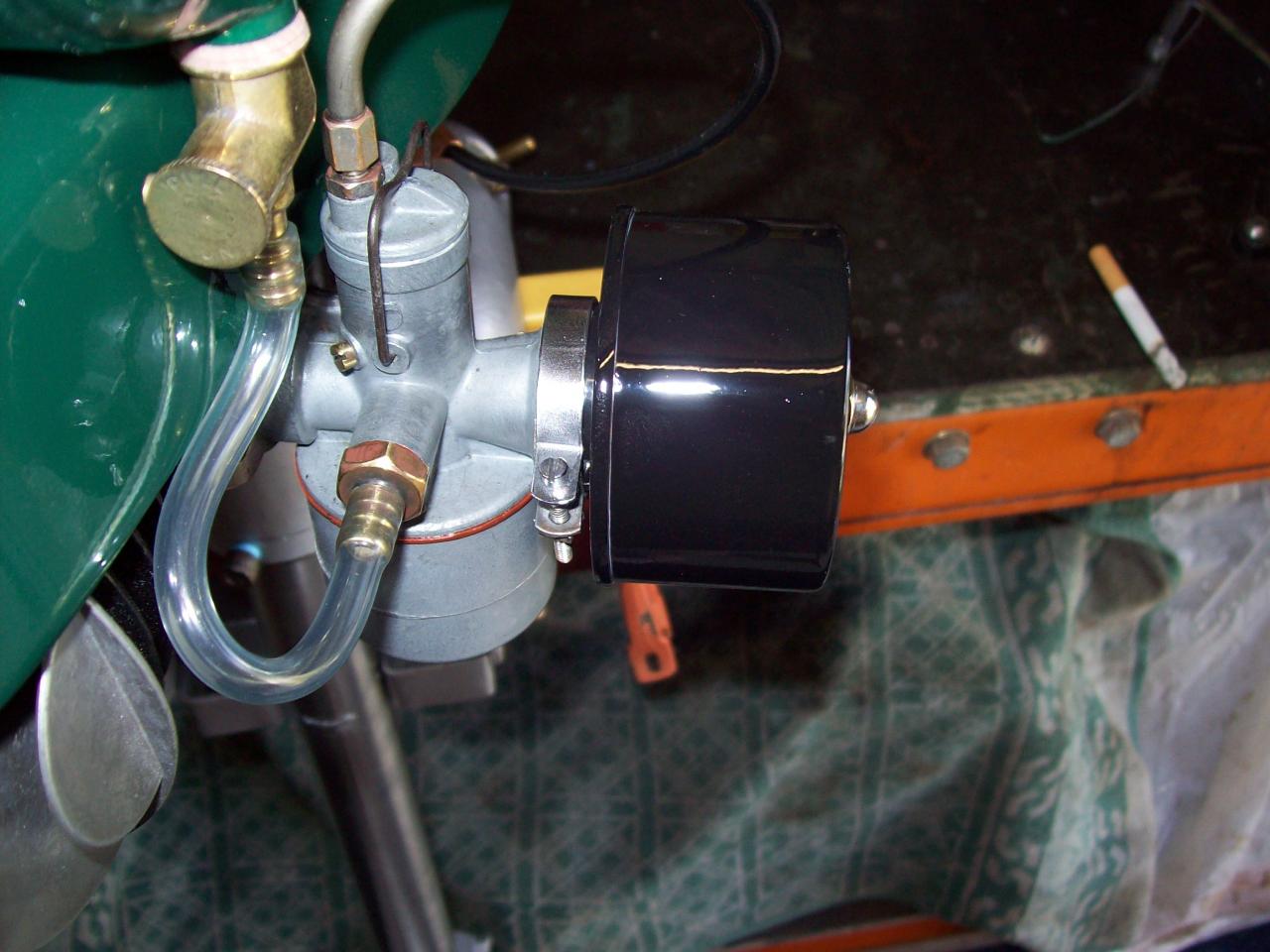

Blue, do you still have this beauty, there is a air filter Here
cheers.
