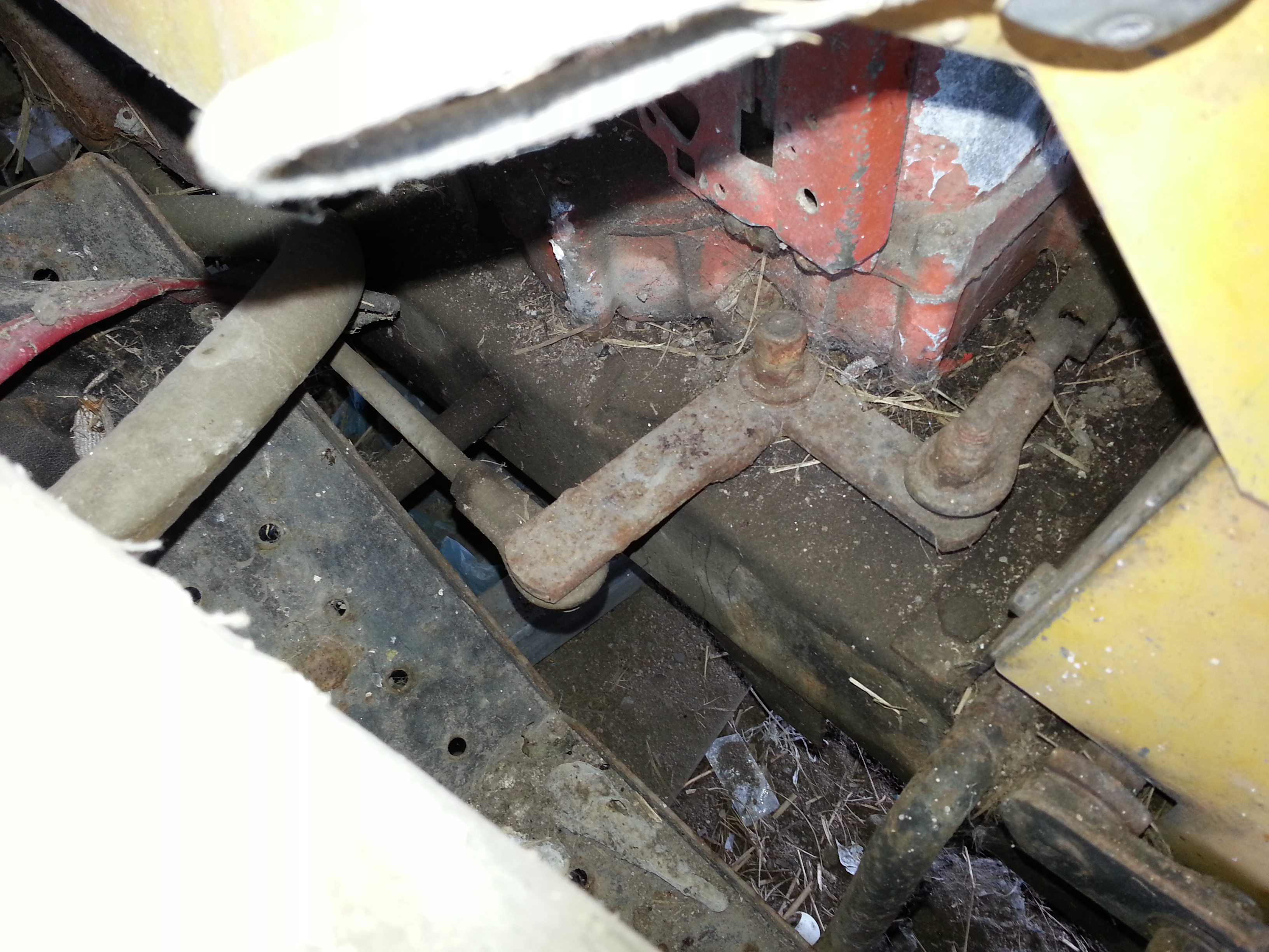

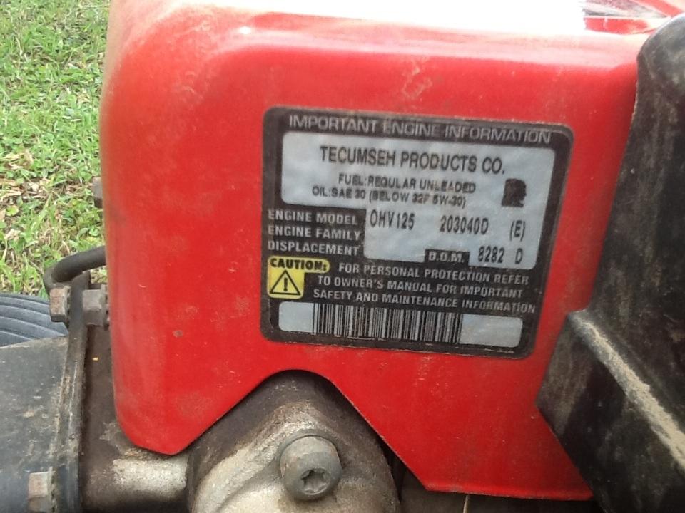

My old Greenfield is a second or third hand beast which I bought because I'm moving onto 1 1/2 acres of bush. The steering is very sloppy and it seems to all relate to the tie rod ends, so I'll try the local dealer for those. There is a pivot point on a triangular plate which is also very sloppy which looks like it is tightened from below, but looks like it runs through a tube, which I suspect is very worn.
(I tried the photo upload, but no indication it worked)
I also would like to get a full set of belts and replace the ones currently fitted. That looks like it will be full of challenges, but I plan to start removing bits until I can see them, then take photos, before they break.
My questions....how do you access the belts?
How easy are the tie rod ends to access?
How is that pivot on the steering constructed?

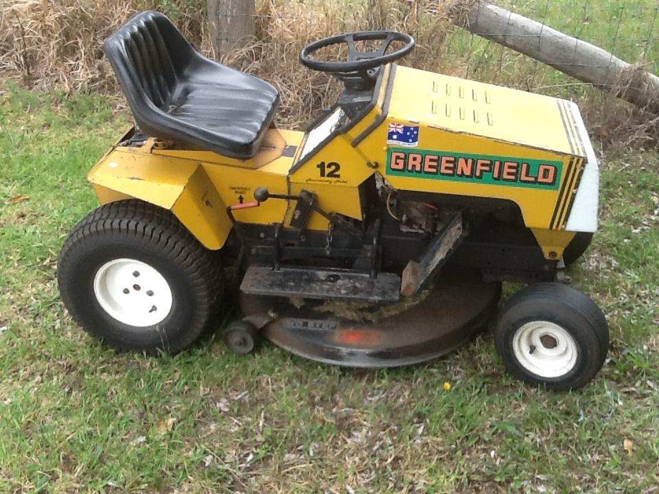

To give a proper indication of the unit, I'll try to put photos up.

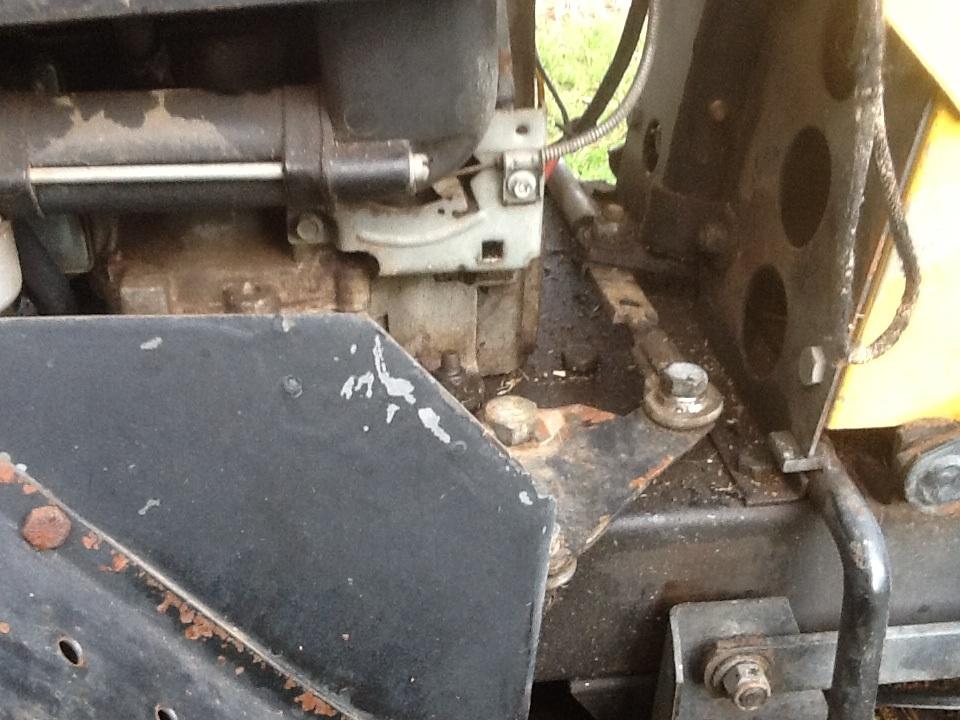

The pivot point (which I'm sure you all know by it's correct name) is the bolt head, which is welded to the plate, directly below the throttle cable

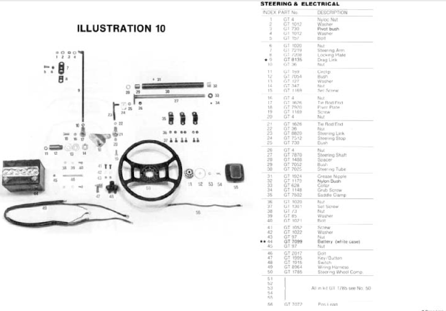

Rick, let's see if we can begin by both understanding what the parts are called and which ones you have issues with.
I've attached a pretty woeful scan of the page from the illustrated parts list, showing the steering parts with part names and numbers. I hope you can read them better than I can.
Posts: 6
Thanks again Grumpy. There's a bit of a challenge in reading that, but it gives me hope that the only thing it needs there are bushes. I reckon I'll try to get every one on that page and see how much difference it makes...it's bound to be better, and definitely no worse. If still not good enough I'll start on the tie rod ends, etc. I've shimmed the part numbered 51, which looks like it might be part of a kit ( very hard to read) and wouldn't mind getting that as well.
