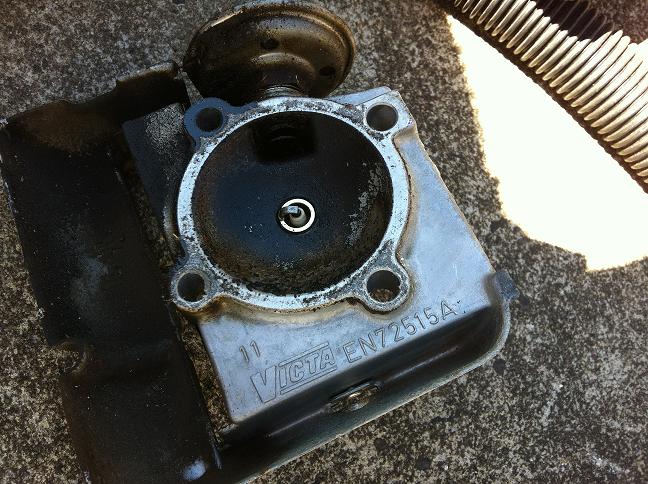

Got a 2 stroke victa tilt-a-cut power edger with S90 engine pack. When I got it I was told not running for awhile. Poured some fresh 2 stroke fuel in it tried to start it after a couple of pulls it tries to start and run. The thing was blowing a lot of white smoke and ran for 10-15 seconds before cutting out.
It's the same story every time you try to start it. Today I took the thing apart to figure out what's going on. The spark plug was clean but has very overpowering petrol smell. When pulling the motor apart there wasn't much of the gaskets left.
This is what the inside's looked like:
I've cleaned the insides, I'm gonna get a new head gasket, tubes. What else should I be looking at to resolve this problem.
looks like that headgaskets been blown for a time , just clean it all up and do 'o' rings at the same time . a good a start as any , under the starter and big n small on the inlet a quick caby clean and might be good to go but it depends on how far you like to go with it ?
