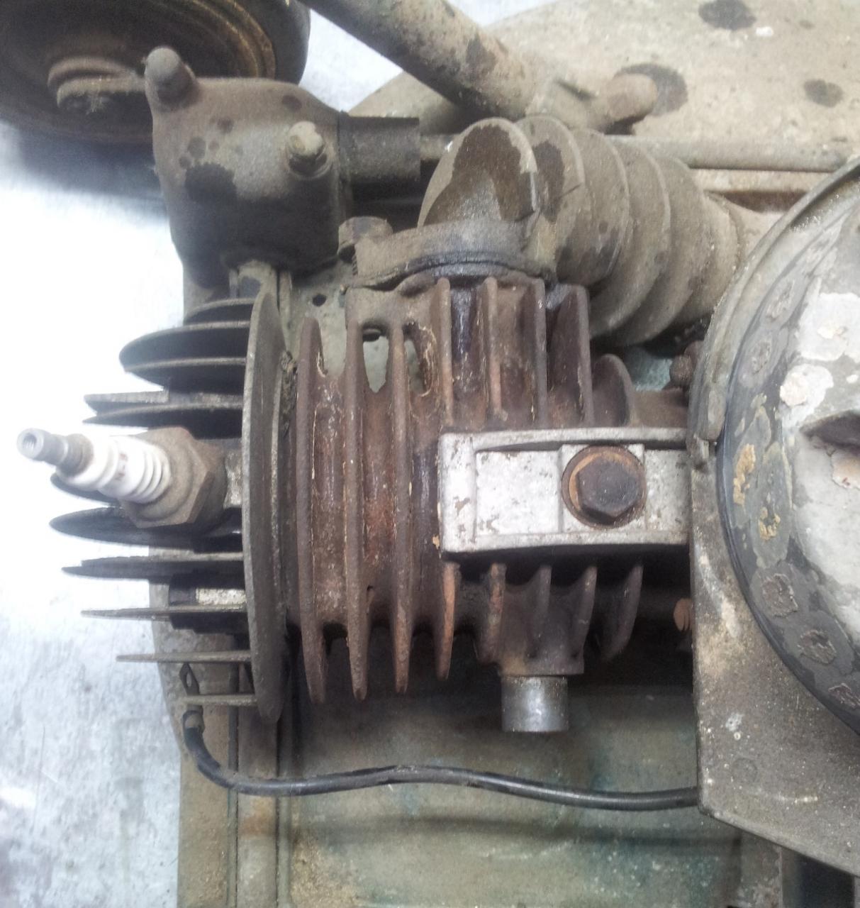

Here are my first Victa 18's that I have acquired for my collection. Both Model 5's I believe. They both have letters before the engine numbers, does this mean that they are a later model 5? Possibly 2nd model, not sure. If so do they have any meaning? I mean I have seen on here A, AA, AAA, and now AC. Blumbly or Blue can you explain please. Anyway I am absolutely stoked. I was so excited, that when I finished work, I worked on one immediately. LOL.
I'll upload more pictures soon of the different components. Could you guys help me out on what correct parts I need to properly complete these please.
Here is first: With short snorkle:
2nd Victa with long snorkle:
So I started working on the Victa with the short snorkle, Took out tank, completely flushed fuel tank, cleaned carburetor, new fuel line, cleaned out tap.
Then I noticed all the wasp nests in the engine cooling fins, so I got to work cleaning them:
After all cleaned, checked for spark, had very strong spark so I left the points alone for now (just wanted to see if it ran), installed new plug. And fired right up!
First Victa 18 I have worked on and I enjoyed every bit of it. Just have to fix fuel tap leak and bowl on carburetor. I think it's a good start to my early collection.

Ha Ha no good on ya James, I will try and let you know what I know about them, the one with the short snorkle is a model 5 series 2 with a later model engine No, as far as I know the series 2 did not have any letters in the engine No and I think also the series 1 which is the one you have with the long snorkle, the series 2 does not have the axel extensions on the front and back which were left over from the model 4 run (for the flap to hinge in) the series 2 should have the long snorkle but I think some of the last run series 2 got the short one as the series 3 was being releast (no edger groove in the base) both have correct starters on them and the series 1 starter could have been a wire rope starter???. cant see to much else I can tell you from those pics, good luck with the Model 4.

Thanks for that Jonesy (not jonsey). That all makes clear sense to me, except one thing. You said series 1 and 2 do not have letters in the engine number. I'm not understanding this as mine both have letters. But at least I can identify which series they are.
What that means James is that some time in the life of your mowers somebody has changed the engines to that later series. Now your series 2 could well be correct as during this run was where the numbers changed to having letters in front. However the series 1 defiantly has had the later engine put on it.
Hi James,
Great score,and im so happy...Your Happy! lols. I cant see the front of the base on the first mower,( or im blind,lols) The IAAA....But I agree with blumbly.
I would put the IAAA.... at the very late end of the model 5 run,VERY late series 2 possibly even series 3,I assume it has the flush front axle mounts?. It should have. Since it still has the edger groove and assuming its the original engine for this base,then yes VERY late model 5 series 2. (If its the series 1 base,then its incorrect). Also somewhere in the mid to late model 5 series 2 run,the number and letter stamping changed. Note the A" as an EG, is sharper and doesnt have its feet like the earlier stamping. This is how you tell the later engines,from the serial sequence,the stamping and the generally smoother cast crank cases.
The AC.... As Blumbly says,unfortunately is incorrect for this series 1 base. Going of lettering/stamping and sequence I would place this as an early to mid run model 5 series 2 engine. Should be Flush front axle mounts. For this mower id try to find an engine with the serial number between say 200,000 and 300,000 generally coded 5 on the lower. If your particular about originality smile
