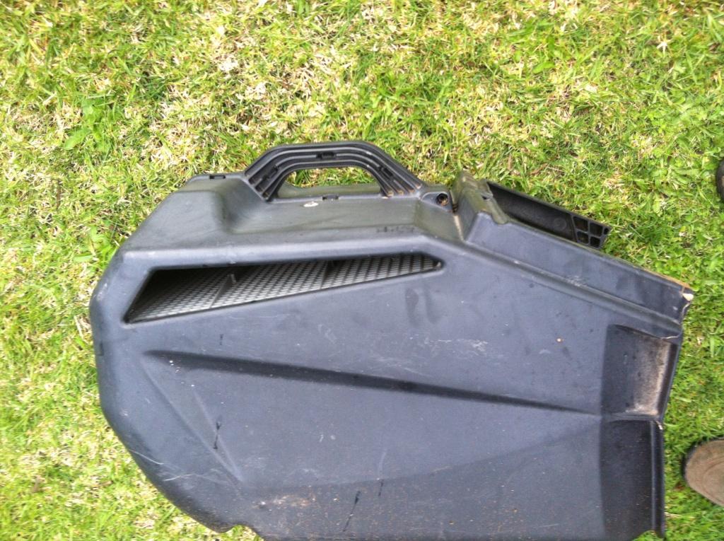

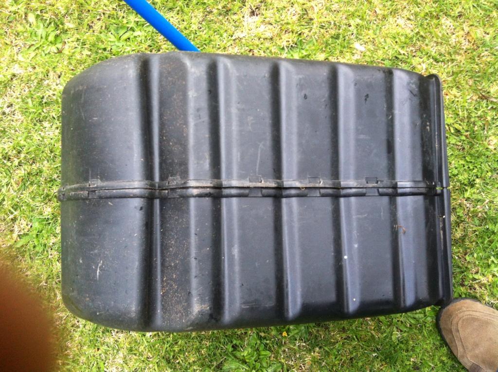

As for the catcher, when you see one you'll know, they're pretty unique because the 2 halves that join to make the cather are not your traditional "top and bottom style catchers, but the 2 halves come as a left and right setup. So in effect the catcher is joined in the middle. I'll try and get a closeup pic out to you over the weekend.

I think the catcher is very differnt to a normal rover catcher, they ran with this style for a couple of years before changing it again. The easiest wat to tell is open the back flap and take some pics of the opening, top to bottom.
Here's a few pics of one of mine
You'll note there's no "tongue" on the catcher, it hangs over 2 hooks which are under the rear flap attached to the deck, they are about an inch off the top on either side. If they're not here then it takes a bag catcher, identical a rover 460, which hangs off the outsides of the rear door rod.
