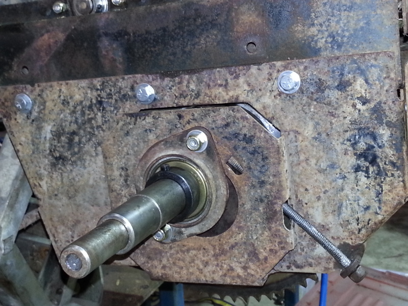

Hi guys does anyone have any tips on adjusting drive chain and brakes on this model greenfield ???
Joined: Apr 2012
Posts: 41
For adjusting the chain there are adjusters hanging down behind the axle. they will be the only threaded rod in that area and they are pointing backwards. follow those to the other end and you will see that they are held there by a bolt at the other end that's in a slide. You need to loosen both of these before adjusting and then look the other side of the axle about 6inch away there is another bolt there on its own, on both sides. That is the pivot bolt, loosen those as well before adjustment. adjust axle evenly to keep it all straight then tighten every thing up.
Hand brake adjustment is up high under the chassis, directly above the mechanism

Here's where you adjust the chain from. the adjuster is the long threaded rod but you have to loosen the bolt at the other end of it and the one opposite
