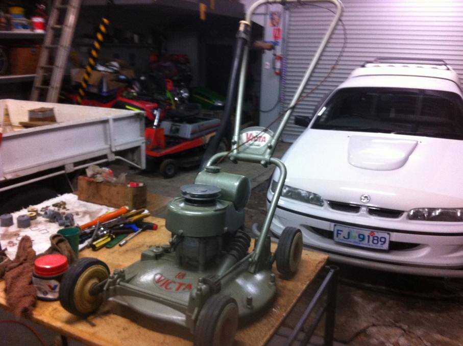

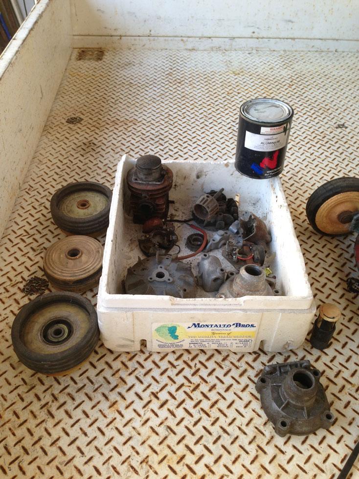

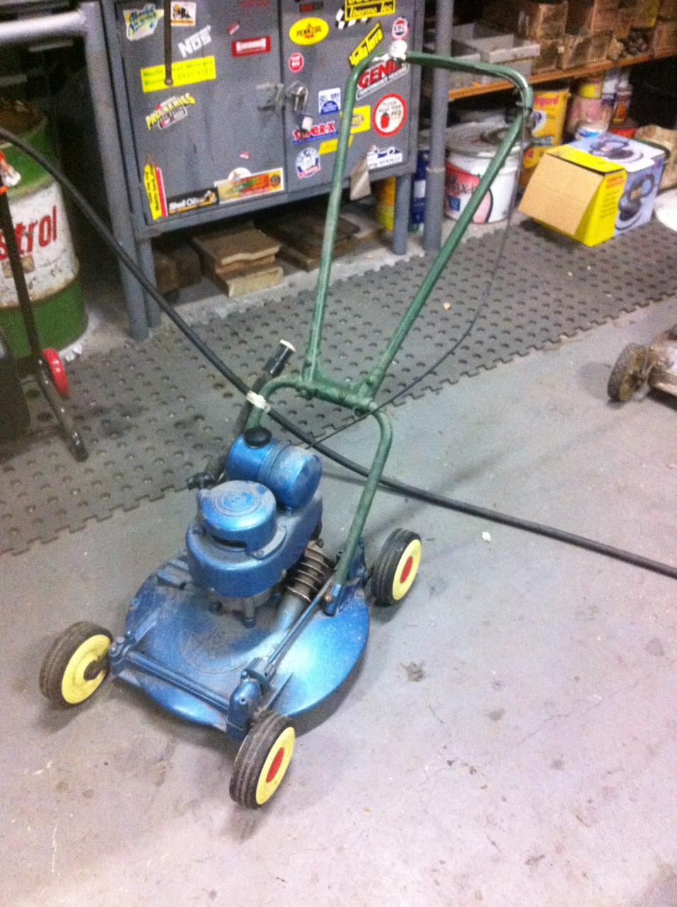

Hi Guys I'm new here and would like to try and identify the stuff I have just started getting together, my aim was to fully restore a Victa 18 but it is probably going to be more than one with the stuff aquired, (I went into more detail in the intro section) so I hope I have got the right area to post this?
I would first like your opinions one which of the three mowers would be the best one to do first, and have they got the right engine for the mowers.

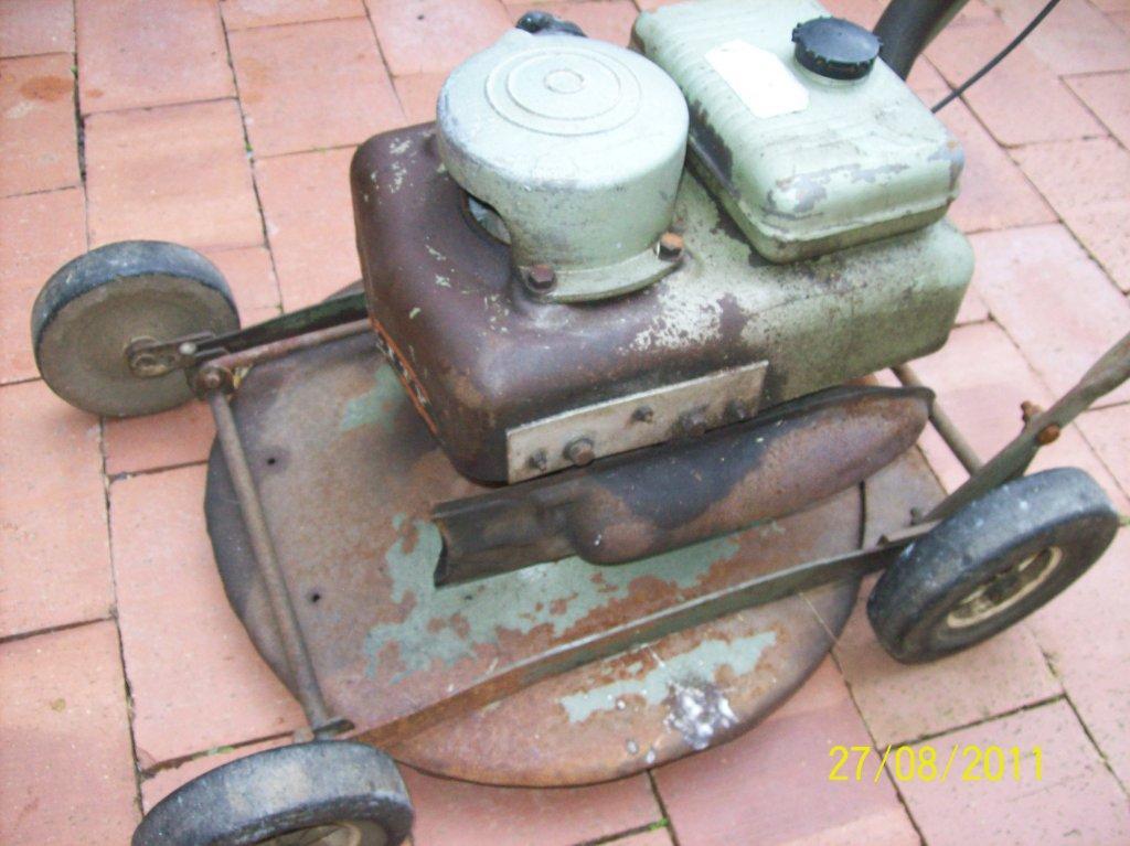

These two both run now, the one with the dodgy wheels was used as a regular mower til recently and has the engine number AC50234, the one with the wheels with no tires has the bits on the front for a flap and has the engine number 227756 over 1.
Here's the blue meanie, it's engine number is AC40054 over 4.It has a rebiult motor.

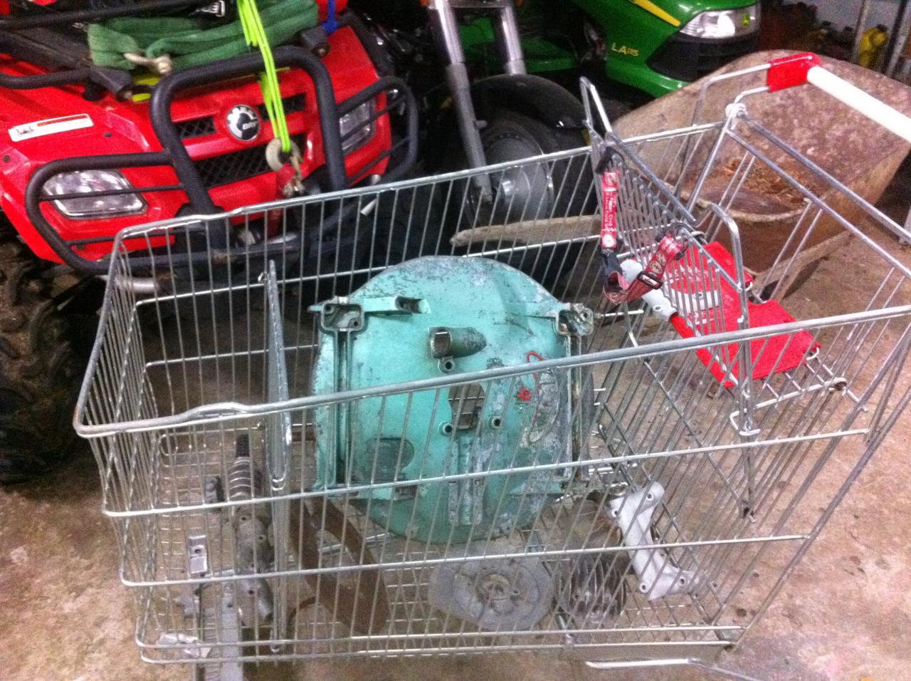

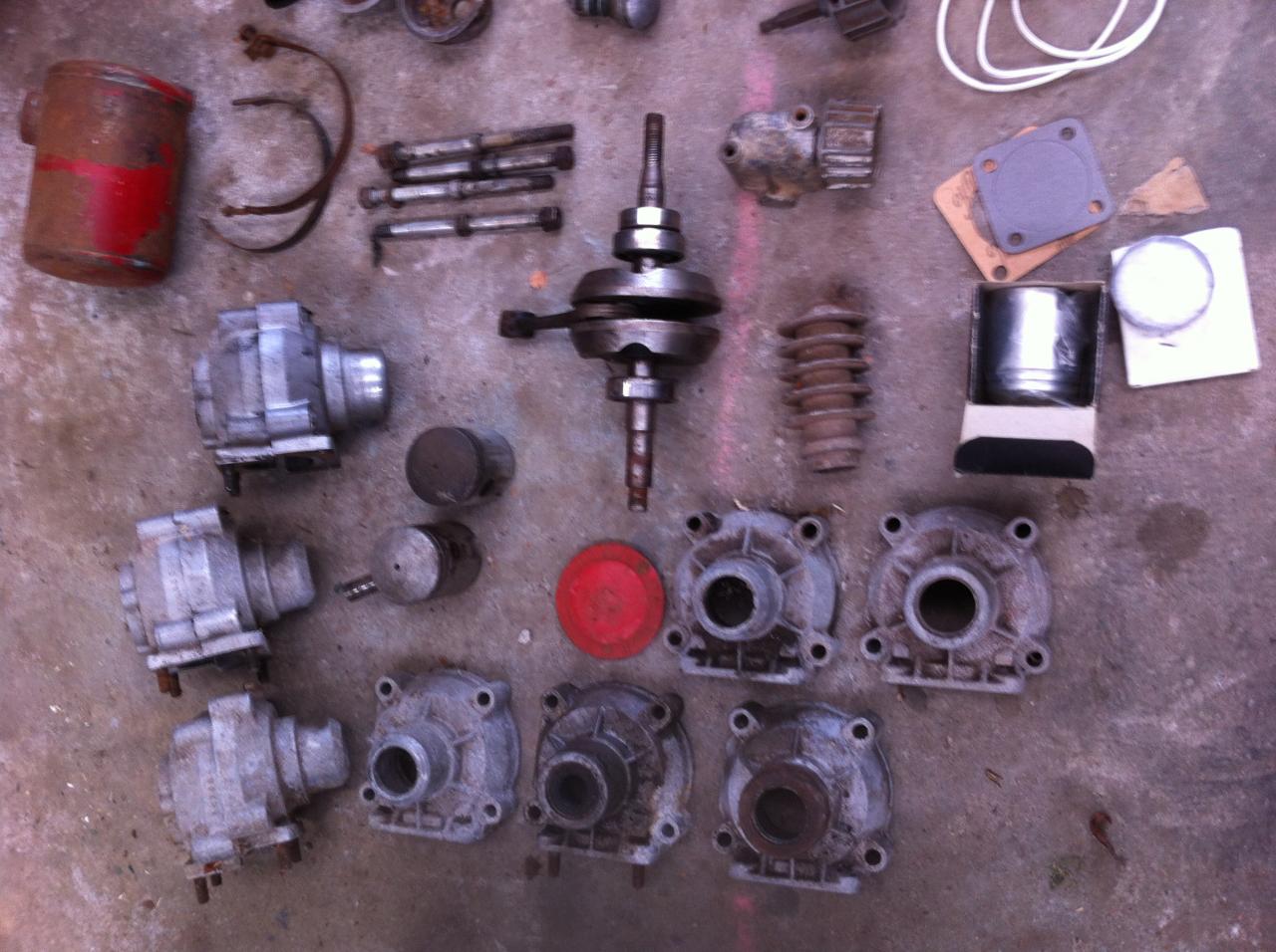

A picture of some other stuff I got off the bloke with the blue mower, the engine is rebuilt and has the engine number 94828 over 1, it also has a different flywheel to the one with no tires as I have just been getting that one going, I will add a couple of photos and hope someone can help me with the difference and when/why they changed ect. the spare motor and sprae timing plate and coil are the same, it also has an inspection plate (I asume for points adjustment) I dont know what sort of flywheel the Bluey or dodgy wheel ones have on them yet.
Oh yeah the spare motor has an earlier mufler I think it's earlier anyway, also has the black cover with holes in it over the flyhweel that the other one did not have, sorry for the long winded post but I'm keen for info if you blokes can help me? well cheers for now.
jonesy #45932 17/05/13 01:32 PM

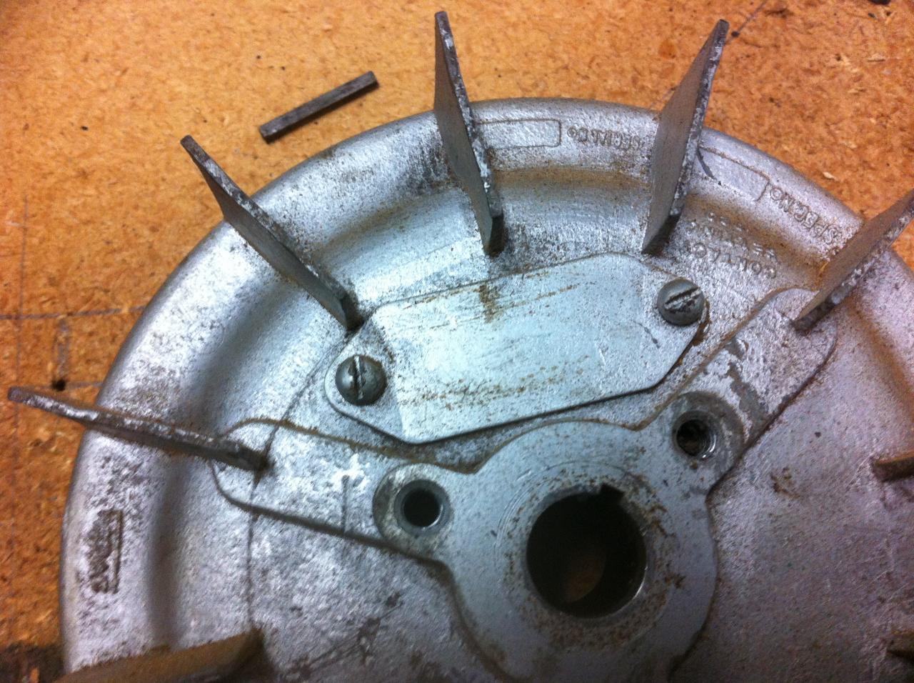

OK Jonesy what you have there in the top picture left to right.
Model 5 Special Series 2.(Has edger slot cover.Well done)Wrong air cleaner on it.Which is the same as your blue one.That one has the right air cleaner.
Right one is Model 5 Special Series 1 with the correct wheels.All model 5's had those wheels on them.Models 5's range from 1957-1960.The engine with the number 94828 is a Model 2 Rotomo.The ignition plate and flywheel are from that same model.It should have the same muffler as your spare engine.As far as the spare engine goes,have a look at the engine number.If it is 10,000 and under it could be a Model 1 Rotomo engine.10,000 and over it would be another model 2 engine.I'd say it is a Model 2 only due to the fact there are more around than Model 1's.Model 1 Rotomo 1955-56 and model 2 Rotomo is 1956-57. I hope this helps.

and yeah the spare engine number is 94828 so I asume it be a series 2 Rotomo so 56-57 new

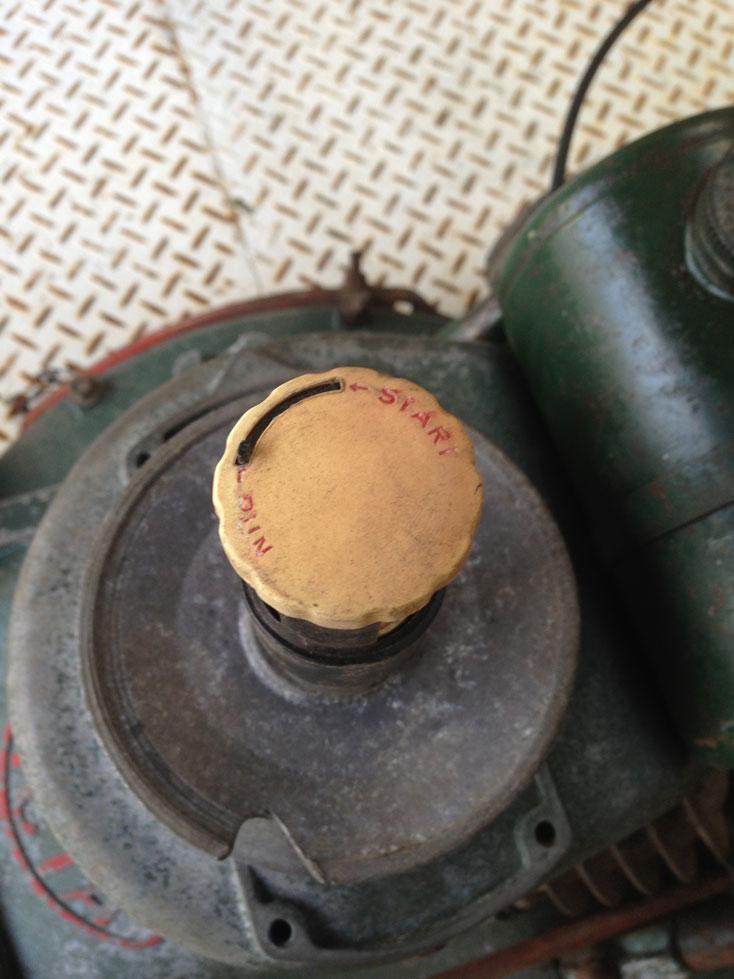

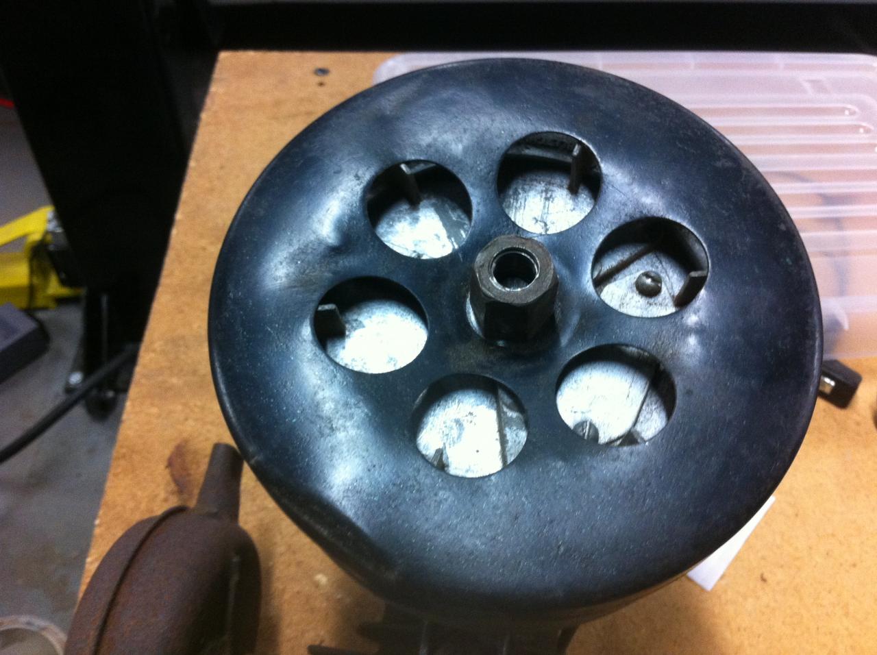

Blumby, what erea is the big black air cleaner off? and is the air cleaner on the blue one suposed to be on the short inlet tube or long one up the handle further?
cheers Jonesy.
jonesy #45939 17/05/13 02:52 PM
The black air cleaner actually started on the Model 5 special series 3.On the blue the hose is suppose to be high on the handles not as far as the throttle control.Like in this picture.

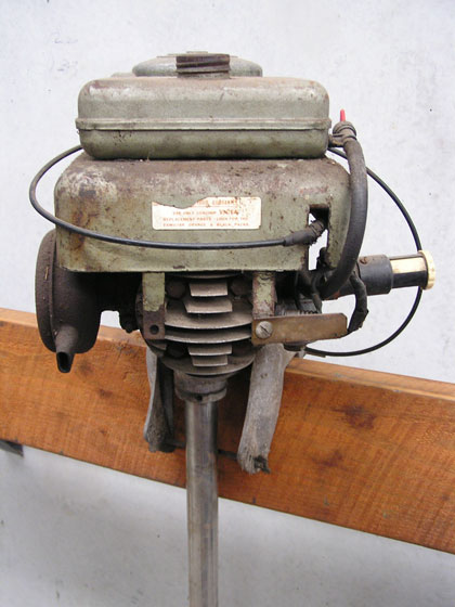

These next few photos is a Model 5 Special series 3.
As you can see no edger slot.
This one is my coffee table there are a few things that are not correct on it,but it was restored as it was found.
As far as which one to restore,why not do both? As far as which one is more desirable,well there both fairly common mowers and still not in short supply.The series 2 is not as common as the series 1,but in saying that there is still a lot still out there.The guys (like myself) that restore these ones don't do it for the dollars we do them for the love of it. Even a restored Model 5 doesn't fetch big dollars I guess due to there being so many still around.There are a lot more rarer mowers out there that bring in big dollars.So I say do both I am anyway.

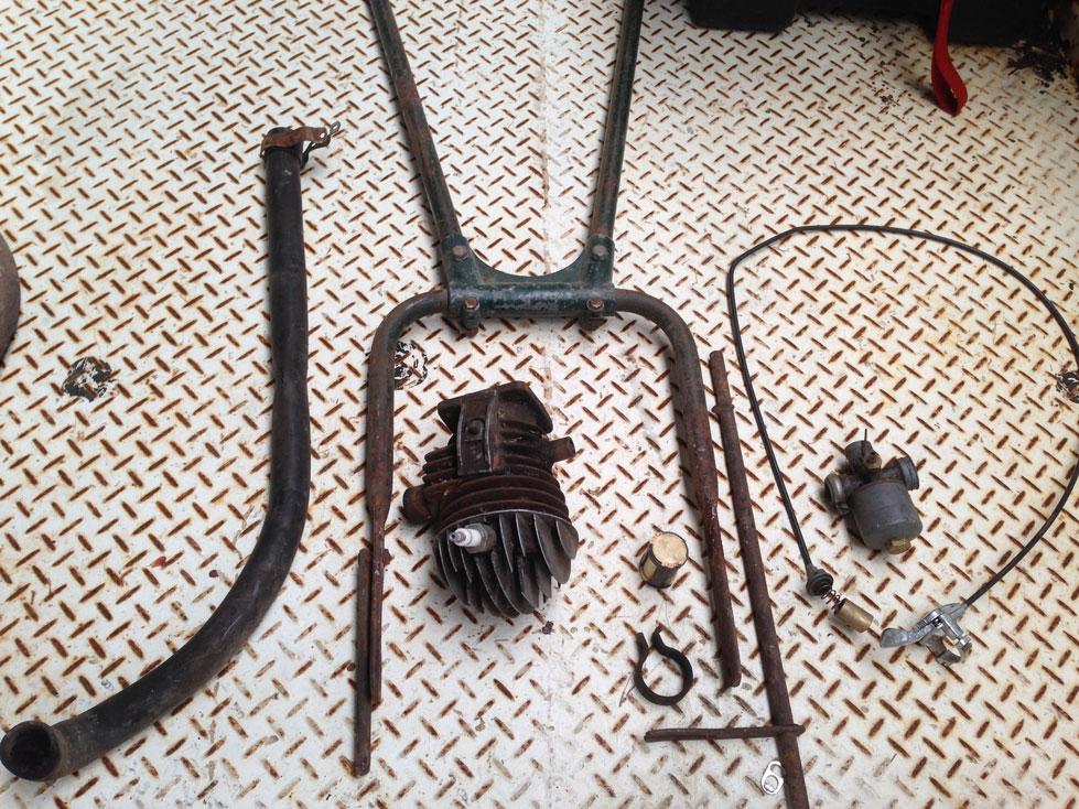

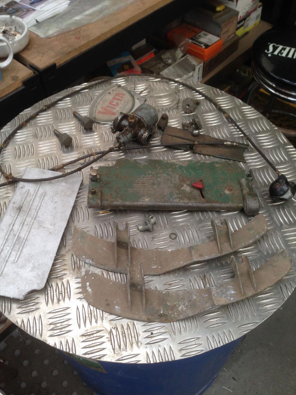

well guys I've been hunting bits down and trying to find more people with these mowers or bits and come across some more stuff, but the one thing I really like is the old starter handle for the steel cable starter, whitch he threw in once I said I would take the bits for $50, he also through in the long air cleaner tube (that I was after) and a good early crank. he told me he had an early steel cable starter some ware too and will give me a call when he finds it, he also has another special mostly complete and thinks he may sell it but not sure yet, what do you think? I think $50 was a decent deal. [Linked Image]
theres a new Std piston and rings there as well grin

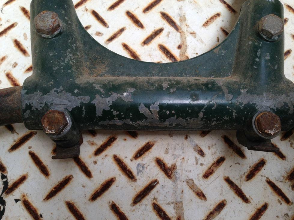

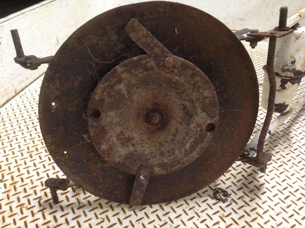

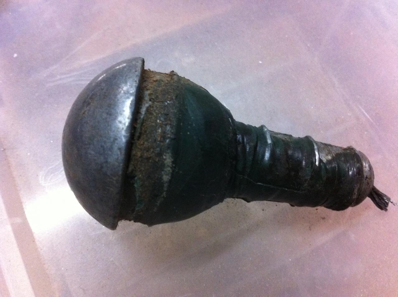

got a couple of closer shots of the handle, can anyone tell me what goes over the two halves to hold it together? as it had insulation tape on it when I got it. [Linked Image]
And my new wheels turned up today too, so a pretty good day in all.

Hi Jonesy. Looks like you have alot of spare parts for future restorations. smile Unfortunately I do not lnow the answer to your question. But there will be someone on this forum that knows. I look forward to the rest of your restoration.
Well done so far.
jonesy #46098 24/05/13 02:07 PM
this might help ? it looks like it has a rubber sleeve holding the two parts together , but i'm not going to pull mine apart unless i need too wink .. [Linked Image]
just hangin' in the shed waiting for the time !!! hope it helps cheers2 , Dave they were wire ??? wow , no wonder it has a big groove dug into it . learning all the time i guess lol

Well I have dropped off 3 bases and handles to get blasted, as they dont fit in my bench cabinet too well and pick them up Thurs morning, he's doing the handels Thurs morning for me so I can pick them up on the way home from night shift and can get them under primer straight away, Been busy soaking parts and cleaning up bits, going to take some parts to work as one of the guys that works under me does soda blasting as a side line so will see how they turn out,(he might be getting a lot more)if they are good grin
I picked up another Model 5 for $20 tonight has got some usefull parts on it, I will use the base as the base on the blue one was welded and had a bit more of a crack where one side of the handle bolts on, it's got a good air cleaner (just need to find the sponge for inside, it's even got the plug spannerclips in good condition, good starter & two reasonable wheels, I have stripped it down now and has got a good full exhaust (the plate is in the bin) the engine has had some water in it and is locked up but have that soaking for a few days, the magneto and points/coil all look good and petrol tank also good has a good rubber under the tank strap the carby is also soaking and may be a right off as its had water in it for a while I would say but you never know.
Oh yeah the handle bar clamp is also good with no holes drilled in it so that will give me 3 good ones, he said it has been sitting out the back of his shed half covered up with a bit of roofing iron, dont know which half because shes pretty rough lol

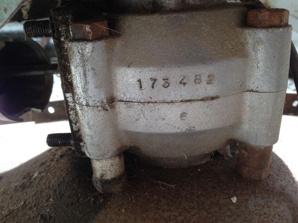

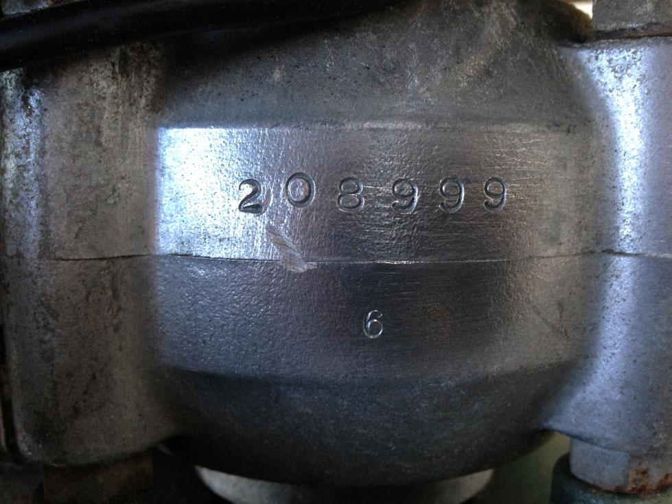

Just had a look at the engine # confused
does this make any sense to someone help2
jonesy #46164 27/05/13 09:27 AM
Yep that engine number sounds about right for that model.They really didn't make sense back then. Victa were selling so many that the numbering system wasn't that important.Also just be careful when pulling the model 5's apart,when pulling the muffler plate off.If you find a fibre gasket under there that is made of asbestos.

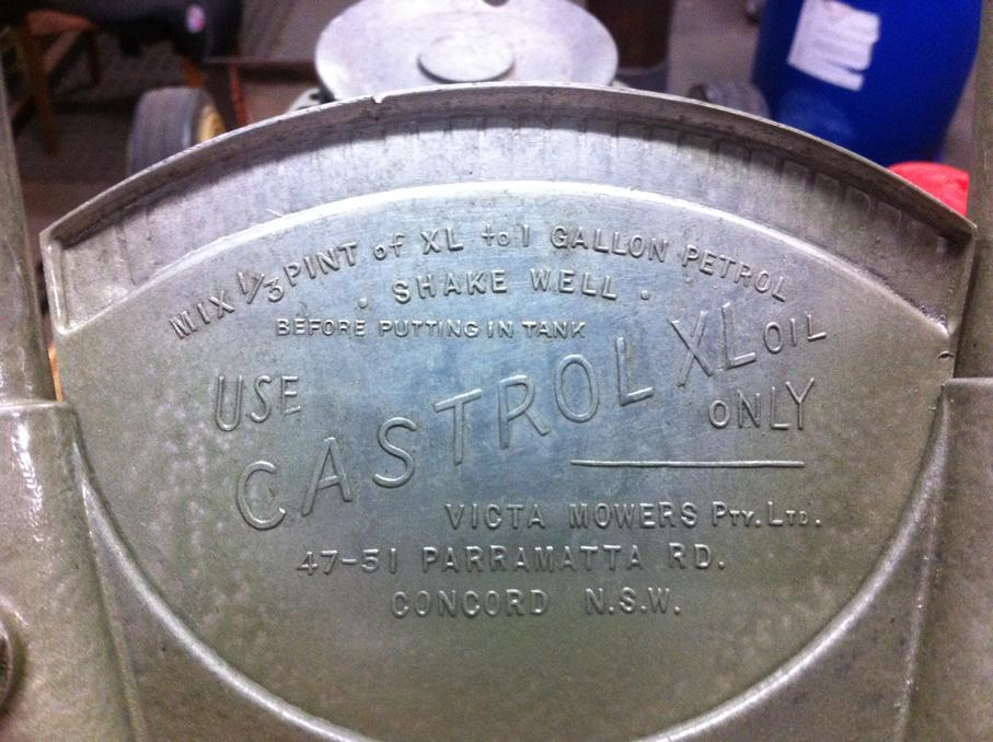

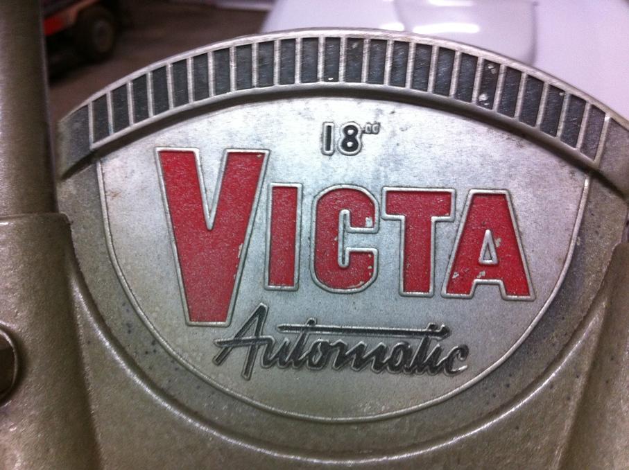

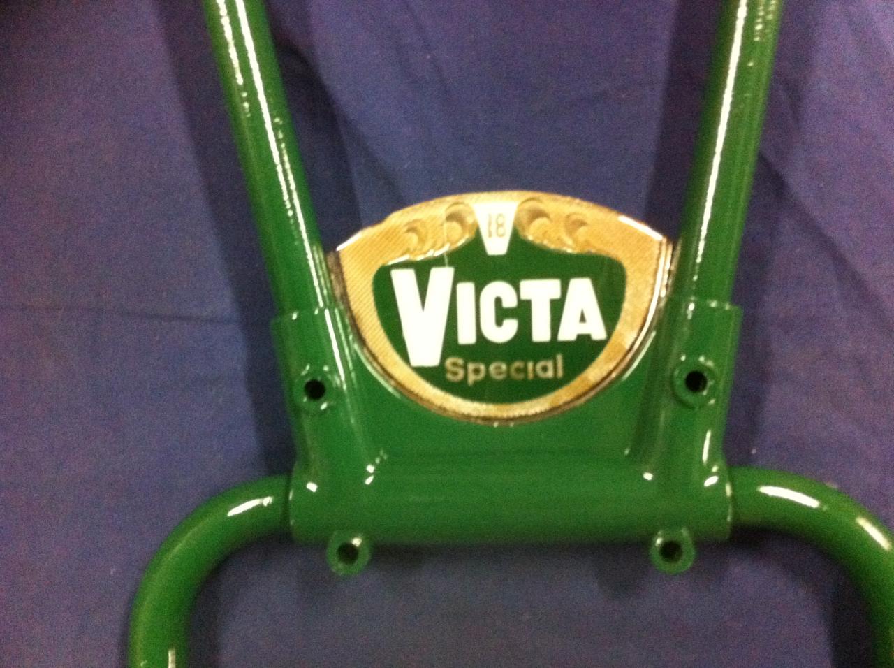

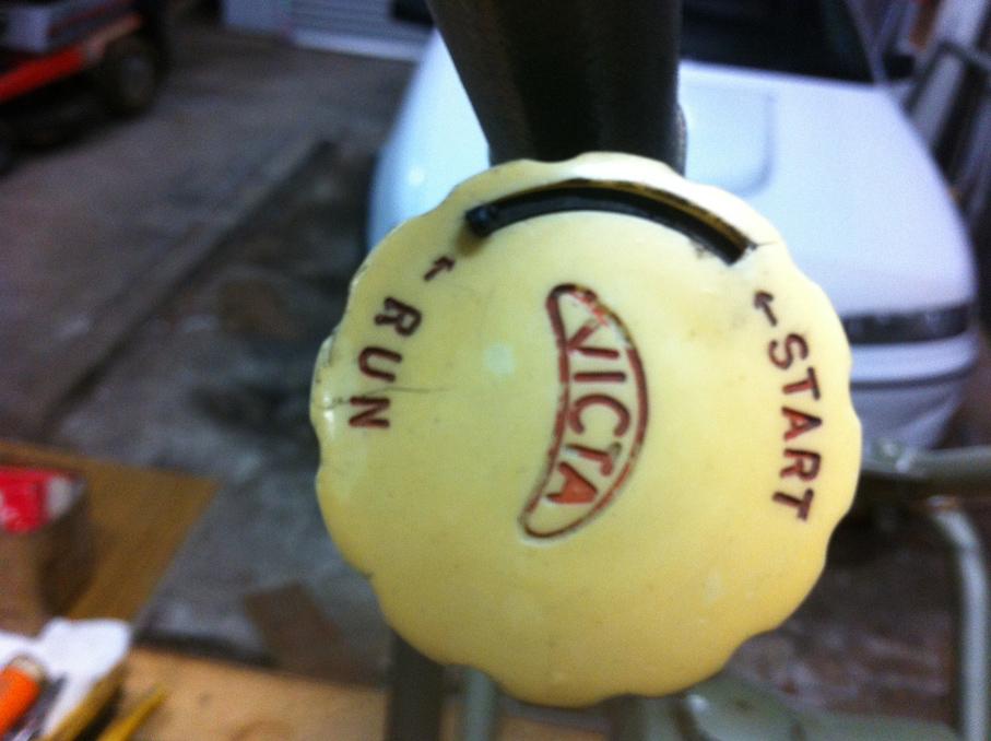

Also my Badge turned up today and is better condition than what I thought it was going to be. grin
So can anyone tell me is the area around the green suposed to be painted?
from what I can see it looks like it should probably ment to be silver?? help2
jonesy #46286 31/05/13 08:25 AM
Wow that does look like its in great condition. Yes the colours are right.

Posts: 539
Blumbly its a bit hard to tell from the photo but most of the silver around the green bit has gone except the bit that is hidden by the clamp, so what you are saying is all the back ground part is suposed to be silver? is this correct?
jonesy #46292 31/05/13 03:27 PM
It sure is.

thanks Blumbly, any info whats the best silver to match the original? looks a lot like a chrome paint, but in the 50's I would not have thought they would of had chrome paint back then.
jonesy #46302 01/06/13 03:14 AM
Hi Jonesy, is that an original badge, or is that a reproduction?
In any event, it looks brilliant....by the way...they could actually chrome over plastic back then, a lot of badge-work for electronic applications were. wink

OK thanks Deejay, it is an original, it has only tiny flaws in the clear plastic that covers the front of the badge that won't polish out, I did polish the front with some 3 step Novus plastic polish that I gought for my 4 wheeler, the white paint on the VICTA is perfect and I just touched up a couple of spots on the green bit as there was a couple of tiny patches you could just see through, so the silver is next, tried a small bit with some silver wheel paint I had but did not like the match so just wiped it off again, will buy some chrome paint and see how that looks, I payed a good dollar for it off Ebay with the handle bar clamp that was supposed to have been painted the corect green, but it wasent but I only have to sand down and paint again wih the mid brunswick green, I payed $130 for the two but have seen a lot worse condition badges sell for more so I was happy with it, seeing how the badge is a fair focal point of the mowers I payed the money.

Yes Darryl that is an original badge see in the centre part at the bottom there is a circle there.Inside the circle there is an A in that circle.The theory is the A is the original for the Model 5's.There was some badged which had a B in that circle.They were believed to be the replacement badges.Still old,as when you took your model 5 in for a service (At a Victa dealer)and the badge was broken,Victa would replace your broken badge for a new one,Free of charge.Now we have to pay a small fortune for them.I wish they were free now.

I just zoomed in on the spacial badge and (now armed with new info) it does have a "A" in the cenrre bottom, So could be, but still way too rich.

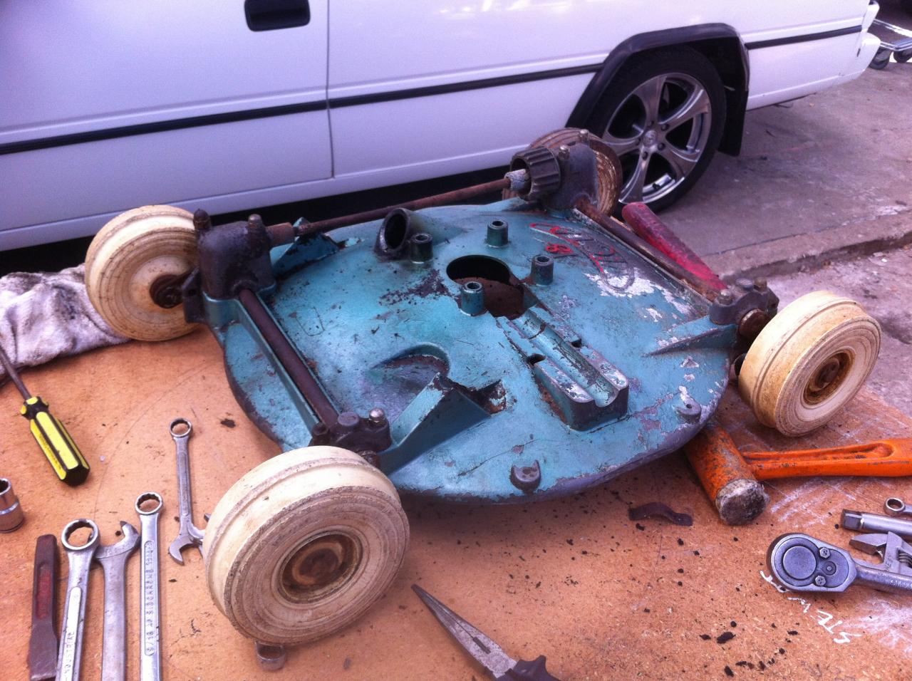

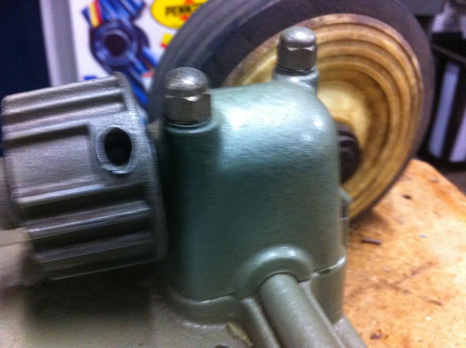

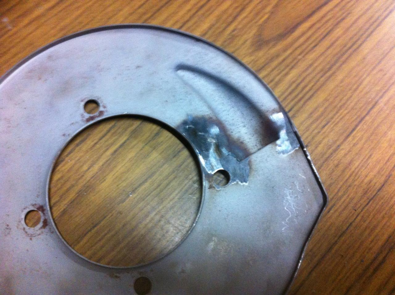

some pics of some bits I have finally started.
I also had a crack at painting with hammer tone for the first time on a base that had been welded up and just thought I would make it different and hang on the wall in the shed, might do the clock idea later, will do the 18 in silver when the paint dries a bit more.
Been mostly soaking and cleaning bits up but should start to take shape, will need to get some seals and bearings and gasket sets very soon.

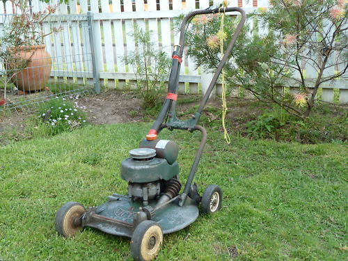

jonesy #46714 21/06/13 08:11 AM
Posts: 539

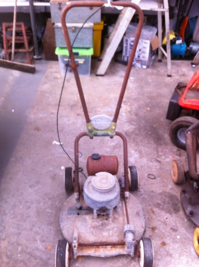

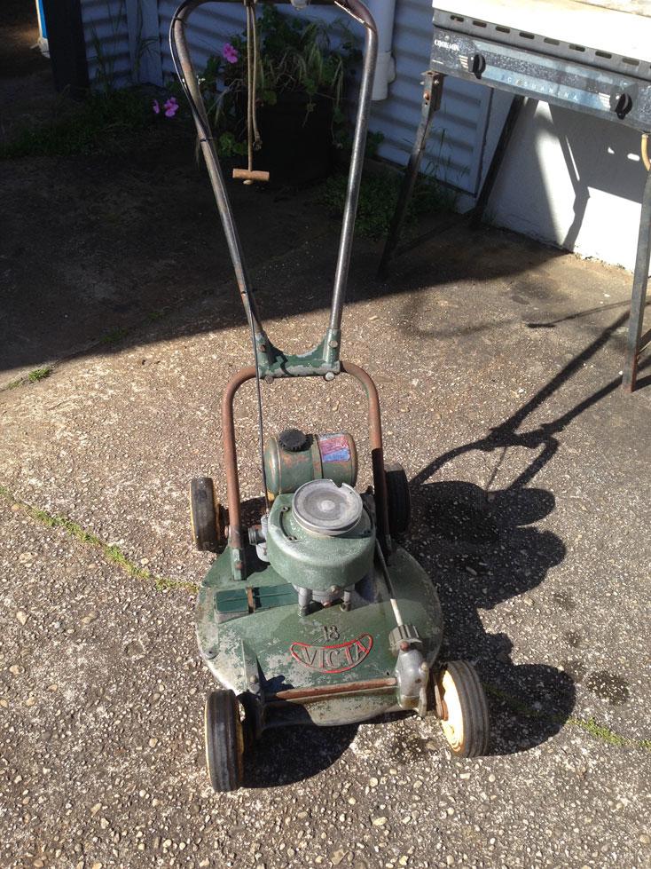

OK, so just look what I found.yay
Havent seen it in person yet but told him I will take it and will be going to pick it up as soon as I get back from work.
opinions please?
jonesy #46715 21/06/13 08:52 AM
Joined: Jun 2013
Posts: 170
Congrats Jonesy, looks like a ripper. How are your other restorations coming on?
jonesy #46718 21/06/13 09:32 AM
Its a model 4 standard. Looks like someone has restored it at some point. Although that did paint the boomerang red around the victa part.
jonesy #46719 21/06/13 09:53 AM
Hmmm,maybee a better score than he thinks...Seeminlgy a 4 special/STD,but whats the engine no? Be good to see the Prefix. Maybee another Predicta revert? That would make it a little bit more special. smile Nice score Jonesy...

been holding out on the engine number, it's 112,832 yay
jonesy #46722 21/06/13 10:40 AM
Nice work Jonesy...Ahh an early Fella.So that settles it then,it was once a Predicta inside the first 3,000 released. Just missed out on the oil nips. Obviously its missing its important bits,but still a good find. I personally think if you dont have a Predicta(which not many do) A revert is the next best thing as it was once and still is REAL, and not a model 4 Special/std produced after the Predictas had been pulled. Id re restore her to its original condition and keep your eye out for the hard to get bits down the track....you never know...Very good find:)
As for engine nos...We have all the engine nos from Mid Fan 1 right up until late model 5 Also the sheerline 6/9 with the latter 5s and sheerlines being a little sporadic,but fairly accurate. the later nos 60/70/80 sereies are held by a few other members who are very knowledgable in this area...Ty Blumbly Deejay and a few others,if you require a number,please ask smile
Im unsure if a common list has been compiled,as some members were discussing this,I think we need to in the future get together and see if we cant work out an accurate serial run for ALL members smile

jonesy #46725 21/06/13 11:44 AM
Naaa They wont be lost as im only 40 years young,lols. But agreed we need a list,might be a job for me to get into:) Ok so a Roto 2 your making it too easy for me.....ok the model 2 run went from aprox between 8,500-9,000 up until 100,000.
So yours falls into the mid run category. early line code should be 2 or 6 with some exceptions. definately has tin wheels (circlip axles)which ran up until approximately the mid 75,000 then the remainder where the plastic wheels. red embossed smiley face choke,circlip carby,central bun muffler,metal T/C plastic for some later. ESS pulley(LRG stamped)Model 2 badge with straight 18 not curved as for the model 1,and offset front axle mounts(not straight as for model 1) Thats about it. one additional( some early model 2 Rotos ran model 1 parts,not so much chassis but head,barrel and brass nut carby,have seen some examples right up into the 40,000s. these parts are also a lot harder to find.

Damn, thanks mate! That info is a great help. When you say red embossed choke, is this the one you mean?
[Linked Image from i.ebayimg.com]
Also, sorry to hijack your thread, Jonesy wink

OK I'm back and I'm stoked, chech out the photos (heaps of em)first the over all.
Now the engine number.
badge in good condition, only a bit of overspray.
only 3 side extention bolts but they are complete with cups and springs.
And it does have oil nips, question how do the plugs come out are they just pushed in or threaded?
No slit.
Air cleaner/choke, has red writing.

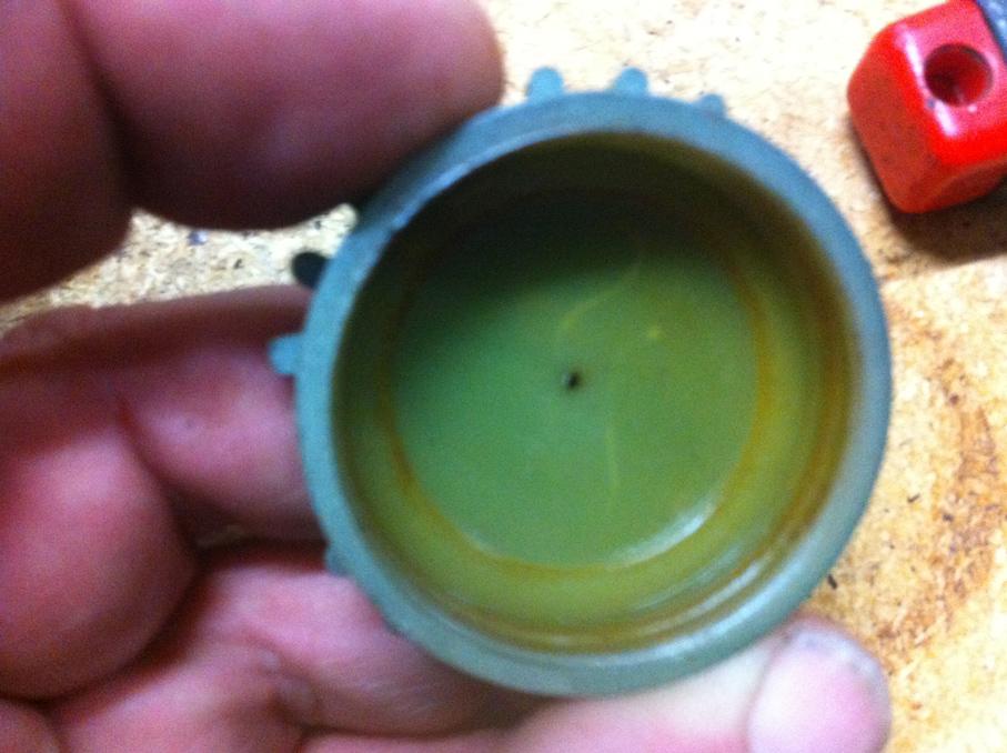

Fuel cap is green.
[img]https://www.outdoorking-forum.com.au/forum/uploads/usergals/2013/06/full-6801-11299-cap_top.jpg[/img]
[img]https://www.outdoorking-forum.com.au/forum/uploads/usergals/2013/06/full-6801-11300-inside_cap.jpg[/img]
[img]https://www.outdoorking-forum.com.au/forum/uploads/usergals/2013/06/full-6801-11301-inside_cap_2.jpg[/img]
Cigar tap.
[img]https://www.outdoorking-forum.com.au/forum/uploads/usergals/2013/06/full-6801-11302-cigar_fuel_tap.jpg[/img]
Two cable carby.
[img]https://www.outdoorking-forum.com.au/forum/uploads/usergals/2013/06/full-6801-11303-2_cable_carby.jpg[/img]
Groove cover nuts and bolts.
[img]https://www.outdoorking-forum.com.au/forum/uploads/usergals/2013/06/full-6801-11304-groove_cover_nuts.jpg[/img]
the wheels are in very reasonable condition and will see how they clean up as I would like to keep as much of the original bits on it as I can, one hub cap is missing and one has had the center V rubbed off but thats no biggy, well I am very happy with the condition with the mower and it runs very well also, maybe just a brush up of the pionts and check the timing it should be sweet. that will do for now, I think the $150 was cheap.

Wow jonsey I'm not sure you really know what you have there.With that engine number and the extra bits I can tell you that when that left Victa it was a genuine Model 4 Automatic.Will all the flaps and guards.With the bolts around the edges they are screwed in.If you decide to remove them make sure you soak the hell out of them with something like oil for a long time.Remove the extra paint etc.They may still even break I can see one has already.The problem is they are steel that has rusted in alloy.Very difficult to get out without breaking.You still have on there the original small height adjuster with the caps on.Mine doesn't even have that. congrats and welcome to the non-complete automatic club.Well done that was a great score.
jonesy #46828 24/06/13 04:59 PM
Posts: 539
yep I know what I got, yay the guard bolts I have just taken out OK, very carefully and with some Inox to help, without trying I'm after the info about the oil nip plugs for lack of a technical term so will leave them until someone comes forward with how they fit in as the front one alreadt has a bit chipped off it, something else has me stumped as well, it's what type of tool do you use to take the grub screw that goes into the shaft of the wheel adjuster, it's the one you can see from the outside of the axel housing as I have got quite a few that need stripping down and freeing up, after looking at the choke the other picture that was put into the post does not have the sad smiley face on it, I thought the predictor was suppose to have the one like mine does only have black writing on it, but blue mentioned the other one was correct also, did they come out with both types? I was also wondering if everything else is so correct with this mower why would it have red writing and be wrong, what other models had the sad smiley face choke I wonder, also when I was taking out the guard bolts I did notice one that did not have a domed/rounded head so it might be a ring in also. will take a photo of the grub screw I am talking about if ya's cant work out from my discription.
any help please?

The automatic didn't have a throttle control. It was controlled by the front and rear flap. Of which there was a cable connected to the front and rear flap. So you had a cable coming from both. They both connected to the carby. So both cables went into that brass fitting. That's why there's two holes there. It was surpose to rev the engine as the flaps went over higher grass and less for lower grass. The theory was good but apperantly this failed and that's why the project was scrapped. Most automatics were then converted back to the throttle type like your has.Hems making them rare and very collectible with all the gear still on them. As not all were converted. There was only 10,000 full automatics produced. How many are left who knows.

Here she is. Front flap still is not connected, as is NOS and dont want to knock it about until the mower is cleaned up. Overall, she is missing more bits than she has (starter cup and handle,side skirts, tail flap, and correct choke) but with a number in the low 117 thousands, she seems to be pretty sound and worthy of preserving. I'm yet to strip her down and clean her up, and am still unsure if I should go ahead with a full resto or leave her as is. Most of the paint is gone from the deck, so I may end up restoring, but I do prefer original and unrestored mowers, when the condition warrants it.
[Linked Image from i.imgur.com] [Linked Image from i.imgur.com] [Linked Image from i.imgur.com] [Linked Image from i.imgur.com]
Joined: Jun 2013
Posts: 170
Thought I would throw up a few pics of the front flap, as they are pretty rare, especially in NOS condition as this one is. It had been sitting in the same cardboard box on a shelf since 1958, with a note saying "very desirable"....I'll say! grin Even came with an extra cable and an alloy piece I'm yet to identify (see the last few images). I'm pretty sure it is the adapter and spring for the rear flap cable, but I'm sure you guys will be able to set me straight and ID it for me. Another interesting feature are the clips on the cables. Are they intended to be screwed to the holes next to the axle hounsing? Any thoughts? [Linked Image from i.imgur.com] [Linked Image from i.imgur.com] [Linked Image from i.imgur.com] [Linked Image from i.imgur.com] [Linked Image from i.imgur.com] [Linked Image from i.imgur.com] [Linked Image from i.imgur.com] [Linked Image from i.imgur.com]

Don't suppose anyone has a solution for removing a broken side skirt bolt from a Predicta base? Putting a drill bit anywhere near the alloy has me pretty worried
jonesy #46974 29/06/13 03:01 PM
Yes drill it out....1 Face the bolt,perfect centre punch. cobalt drills if you got em,if not HSS is fine,just go nice and slow with lots of lube.Step up your drills a good tapping compound,easy out if you have one. then retap. 1/4 UNC 20. 2 Heat the alloy with a torch,not the bolt,a few hits with a hammer quench and repeat 3 times or so. if the undeside is poking through see if you can vice it out after you have heated it..note if your going to drill it dont use the heat option as it will harden the bolt,making it near impossible to drill with HSS...if its only one bolt go for it..YOU CAN DOO IT! if its more than one,like another base I saw here,then just get another base,should be around 20.00 and save you a heap of time...OR i can post you my hands and they can do it for you....lols

well another question, everything about these mowers there are small differences! below are two different types of cigar fuel taps I have, I also have one different again, as it has the little circlip type retainer but has the same knerl as the one with the two hex nuts on both ends, so what one goes on what year mowers?? help2
the one on the left is the one that came off my Predicta. the one not pictured I discribed also came on a model 4 I got but dont know about the one on the right.
jonesy #47240 12/07/13 03:10 AM
The one on the left does look like the correct one for the model 4 automatic. The other circlip type I believe was what the rotomos had. Like the model 2 and 2a.
jonesy #47246 12/07/13 05:14 AM
Agreed....The one on the left is definately Predicta/4. The other style is A/M. A mate owned a mower shop 25 years ago and Im still sure he has boxes of them,he bought them of an A/M supplier around this time. They come up on Ebay from time to time but no one bids as they arent original. The late Roto 2,2a and Predicta shared the same fuel tap( The one on the left). There are no other Genuine tap styles for these models that im aware of,only the one on the left...:) BUT if someone would be kind enough to verify or correct me that the one on the right as being
Rotomo or 2a,Im going to get the whole lot off my mate!!!! lols.
jonesy #47253 12/07/13 08:32 AM
Posts: 539
Here is the other one on a Model 4 that seems original, note the knerl the same as the one on the left but with the circlip type bottom, probably more like what you mean Blumbly?
jonesy #47256 12/07/13 10:23 AM
Hmmm Interesting...2 options,It has had the original style sleeve put on it,or there is another tap? Its consitency in styling to the aftermarket one on the right is seemingly exact but for the sleeve...Let me look into this one further as I still maintain there is only the one style made for this period of mowers,and the AM ones came out later as a replacement,possibly in the 60,s...Anyone else know of another Variant for the Rotos and Predicta? Id really like to know as well so I can amend my own records. Either way the one on the left we know is of the correct styling,and accurate for your Predicta Jonesy smile

Ok,If you can verify the Automatic went past 118 thou that's fine. I would dearly love to see some documentation for the archives as well as my own records. Someone needs to set the record straight once and for all, maybe you can wink
The main reason for our assumption of the 117,000-118,000 Automatic end, is mostly due to original examples of model 4 STDS and Specials that have been seen to have started around this serial run.
Since they often came with some Auto parts, this is when most thought was the Automatics Demise, and redistribution of remaining parts. We do know for certain these models got the remaining parts as there are quite a few originally owned examples wink
As Blumbly says we can only rely on what we know and by examples we can see. ( and more are coming up all the time)
Its only recently all these higher number Automatics are starting to come to light. So If you say yours is genuine and never been touched then I cannot dispute the fact, nor would I question it, it is what it is, and your lucky to have an Automatic in any case.
I don't think anyone will ever know how many model 4s were made with the predicta setup, but with each original example to come up, we finally might start to see an accurate picture, as this remains the last of the early Victas we really aren't 100% sure about its series run wink
I would love to see some images of your machine, if you wouldn't mind, its always good to see another, in the forums.
Thanks for your input Kyle,hopefully others will come forward and attest to the higher serial run also, and maybe even an original owner who bought his new.
Yes "Predicta " is mentioned quite a lot in the original manual, but the manual title is Victa 18 "Automatic",so yes, Blumbly It is a Victa Automatic...The term "Predicta" is the name for the system set up; not the mower.
We call it a "Predicta" because this set up is how we all came to know this mower, and distinguish it from a plain Victa with an Automatic badge smile
Either way, they are both correct...just my opinion smile

Well just thought I would put up a couple of pics of some parts I've started cleaning up from my Model 4 Auto #112832, I also have most of the base and cowling stripped ready for etch primer, still to hone the barrel and measure it up to see if just new rings required or go oversize, got all gaskets needed and seals, still have to get some bearings. (heaps still to do,I get distracted too easily :))
NOS fuel tank & strap stripped back and etch primed also case bolts etc cleaned up.
A couple of carbys in the cleaning prosess.
Cases are getting close to clean.
Some more bits at the initial cleaning stage.
I am only guessing but is this a standard bore size piston??
will get some more pics up soon.
jonesy #49023 30/08/13 03:10 PM
Posts: 104
Small Engine Technician
Thanks for the update Jonesy. Parts look very shiny. We're they just cleaned up and polished? Or we're they painted. Either way, it looks very good so far. I love seeing other people's restorations in action. smile
jonesy #49024 30/08/13 03:40 PM
Posts: 539
James, I'm not painting anything that was'nt painted from factory, and do not want to polish either as thats not how they came out, some of the stuff still looks a bit shiny but I am hoping they will dull off a bit, the only things I feel I might have to paint are things that are steel and may rust, but will look into plating of some sort as that would be prefrable.

well I bought this for $30.75 on Ebay.
Ok, so I was really only after some parts off it, (really one part)
Spot it yet????
yay got it for one of my Model 4's, all I got sent to me was the Choke, carby & muffler, I would have liked the whole thing but due to freight was not worth it, but just those parts were worth it.

Also picked up a nice, relativly early series 1 in pretty good nik, and with the 8 tab toe ring from the correct erea.
also come with a box of bits.
the tin of Avocardo pait is near full and is worth more than what I paid for the whole mower so I am stoked. grin

Well Guys got a good score the other day from the guy who is going to bring me a (to be confirmed yet) 1955 Rotomo when he has burnt the wood stacked around it, this was sitting under his shack so he gave it to me, a Rotomo model 3, a few bits missing but it is my first Rotomo so I am stoked, dont really know why the barrel was taken off as the piston and bore look good.

Any advise on the "S" on the bottom case??? I have not seen one like it before.
cheers.
jonesy #50719 26/11/13 04:15 AM
They lost the #5 punch that day and used an S.... Seen X few times now and blank lowers,also serials on lowers. Dont remember any letters other than store/repairers markings. S is close enough to a 5 so I dont think there is a mystery? Somone may know otherwise...Nice score Btw. smile

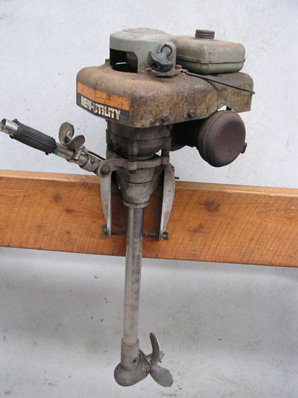

Some of you Rotomo buffs may be able to help me with identifying what model this base is I was just given, seems all very straight, it has a couple of makeshift brackets made for the back axel supports, the tank does not have any dents and is very clean inside, pitty it does not have a cap, the axel stubs do not so much wear either, a good score for a freeby, the flywheel cover is straight but the top hat pully is broken cry any advise would be great thanks.
The pully has ESS on the underside and has next to no chamfer on the edge of the Top hat so am I correct in asuming this was a Model 1 pully? so with a bit of luck I may have my first Romoto Model 1 base grin also does not appear to have any additional welds put on the axel supports on the base which a lot do, Oh and the tank has the wrong tap but I have plenty of other mowers that can use this one, cheers.
jonesy #51934 27/12/13 04:00 PM
Hi Jonesy, and ODK members,
From my untrained eye, I would say that is a Model 1 Rotomo base...It doesn't seem to have the deep dish of the Model 2, seen here:
The tank looks in very good nick....
All in all, congrats and a good score there mate!
jonesy #51941 28/12/13 01:06 AM
Model 1 & 2 bases are exactly the same the only different's is some model 1's (not all) had a different axel height. Yes it is a model starter but I think it's all done now. Good find thought.
jonesy #51950 28/12/13 04:19 AM

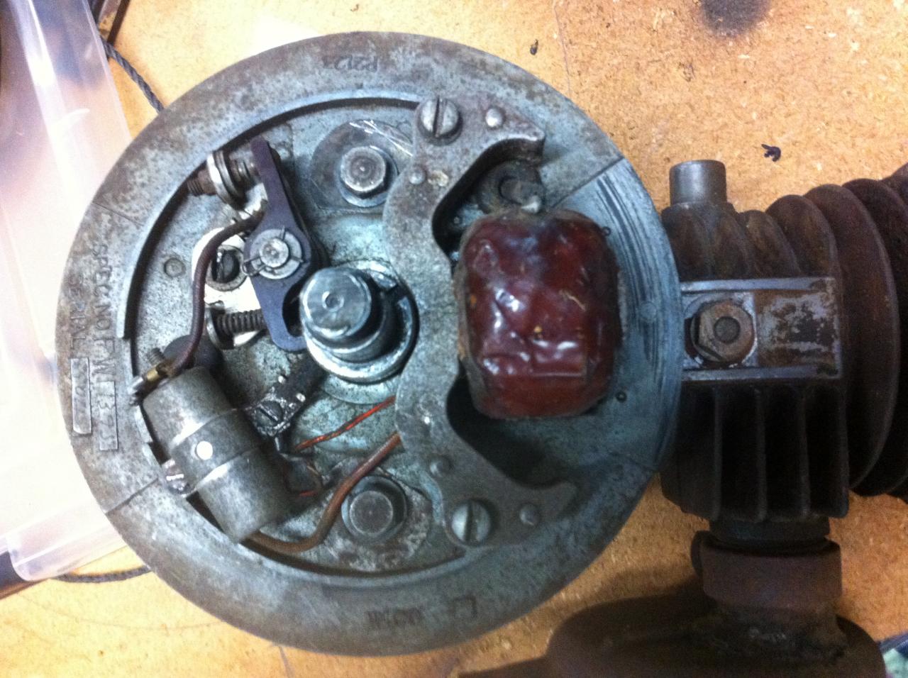

Well Got it running, with just a brush up of the points and bit of a clean of the coil & flywheel clean up, wasnt bad, the points and condenser dont look that old, the timing was way off. so Here it is running.
jonesy #54153 05/03/14 06:18 AM
Posts: 539
Hey guys, just after some help and info as I have not been able to find anything on the colour of toe rings, does anyone know if they ever came out in hammertone colour or were they the same as the handles, solid mid or Brunswick green, from what I have been able to gather so far is the Model 4 Automatic had the side skirts painted in hammertone and possibly some later Utilities could of had the hammertone toe ring (I may well be wrong too) I am in the thinking that from the early Romoto through the Model 5 range were of the solid Brunwick green colour, what have others found or know as correct?? help2
jonesy #54158 05/03/14 07:36 AM
Never known them to be anything other than Dark green Jonesy. Havnt seen a variant other than As you said that the auto skirts were avocado. Model 2 2a and 3 are definately dark green, as for 4 and 5 I cannot confirm 100% but all originals ive seen were dark green. I have seen restored rings in hammered finish. Restorers preference I guess and they are usually in alpine green hammer spray,not even avocado. Anyways ive only had a few with traces of colour and they were dark green:)
jonesy #54159 05/03/14 09:02 AM
Posts: 539
Thanks Blue, at least this confirms what my initial thoughts were.

Was just browsing old Ebay and came across this gem, earlier I posted an engine No of 283737 over S that was on a model 5 series 1, I picked up, here is a model 5 series 1 with an S on the lower crankcase also, it has a larger S than the one of mine and is around 10K later engine No, No real point here but just thought it interesting.
how many other lower crankcase letters out there???
jonesy #54188 06/03/14 01:59 AM
It is an odd one Jonesy...Not sure its relevance,what is interesting is this is the small numbering and the S is uniform size to the numbers. You say yours is smaller,and this is the smallest stamping Victa used so it is quite odd. There are a few theories as discussed previously,but seriously ive not come across any other letters only blank lowers....But youve got a keen eye and id like to know its meaning if any someday,as it definately falls in the mower series run and not a tiger or other variant.
jonesy #54194 06/03/14 05:34 AM
Posts: 539
Here they are side by side.
small s
jonesy #54197 06/03/14 07:14 AM
Thats a horrible mating for a special jonesy. Another theory may be a replacement lower in warranty? Probably wouldnt be marked as normal. A replacement part after warranty or from spares would be unmarked as its not assigned to a model or series run....

Posts: 539
So got some more goodies to go towards the Model 4, 112832 over 2 grin
woot
jonesy #55768 18/05/14 06:16 AM
Hmmmmm....Those parts look very familiar....lmao. Well thats pretty much your auto nearly complete bar a few bits.....Very impressive Jonesy!
Back to your S Ref, I forgot when i was doing my marine, the engine has your small S also...hmmmm. maybee does require some more examination.:)

Just thought I would put up some pics of the parts donor mower here.
Vidoe link to the old girl running HERE!
jonesy #55804 19/05/14 03:08 AM
Lols....yeah i left that one,but im heaps happy you got it and at a reasonable price too. Correct engine on the donor to will be of value for trade or sale for other bits your after too or of course for any of your incompletes....ive lost track of how many you have now lols. Well done mate! Just need get you back into restore mode so we can see some of these gems come to life! I knew the parts were familiar at first sight ha ha.....now who did buy that fan Mk1?hmmmmm? Lols
