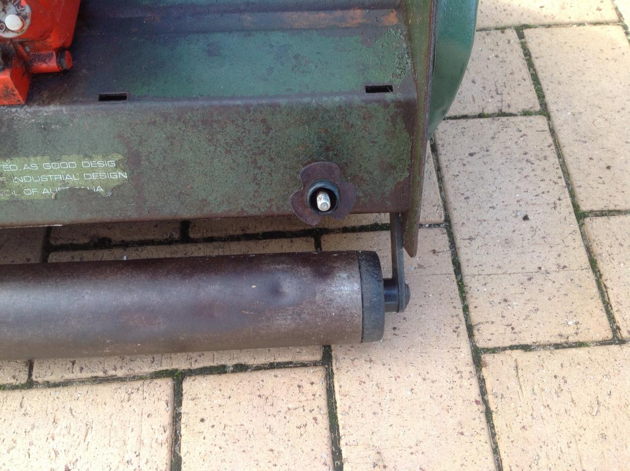

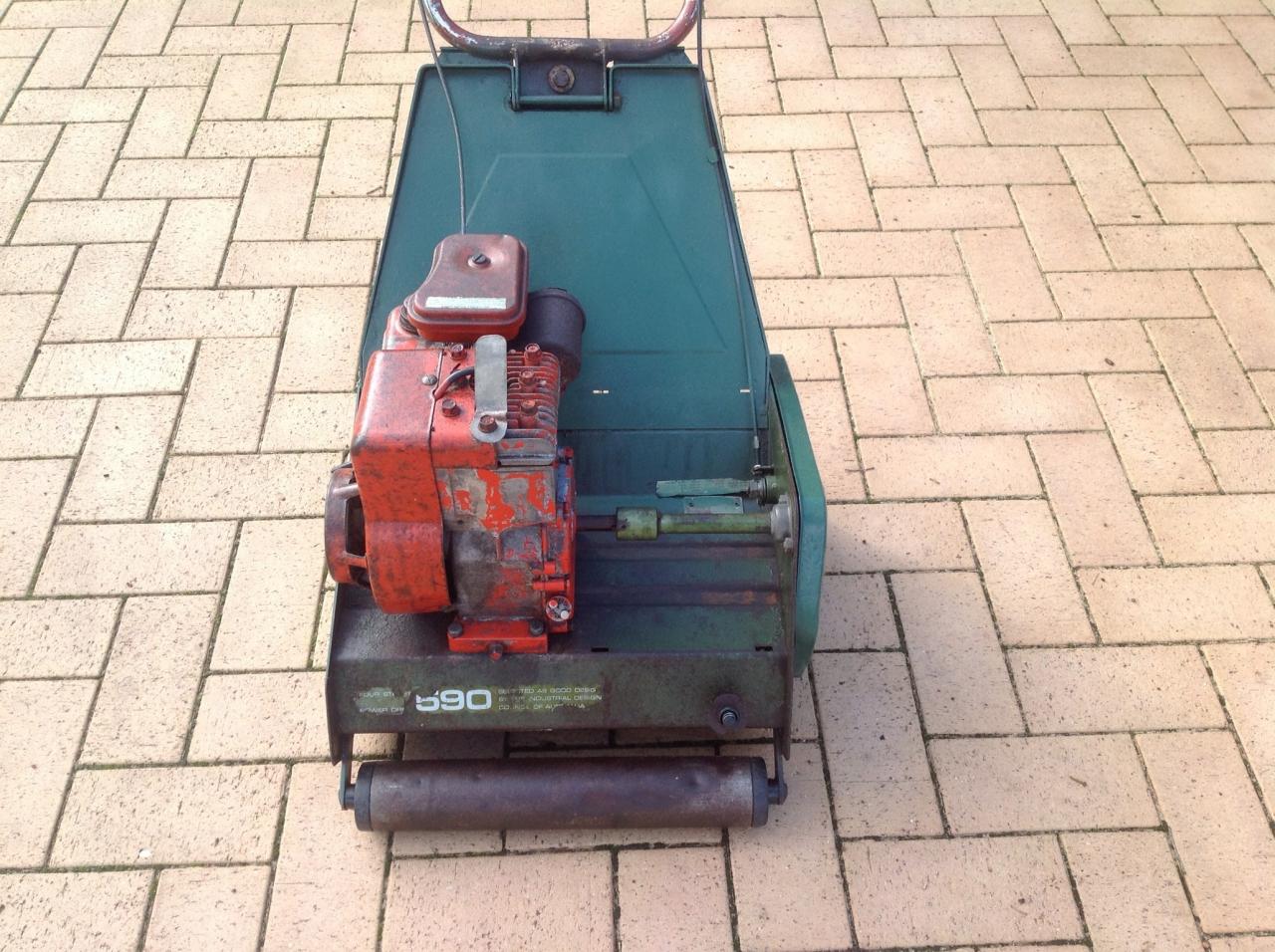

Rescued a Scott Bonnard reel mower model 590 from a roadside collection and with a bit of TLC have managed to get it going pretty good. I'm a novice when it comes to reel mowers so I have lots of questions to ask the gurus out there. For this post, I would like to find out more on the height adjustment for this model. I have included photos.
I assume that the height adjuster is the item in the bottom right corner on my photos. There is a plastic cover with circle marks on it which screws onto a thread. There is also a metal flange which looks like a '3 leaf clover'. Which of these items needs to be turned/screwed to affect the height adjustment? I have tried turning both clockwise & anti-clockwise but seems to have no effect on the height adjustment. Maybe it's not working/busted and I need to get creative and find a workaround? It looks like the height adjustment is linked to the roller at the front - raises or lowers the roller - is that correct?

You are missing the "knob" that adjusts the height, that "3 leaf clover" might be the remains of it.
The plastic bit with the circle marks sits inside the knob and is just a useless height indicator.
Because you have no adjustment knob the machine will be at it's lowest setting.
Try to source a knob or maybe try a dirty big nut on the thread instead as you screw clockwise it will lift the height.

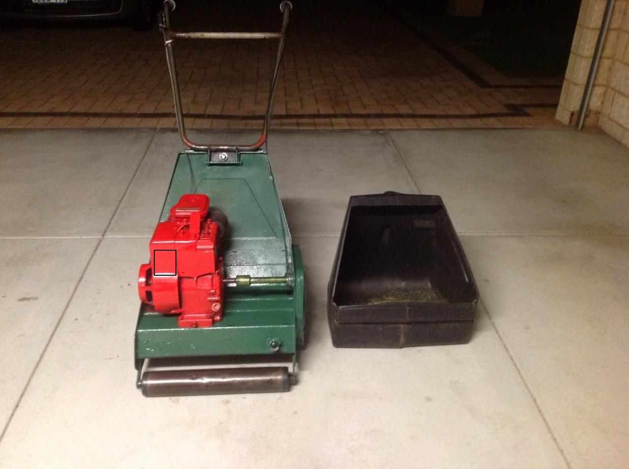

I do have a catcher so it sounds like I got lucky there (we found this mower at a roadside collection - someone had just thrown it out) - see photo.

Hi Pat, the numbers (Type, Code etc) are stamped on the air cowling of the Briggs engine....see the black rectangle area I marked on your engine...Here's a pic....
Don't forget to post the whole string of numbers, this will give us the date of manufacture of the engine and the approximate age of your machine. wink
