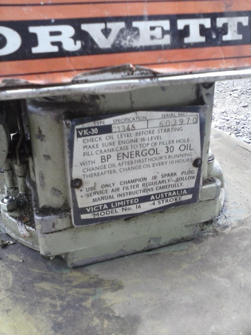

Hey Found this one on Saturday was at a deceased estate and was in pieces the more i looked the more of it we found, put it together last night it ran for a few seconds till Crack ! seems we over looked the flywheel bolt being loose - wanted flywheel to suit. never seen one before on this base. according to the book its a 1964 corvette 4 v29.
looks ok too good1 they had a gold base ? i think blumby has one i seen agas ago here . i'll go look outside i think i have a flywheel somewhere . looks a similar base to corvette 2 . good luck with it smile

nah gold is pressure pack over the original green yeah its very similar to the corvette 2 except the optional side throw shute is on the opposite side.

hey guys got the corvette 4 going on the weekend thanks to bluegmhtmonaro supplying the flywheel , dismantled and gave it a tidy up resealed crank case and replaced lower seal runs a treat starts first go ,its in better condition mechanically after 40 years than a 3 year old mower these days are.
