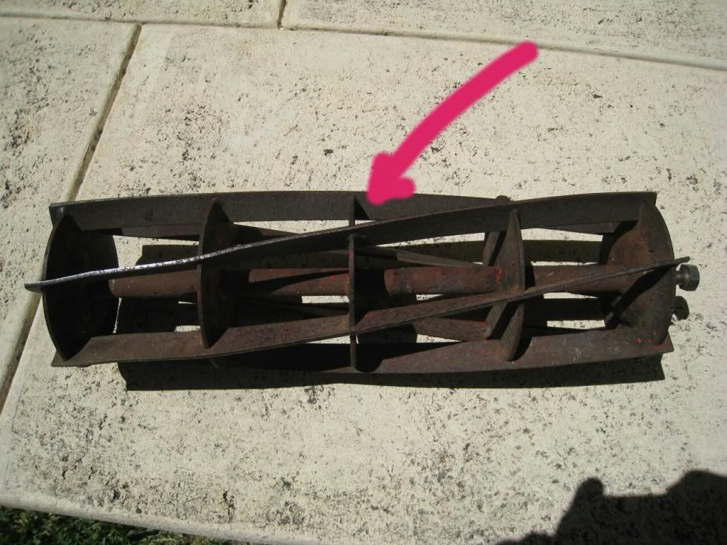

Thanks again Deejay. I have had a look today at the reel and not sure how much 'meat' they need on the blades for long life, mine is about 5 mm from the top of the blade to the circular holder, is this enough?
Hi Kynan, can you please post a pic of the cylinder reel, I would like to have a look myself....5mm is not much.....

Hi Deejay, I have included a pic of the reel. If it cannot be saved is it compatible with any other model as I dont beleive I will likely find another.

try again....
Hi Kynan, and thanks for posting the pic so promptly.
Mate, I hate to be the bearer of bad tidings....but that reel is shot and looks like it has had a hard life....especially with the wavy blade. It has had its chips. cry
That reel is not compatible with an SB Model 45 nor any other model as far as I know.
However, there may be light at the end of the tunnel, I have sent you a PM; (just have a look for a flashing envelope on the top toolbar next to "My Stuff")
Please let us know how you get on. wink

It looks like it has plenty of meat on it, but yes the blades edge looks pretty wavy. I thought they straightened the edge before they turn the reel up the reel on the lathe. I recently had my reel sharpened on my 430, and it had less than 2mm of meat left on the reel. The machinist said thats fine. smile
Hi Jason and thanks for the post. If you take a close look at the blade depth above the center spacer on the blade in the background.....you will see there's not much "meat" left, and a blade that wavy may have to be replaced, as the whole blade is bent. It is just not worth it in the long run.
But, that is just my opinion. for what its worth. wink
I know what you mean now. Hopefully its easy finding a replacement reel [Linked Image from i304.photobucket.com]
