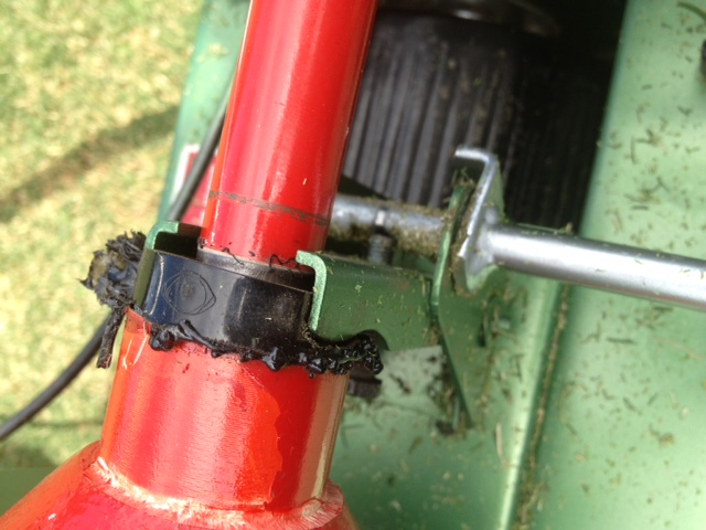

1: I have melted the thrust pad for the clutch.
Why would this have happened?
I changed the spring in the clutch so now the clutch is a lot tighter.
I didn't change the cork however as it seemed to me to be all intact still.
could it be heating up to much due to friction? it was almost to hot to touch.

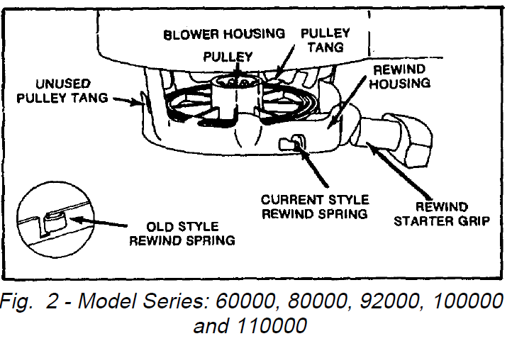

There is no known internal problem with your engine, your recoil starter is simply acting up. First, please post the long string of numbers stamped on the cooling air cowl of your Briggs engine (Model, Type and Code). I'm currently guessing the Model is 80202 and the starter looks like this:

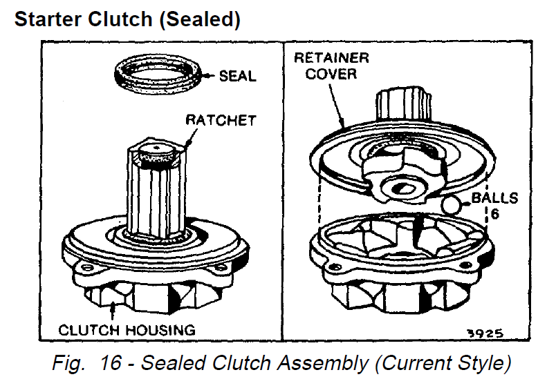

The internals of that starter look like this:
The starter engages and disengages by the use of 5 sprags: inclined planes, with balls that roll up them to jam between the internal and external inclined planes. Over time, sooner or later the central bearing will need to be cleaned and have one drop of oil applied, but unfortunately someone will either put oil in the whole thing, or spray it with WD40, thinking that will help. It won't: the oil will oxidise, forming glue, which will stick the balls in their storage compartment, so they fail to roll up the planes when you pull the rope. When this happens you have to remove and dismantle the starter, clean all traces of oil and glue from its innards, dry it off, put one drop of oil on its spindle, and put it back together. It should then be trouble free for years.
Here are the detailed instructions:

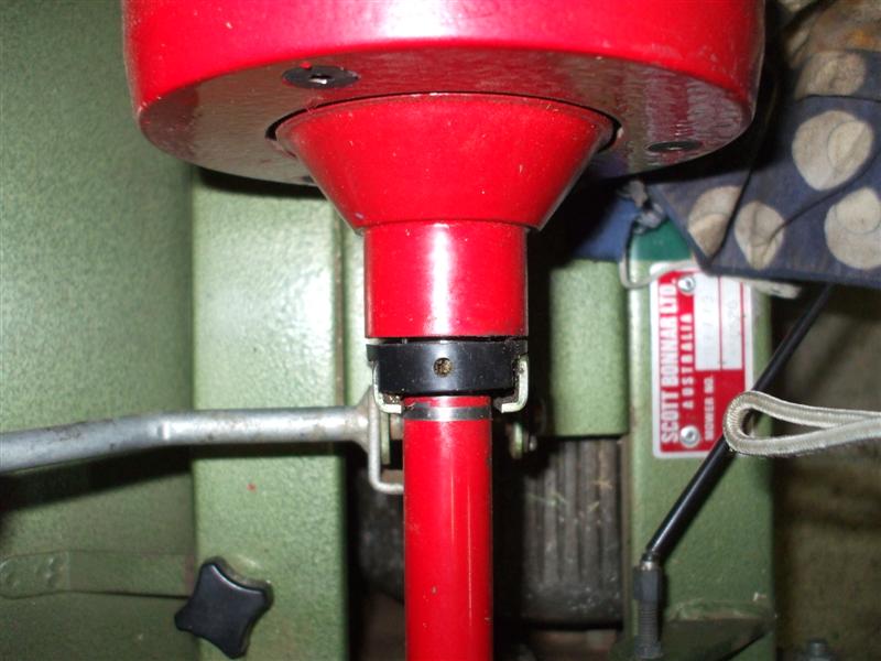

Hi Dunks, here is a pic of my machines clutch thrust pad, clutch cone and the clutch fork in the engaged position:
As you can see, there is a few thou clearance when the clutch is fully engaged....also the hole on the middle of the thrust pad is to place a few drops of oil to keep the shaft lubricated....also the clutch cone itself has an oil hole for the same reason.
Do not over-oil, just enough to keep the shaft wet.
And before you ask, no, the oil cannot, by the design of the clutch cone, ever reach the clutch lining. wink

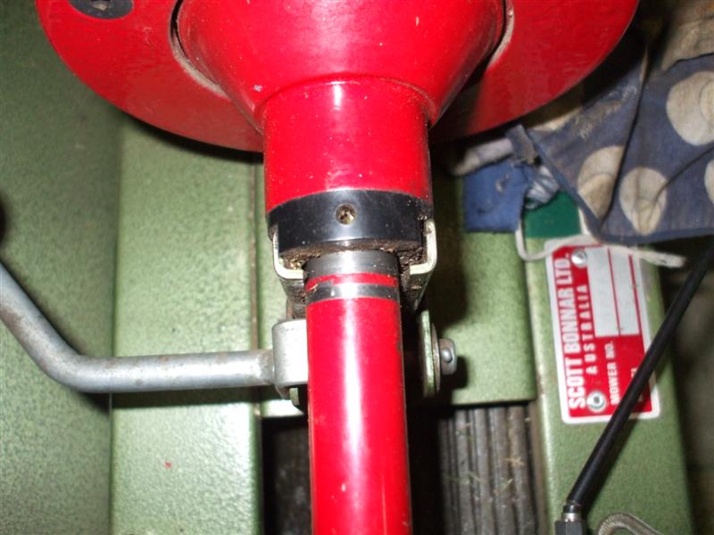

Here's a pic of the clutch disengaged....
As you know, the fine tuning is done by the screw and locknut on the clutch fork underneath the thrust pad. wink
