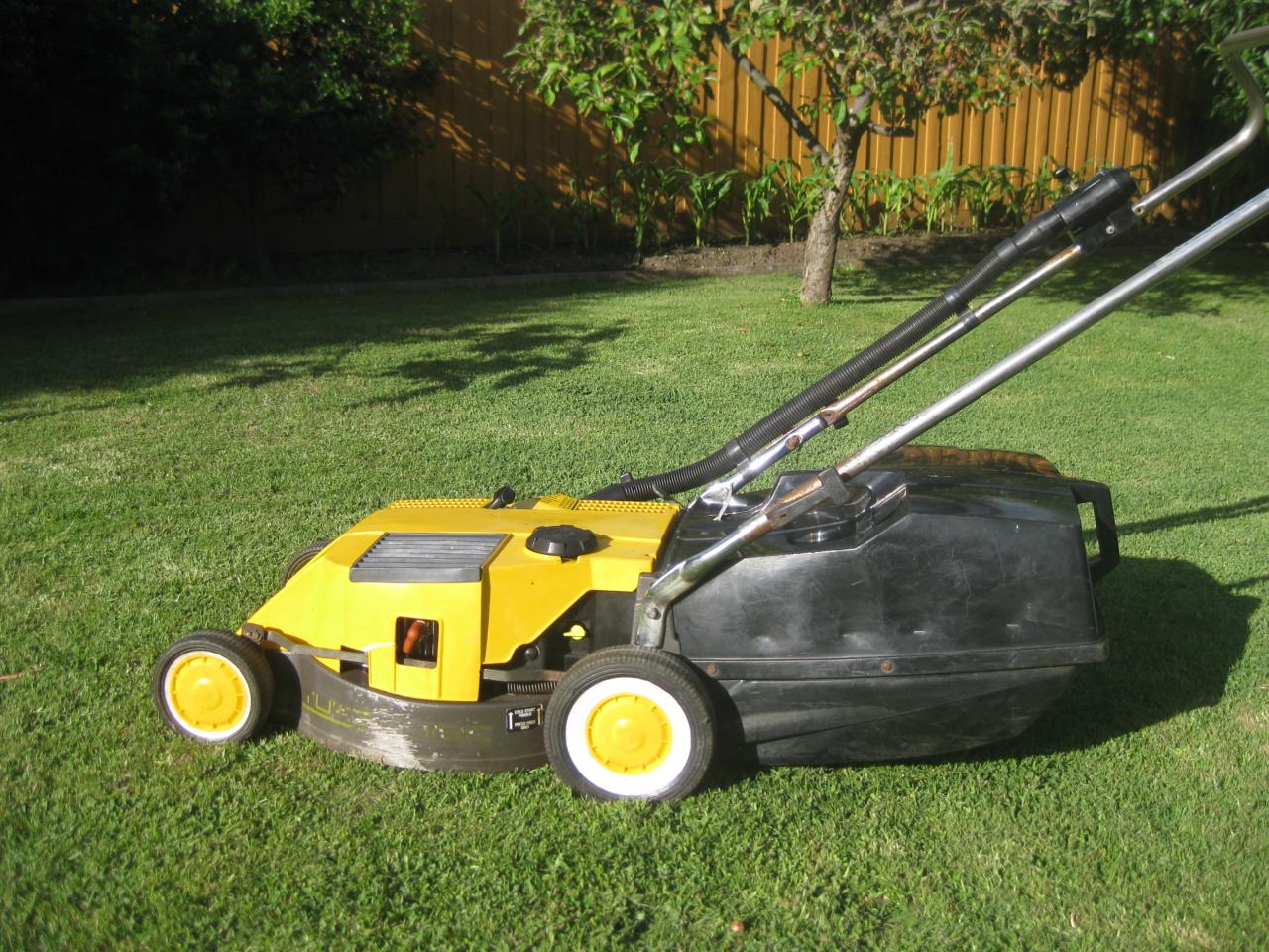

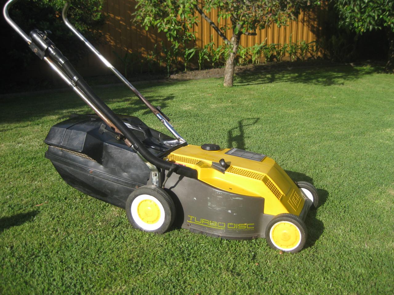

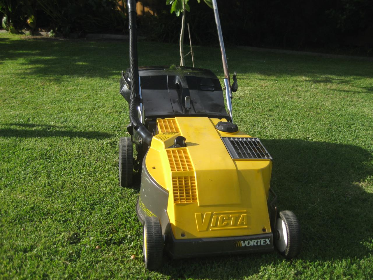

Well here are some pics of my Vortex , ended up fully reconditioning the motor since it had a fair amount of water in it , Gave it a polish up and with the help from you guys i did ended up putting a standard blade cutter deck on which works a treat , i was abit worried how it was going to perform by not useing a Turbo disc ,So far i have had one tank of fuel through it and it runs like a dream , now i am just wishing the grass would grow quicker so i could get the Vortex out more often ,
Thanks again guys for your help with this project ,
