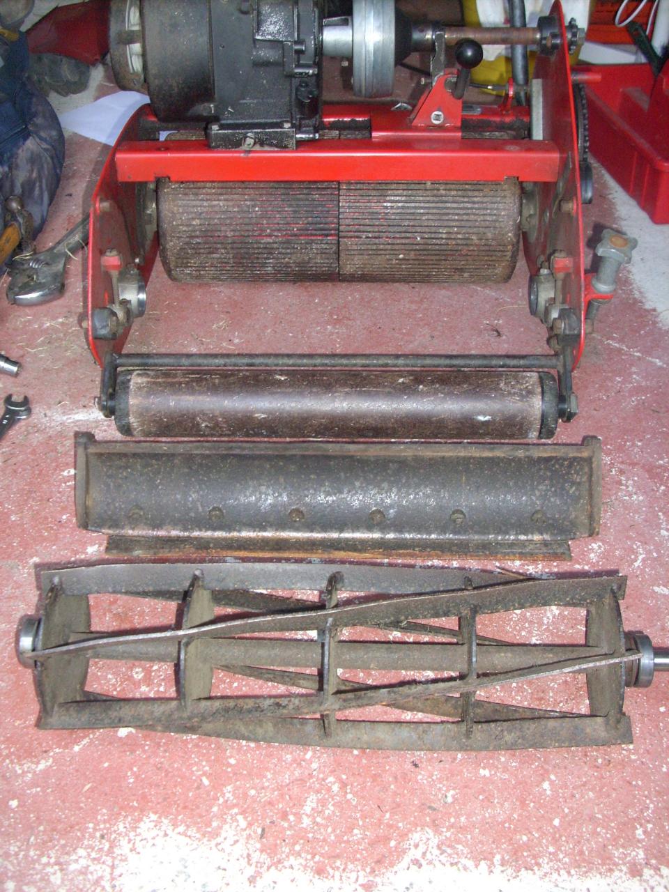

Can you report back when you have that all completed, and please post some pics.
We will go through removing the rear roller next. wink

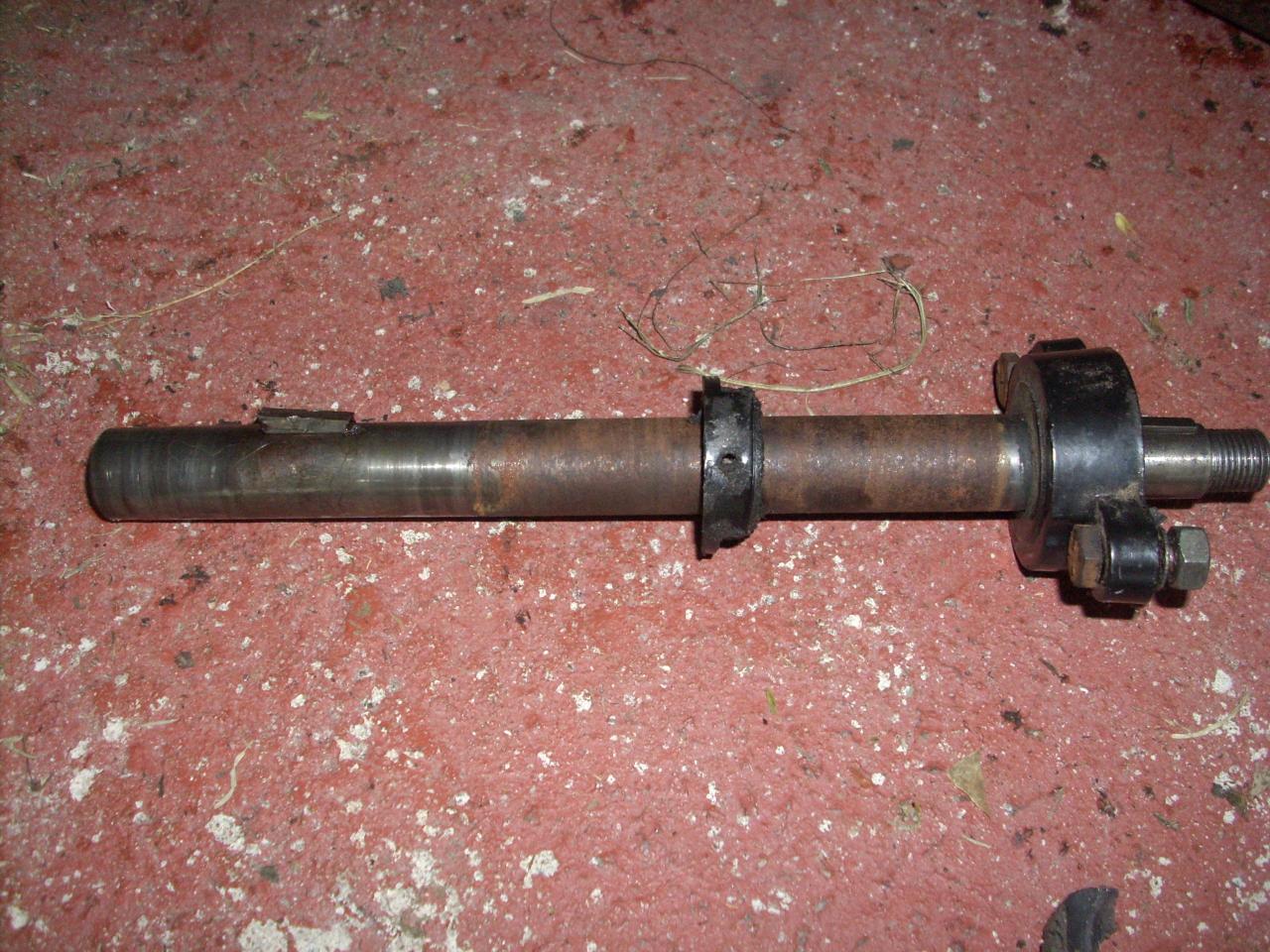

Got cracking this morning. Mission completed smile with little collateral damage (woodruff key in engine shaft got a little damaged when it was removed as it wouldn't play ball.) Could you please advise which part number it is as I noticed various ones on the Outdoor King online store.
All bearings seem OK as there is no grinding.

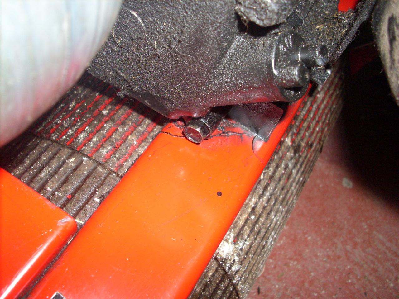

As you might notice the bearing holder on the chain side was not removed as the big bolt nearest the roller had sheared off and the end was flared so it remained in place. The previous owner must have down that. It was reluctant to remove it just in case I cant purchase a new identical bolt. Whats the best way of sourcing a new bolt? A local mower shop?

Hi Cloggy, We need to get a pic of that troublesome bolt and of the 'flared' "tenants improvement" of the bearing holder, as both those (left and right hand) have to come off with their adjustment screw.

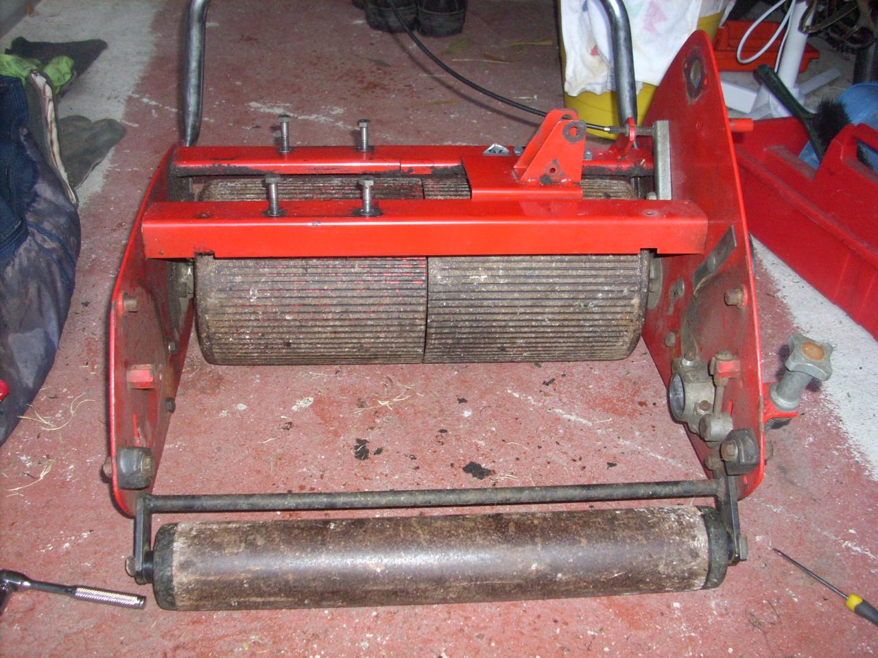

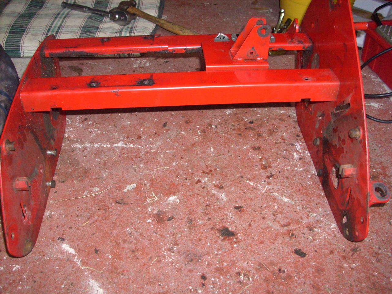

congrats You now have a bare chassis!
Can you please post some pics and report back when completed. wink

G'day Darrayl, Its all done. laugh
The bearing holder bolt required the full treatment: hack saw, angle grinder, heat and the grips but the end she gave way without breaking the bearing holder.

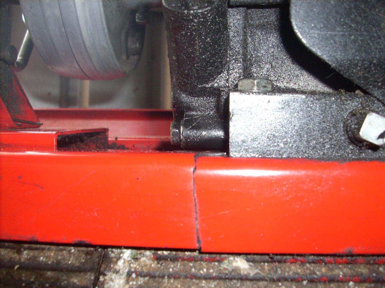

I think the next step is to clean everything up and have the frame welded. What are your thoughts?

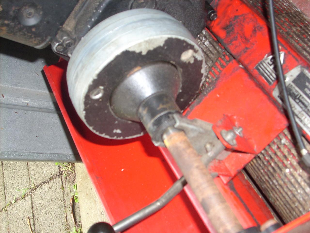

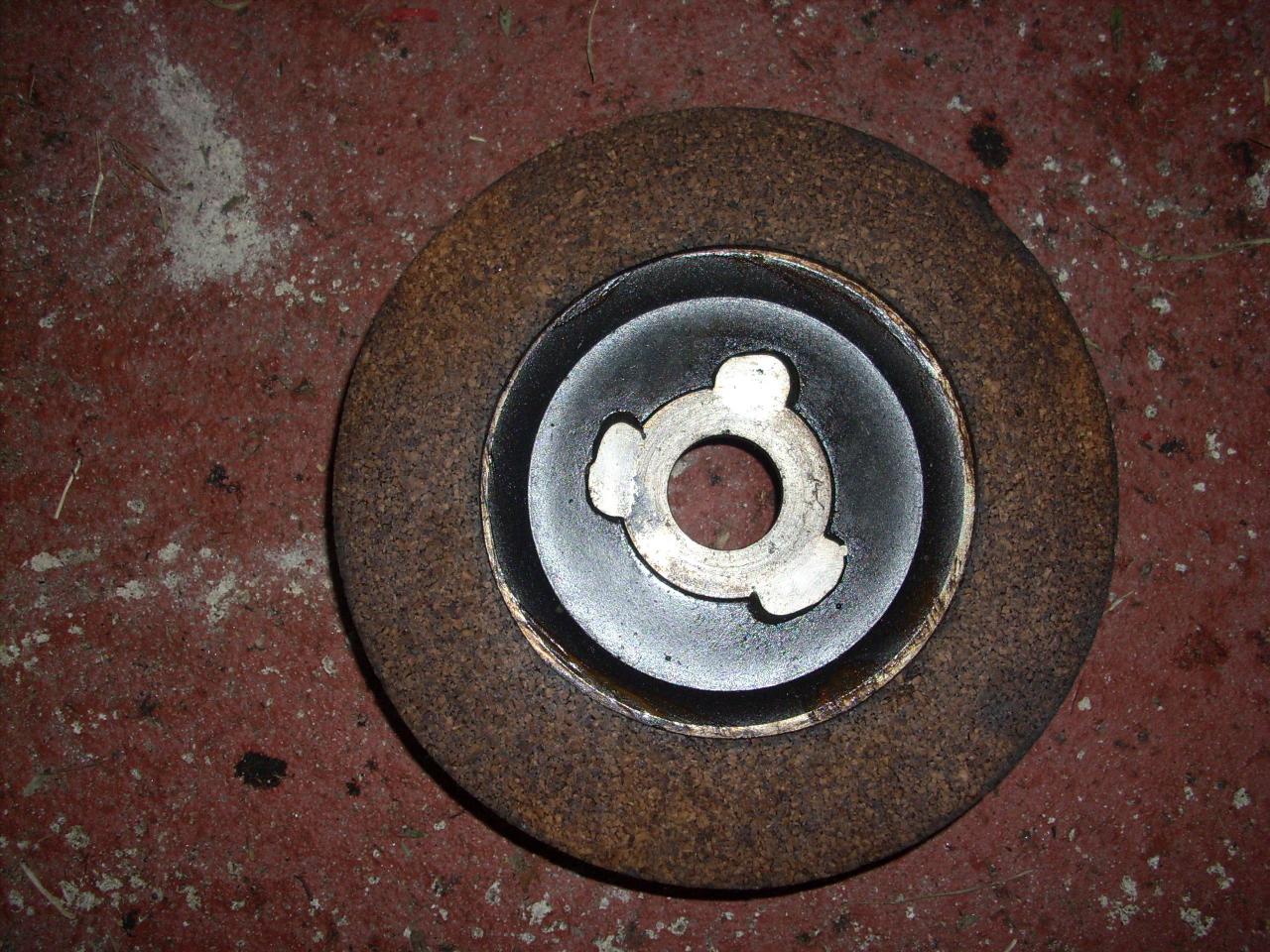

The cork in the clutch seems a git greasy. Will degreasing to the job or should I replace it.

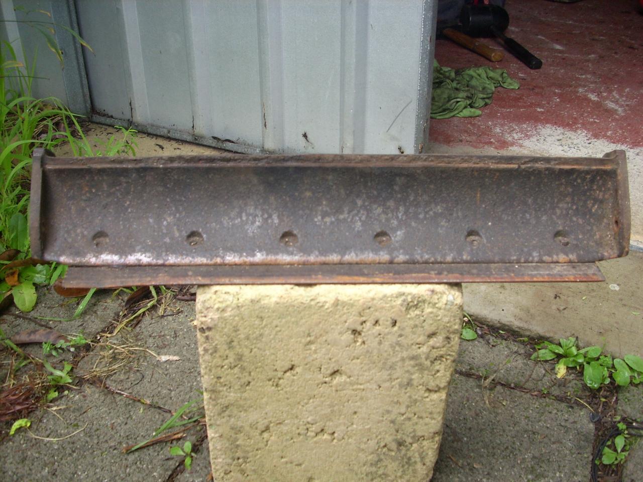

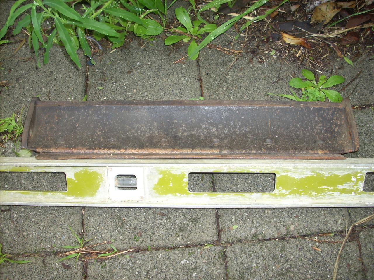

Hi Cloggy, Can you please post a photo of the cast iron soleplate.... I doubt we're on the same page here.... the soleplate carries the bedknife blade (held on by 6 screws). I would like to see it condition.
You should go to your local Bowling Club and find out who sharpens their reels and take your reel and soleplate (complete with the bedknife blade attached) and talk to the engineer. He can spin grind the reel and supply a new bed knife blade with new screws if necessary.
Please do not take it to your local mower shop....it will cost you more $$$ and they will probably send it out to be done anyway. wink
Hi Cloggy, the roller clutch cork should be replaced and so should the cork in the cutter clutch...(That could be the prob you are having with it)

for the bedknife blade see below. I have also downloaded the manuals and it went without a hitch. Been also to see the local bowling club and they pointed me in the right direction. Will take the reel etc down to the recommended shop and see what they say.
Hi Cloggy, Phew mate!! I thought that the soleplate (that's the cast iron holder that the bed-knife is attached to) was a gonner (as per your post) I can see now that all is OK, and all you need is a new bed-knife blade....That will be ground also when the reel has been ground.
Don't forget to sandblast then paint (or powder-coat) the reel prior to going to the engineer. Mask off with masking tape, the area where the bearing sits on the reel, prior to painting. wink
