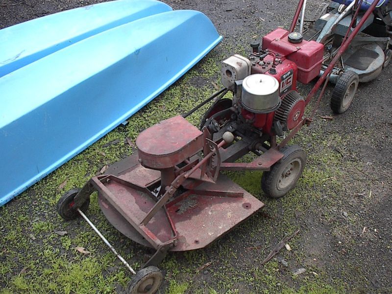

Just curious if anyone has any info on these mowers from Rover? I searched the net but could not find any info.
Particularly years of manufacture and did they have a handle mounted throttle etc?
I am curious as I guess this one may have had an engine change.
These are pics I found on the net.
1 member likes this: joat
Hi Aldot, there is a Illustrated Parts manual in the Rover manuals area....if you have subscribed to the area, go to "Repairs and Maintenance > Questions on Lawn Mower Frames > Lawnmower Parts List & Repair Manuals" scroll down the list of threads to the bottom; Rover Mowers parts Lists and Manuals > Rover Slasher 25.pdf.
If you have not yet subscribed, just click My Stuff in the toolbar above > Subscriptions. wink
The parts list says that they were fitted with an option of Briggs and Honda engines and both had a hand throttle on the upper left of the handle.
The date on the manual is December 2003.
Im not so sure that would have been newer than 85 or there abouts so im tipping the previous person that fitted that later model 8hp with electronic ignition did you a big favour.

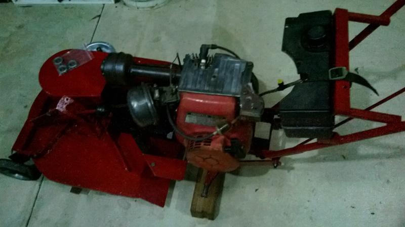

I still haven't used one of these yet, but I am in the process of refurbishing two of these.
Things I have done:
Stop rust using rust converter, I Galmet then paint with kill rust.
Replaced all bearings: top & bottom cutter, left and right drive shaft, wheel bearing & there is the cutter belt idler bearing.
The engine I removed and served as a separate task.
I have a part no. for the cutter belt (A01397 V- Belt)
If you take your old drive belt to a belt place they will match it up.
Maintenance is endless some things to keep your machine working:
Correct oil level, keep fuel tank free from grass water, remove grass spiralled around cutter disc, clean underneath, check belt alignment & tension.
Check to ensure everything that is meant to move does so freely.
Here are images of my 7hp Honda driven machine. Happy to help with any other questions you may have.

I chased down the drive belt size it is A33.
Tubes for tyres are 2.50-6
This slasher it all but finished now.
This slasher was one step away from being a garden ornament.
It is back in service now, just a few minor issues to sort out, like: muffler has had an extension welded on, has a few leaking holes to fill. Engine is not running smoothly, I suspect points or carb. Also have to make a latch up on the handles to lock the handle in or out of drive, cant remember.

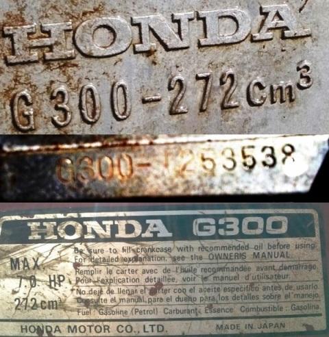

Hi Mark, if you post the Honda engine model, we can talk about what may be wrong with it. It appears to be a side valve model, but I couldn't guess which one.
Joined: Feb 2011
Posts: 510
Here are the numbers for this engine, have a few things on the go ATM, one of which is building a pizza oven. When I don't have concrete on my hands I will get back to it.
Well Mark, at least I have the workshop manual for that engine, so it isn't all bad. Early examples had breaker points, later ones had electronic ignition, by the way.

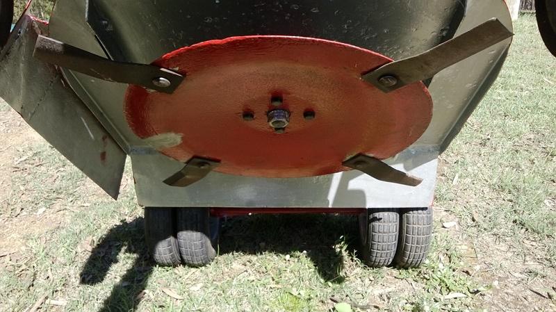

G'day guys. Just bought a rover sell propelled slasher in vey poor condition. Missing a few parts unfortunately
I was hoping you guys might be able to give me a rough idea of what size the original pulleys on the motor are as I have one aftermarket deck Pully 4" and I am unfortunately missing the drive Pully.
Currently has a 2hp Briggs and Stratton
Will post a photo shortly
Would also like to see a few more pictures of your slashers from different angle to help me see exactly what is missing
Cheers Will

I can get you some sizes and images Will. Cant do it right now.

That looks as if the cut would be close to 30" and it is self-propelled. Bearing in mind the kind of slashing usually expected from such a machine, I can't help feeling a 2 hp engine may fall a long way short of the requirement.

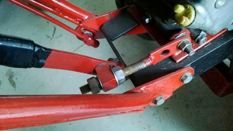

This handle when pulled down, pulls the engine back tightening the cutter belt.
SP drive handle & linkages.
Handle moves tyre treads to meet the drive dogs, which are always spinning when the engine is running.

Cheers that's a huge help. So is the engine on a sliding Chanel or are they oblong holes? My engine is hard mounted to an aftermarket plate. I have a suspician I will just have to make up some other form of tension system for the belt
